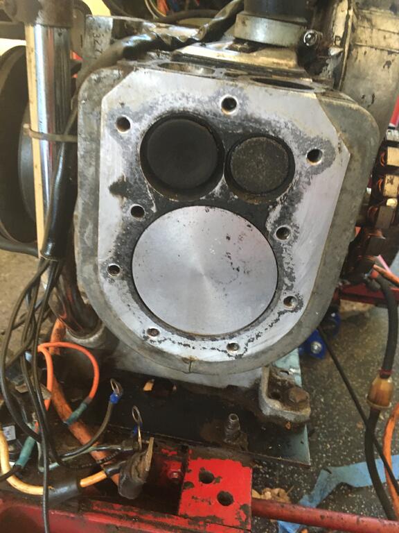

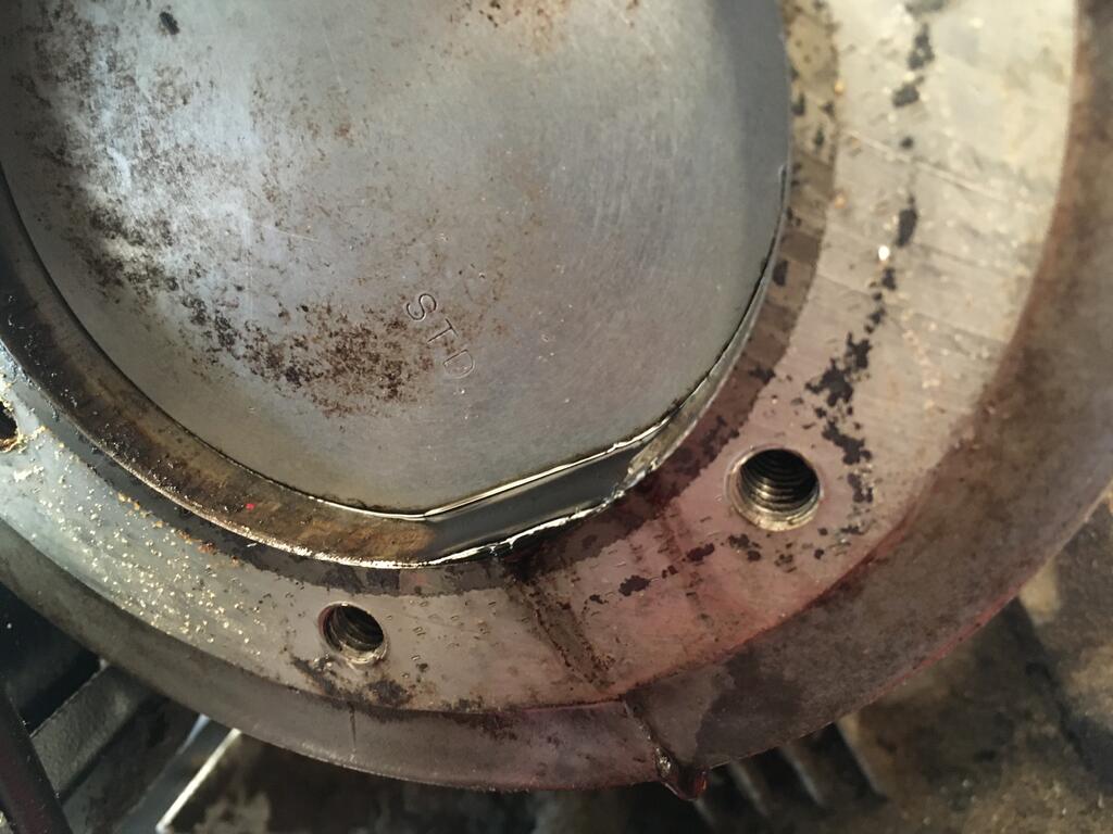

WheelHorse520H 710 #30 Posted May 20, 2021 Update: Piston heads are nice and clean, @lynnmor I do not have a plastic scraper, and O’Reilly, Autozone, and Napa all did not have one so I used engine degreaser and so elbow grease. They look better, but are not perfect. Do you recommend a certain gasket set? Andrew 1 Share this post Link to post Share on other sites
lynnmor 9,042 #31 Posted May 20, 2021 39 minutes ago, WheelHorse520H said: Update: Piston heads are nice and clean, @lynnmor I do not have a plastic scraper, and O’Reilly, Autozone, and Napa all did not have one so I used engine degreaser and so elbow grease. They look better, but are not perfect. Do you recommend a certain gasket set? Andrew Any scrap of plastic or an ice scraper will do. Think outside the box. Since I have had issues with the cheap gaskets, I use only genuine Onan gaskets. 1 1 Share this post Link to post Share on other sites
WheelHorse520H 710 #32 Posted May 20, 2021 51 minutes ago, lynnmor said: Any scrap of plastic or an ice scraper will do. Think outside the box. Since I have had issues with the cheap gaskets, I use only genuine Onan gaskets. Ice scraper......that’s genius! 1 Share this post Link to post Share on other sites
kpinnc 18,976 #33 Posted May 20, 2021 I would also use a shop vac to get out all the small debris that may slip in the gap between the top of the piston and cylinder wall above the rings. Do NOT use compressed air to clean it. 1 Share this post Link to post Share on other sites
WheelHorse520H 710 #34 Posted May 20, 2021 14 minutes ago, kpinnc said: Do NOT use compressed air to clean it. So I don’t blast all the gunk into the crankcase.....not sure I want to know how you learned that. 15 minutes ago, kpinnc said: I would also use a shop vac to get out all the small debris that may slip in the gap between the top of the piston and cylinder wall above the rings. Someone on this thread suggested some grease to seal the gap, but using engine degreaser, kind of defeated the purpose. 1 Share this post Link to post Share on other sites
kpinnc 18,976 #35 Posted May 20, 2021 (edited) 13 minutes ago, WheelHorse520H said: So I don’t blast all the gunk into the crankcase.....not sure I want to know how you learned that. I'll never tell... People say we learn from our mistakes, but if that were true I should be a genius... Btw- while you have the engine opened up, it's a good time to adjust the valves too. One less thing to worry about. Most gasket kits come with those gaskets anyway. Edited May 20, 2021 by kpinnc 1 Share this post Link to post Share on other sites

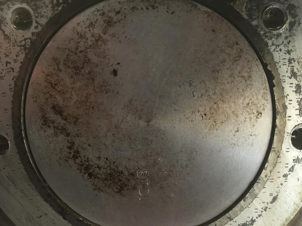

WheelHorse520H 710 #36 Posted June 1, 2021 Sorry, I have been busy, I was looking at gasket sets and I found one here but I am not sure what the valve covers are since I just thought it was the cylinder head. I will order the glass beads too. While I wait I will start the carb cleaning that I keep forgetting. Btw I forgot to post a picture of the cleaned piston heads, should I worry about those small black patches? Thanks for all the help. Andrew Share this post Link to post Share on other sites

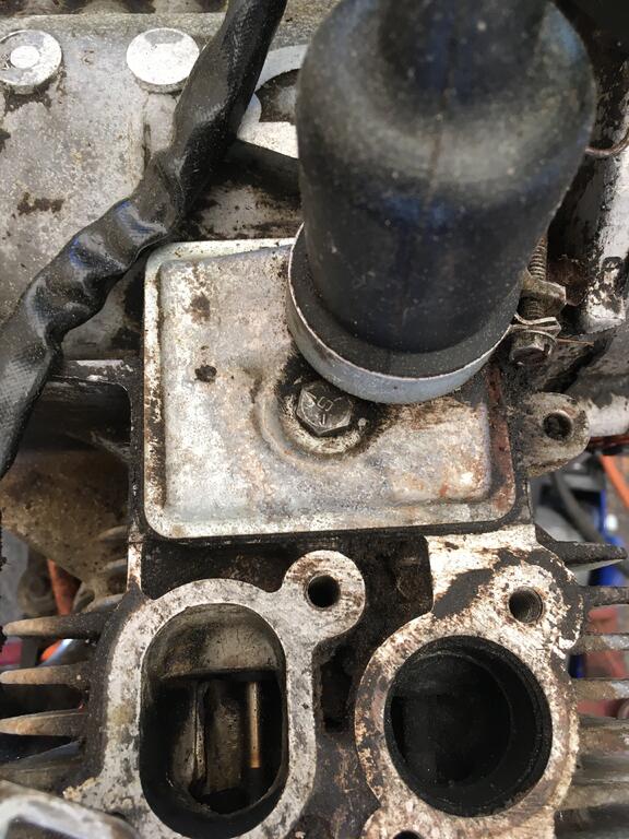

lynnmor 9,042 #40 Posted June 8, 2021 (edited) Look at your post #36, just above the top head bolt hole you will see a 7/16" head of a bolt. There is one on each side of the engine holding down the valve covers. Work clean and don't drop debris in as you remove them. There is holes to return the oil in the bottom of the uncovered area, stuff some paper towel in them to keep debris out. A shop vacuum is a good way to clean as you go. The Onan manual gives a method of getting the cam in the right location for adjustment. I simply rotate the engine crankshaft till a valve is pushing the spring to the maximum, then turn the crankshaft one more turn. A chalk mark on the rear pulley is good enough. Do this with each of the four valves making sure that you know which are intake and exhaust. If you find a valve that is way off, come back and maybe we can determine what is happening. Edited June 8, 2021 by lynnmor 1 Share this post Link to post Share on other sites
kpinnc 18,976 #41 Posted June 11, 2021 I'm thinking those black spots on top of the pistons are little dents from contacting carbon buildup at the top of the stroke. Probably nothing to be so much concerned about now- but also a reminder of the importance of the 500 hour head cleaning being necessary. ...Not preaching at all, more or less typing out loud. 1 Share this post Link to post Share on other sites

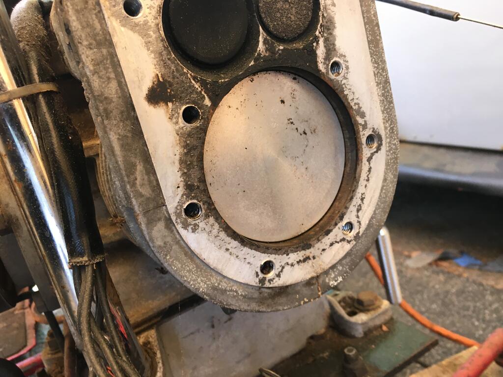

WheelHorse520H 710 #42 Posted June 11, 2021 5 hours ago, kpinnc said: ...Not preaching at all, more or less typing out loud. Preach away, I noticed yesterday the amount of carbon on the cylinder heads, more thank I like to have so that sounds like a project for tomorrow. That does make sense though. Also, I noticed a little oil dripping out of the back cylinder, I know that is usually not good. However, it is on a steep incline so would the oil be able to ooze over about a month of sitting on a steep incline. First pic is the front cyl second is the back. 1 Share this post Link to post Share on other sites
lynnmor 9,042 #43 Posted June 11, 2021 If the engine is lower on the end that is dripping, a little oil can be expected. It wouldn't be an Onan if it didn't puff a little white smoke on a cold start. 1 Share this post Link to post Share on other sites

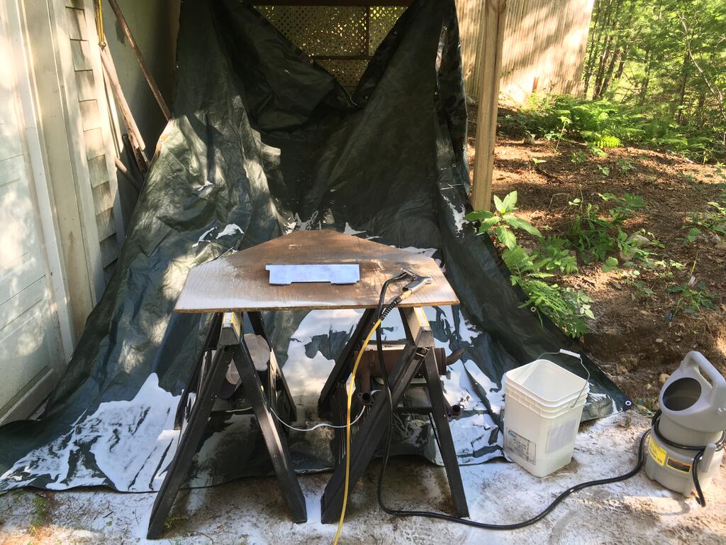

WheelHorse520H 710 #46 Posted June 17, 2021 I did some sand/glass blasting today, I used about 48 pounds of glass beads on just the shield that goes under the stainless steel grate and I am glad I set up a tarp to catch the extra beads because that created a mess where the tarp wasn’t able to reach. The black paint came right off but there is some large patches of rust that I just can’t seem to get off. Should I use a more coarse grit? I know I need to blast the muffler and the black head shield, is there anything else that I have to blast? Thanks, Andrew Share this post Link to post Share on other sites

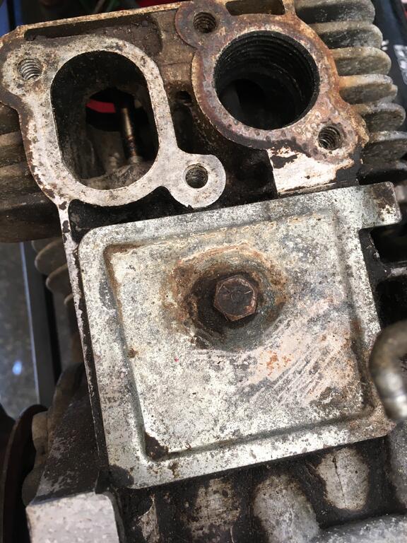

WheelHorse520H 710 #48 Posted June 18, 2021 On 6/8/2021 at 2:56 PM, lynnmor said: Look at your post #36, just above the top head bolt hole you will see a 7/16" head of a bolt. There is one on each side of the engine holding down the valve covers. Work clean and don't drop debris in as you remove them. There is holes to return the oil in the bottom of the uncovered area, stuff some paper towel in them to keep debris out. A shop vacuum is a good way to clean as you go. This bolt you describe is it next to the crankcase breather tube? 1 Share this post Link to post Share on other sites
lynnmor 9,042 #49 Posted June 18, 2021 11 minutes ago, WheelHorse520H said: This bolt you describe is it next to the crankcase breather tube? Of course. 2 Share this post Link to post Share on other sites
Handy Don 17,490 #50 Posted June 18, 2021 (edited) Give the area around the covers a good clean and vacuum before removing the covers (stick paper towels or clean rags in the intake and exhaust ports on both cylinders if you haven't already! Also, removing the breather tube by loosening the clamp will get it out of your way and lessen the chance of dropping debris in to the valve stem chamber. Seriously important to keep debris out of the engine. Edited June 18, 2021 by Handy Don 1 Share this post Link to post Share on other sites
