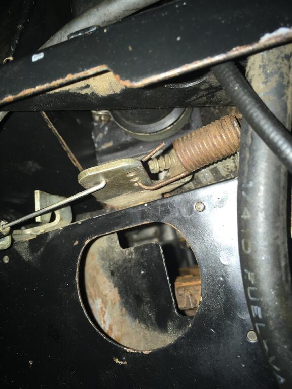

WheelHorse520H 710 #240 Posted August 23, 2021 On 8/21/2021 at 8:48 PM, lynnmor said: 1. Back off the idle adjustment screw located near the throttle cable. 2. Adjust the throttle stop screw for 1000 RPM. 3. Adjust idle mixture screw for the highest speed and best idle. 4. Readjust the throttle stop screw to 1000 RPM if necessary 5. Readjust the mixture if necessary. 6. Repeat steps 4 & 5 if necessary. 7. Adjust the idle adjustment screw near the throttle cable to 1200 to 1400 RPM. 8. Insure that the throttle cable pushes the lever to the stop, the speed should be 3600 RPM, bend the stop if needed. This is the screw and stop, correct? Also, I assume I do this with the engine running, correct? 1 Share this post Link to post Share on other sites
lynnmor 8,915 #241 Posted August 23, 2021 (edited) 8 minutes ago, WheelHorse520H said: This is the screw and stop, correct? Also, I assume I do this with the engine running, correct? That is the screw in step 1 & 7. The screw in step 2 is on the side of the carburetor. The idle mixture screw is accessed thru the muffler with a long screwdriver and a flashlight. Four letter words are optional. All of the screws are adjusted with the engine running. The throttle stop is visible on the left side of your photo. Edited August 23, 2021 by lynnmor Share this post Link to post Share on other sites
WheelHorse520H 710 #242 Posted August 23, 2021 1 minute ago, lynnmor said: That is the screw in step 1 & 7. Okay, thanks. 1 minute ago, lynnmor said: The screw in step 2 is on the side of the carburetor. Do you know where I get access to it from? 2 minutes ago, lynnmor said: The idle mixture screw is accessed thru the muffler with a long screwdriver and a flashlight. Four letter words are optional. This is the one with the plastic cap, right? 2 minutes ago, lynnmor said: All of the screws are adjusted with the engine running. I thought so, how else would I know the engine’s rpm? Got it. 3 minutes ago, lynnmor said: The stop stop is visible on the left side of your photo. The tab under the throttle cable. Thanks, Andrew 1 Share this post Link to post Share on other sites
lynnmor 8,915 #243 Posted August 23, 2021 Just now, WheelHorse520H said: Okay, thanks. Do you know where I get access to it from? Flashlight an screwdriver on rear side of carb. This is the one with the plastic cap, right? Yes. I thought so, how else would I know the engine’s rpm? Got it. The tab under the throttle cable. Yep. 2 Share this post Link to post Share on other sites
