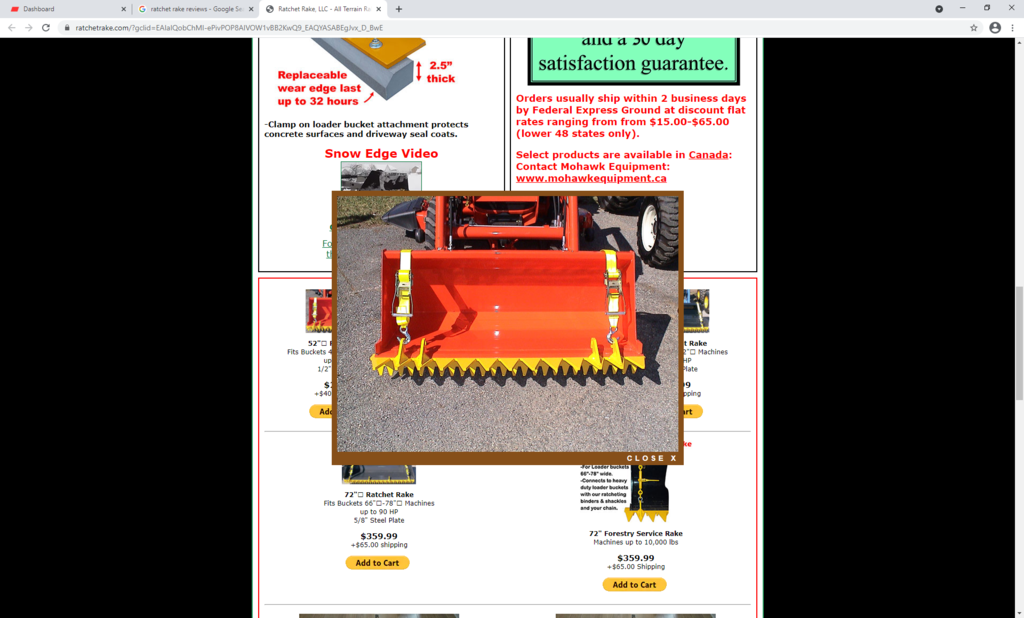

DET 111 #1 Posted April 21, 2021 Anybody ever use one of these? 1 1 Share this post Link to post Share on other sites
Pullstart 68,275 #2 Posted April 21, 2021 No, but it looks like fun! 1 1 Share this post Link to post Share on other sites
DET 111 #3 Posted April 21, 2021 That’s what I was thinking 1 Share this post Link to post Share on other sites
ebinmaine 74,649 #4 Posted April 21, 2021 What's that sucker supposed to do? Other than terrorize neighborhood children I mean. 1 4 Share this post Link to post Share on other sites
elcamino/wheelhorse 9,362 #5 Posted April 21, 2021 @ebinmaine remove @pullstarttoes when he uses it with his flip flops. 7 Share this post Link to post Share on other sites
ebinmaine 74,649 #6 Posted April 21, 2021 6 minutes ago, elcamino/wheelhorse said: @ebinmaine remove @pullstarttoes when he uses it with his flip flops. Oh oh oh oh oh. Okay I got it. Thanks for clearing that up. Share this post Link to post Share on other sites
DET 111 #7 Posted April 21, 2021 They show using it to rake and clear land with it on their web site. I didn’t see anything about toenails but I guess you could get creative. 5 Share this post Link to post Share on other sites
DennisThornton 4,771 #8 Posted April 22, 2021 No but I sure looked hard at them! Ended up with a regular tooth bar. Really heavy duty and an absolute must for serious moving of packed or stoney dirt! Handy to push or back drag out rocks, limbs and debris. Certainly adds to the effective use of a plain straight bucket! A tooth bar can tear into a rockwall where a flat front edge bucket can't begin to do anything but bump into it! Logs have something to rest on too. You lose the smooth back scraping with the front lip so it's hand to be able to unbolt it! I try to groups tasks for tooth bar on and then tooth bar off. 1 1 Share this post Link to post Share on other sites

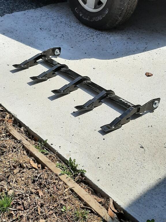

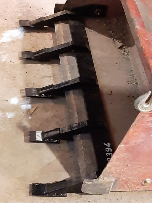

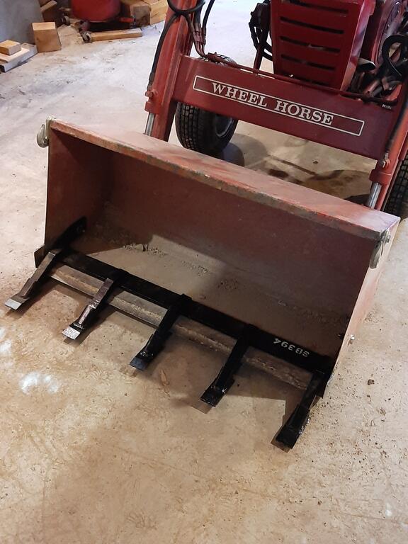

roadapples 6,985 #9 Posted April 22, 2021 Just got a tooth bar for mine 2 weeks ago 1 Share this post Link to post Share on other sites
DennisThornton 4,771 #10 Posted April 22, 2021 11 hours ago, roadapples said: Just got a tooth bar for mine 2 weeks ago Turns the bucket into a very different tool! 1 Share this post Link to post Share on other sites
pfrederi 18,987 #11 Posted April 22, 2021 12 hours ago, roadapples said: Just got a tooth bar for mine 2 weeks ago Is it a 48" tooth bar?? Where did you get it? The ratchet rake smallest is 52" My D200 FEL is only 48.... 1 Share this post Link to post Share on other sites
roadapples 6,985 #12 Posted April 22, 2021 1 hour ago, pfrederi said: Is it a 48" tooth bar?? Where did you get it? The ratchet rake smallest is 52" My D200 FEL is only 48.... My bucket is 40" overall. Tooth bar is 39 1/2". This was not special order. Ordered it Sunday night (Easter) and had it Tuesday afternoon. www.neatfarms.com overkill for wheel horse, but you shouldn't hurt it. I planned on making one but didn't think I'd save much at $218.... 1 1 1 Share this post Link to post Share on other sites
