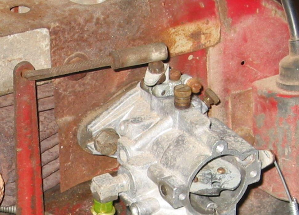

tunahead72 2,633 #9 Posted April 16, 2021 4 hours ago, ebinmaine said: I've had carbs that the top linkage came off so I didn't need to remove the butterfly. Much easier if possible. Hey Eric, I've seen that mentioned here somewhere, but I can't picture what it looks like exactly. Can you post a photo or two when you get a chance? Share this post Link to post Share on other sites
pfrederi 20,657 #10 Posted April 16, 2021 If you have this clamp on throttle linkage the job is super easy... Loosen the screw clamping the linkage to the butterfly shaft and it pulls up and off 1 1 Share this post Link to post Share on other sites
ebinmaine 79,116 #11 Posted April 16, 2021 3 hours ago, tunahead72 said: Hey Eric, I've seen that mentioned here somewhere, but I can't picture what it looks like exactly. Can you post a photo or two when you get a chance? @pfrederi Thanks for the picture Paul. That's exactly what I was talking about right there. 1 Share this post Link to post Share on other sites
