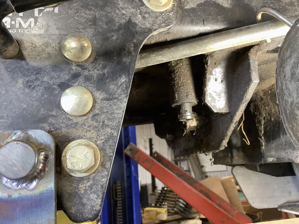

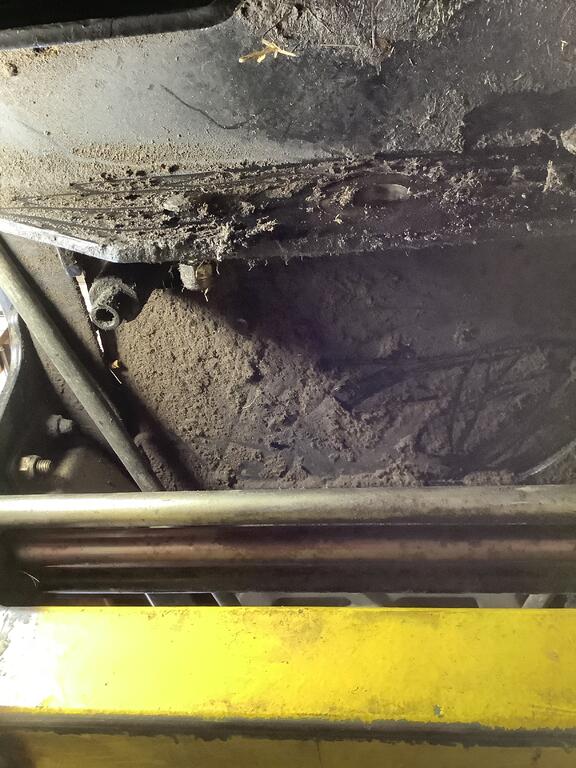

Pullstart 71,516 #1 Posted April 13, 2021 Can anyone identify this drain system? @squonk? Is there a NAPA # for it? The oil everywhere under this constituted to a loose oil filter. It’s the 520Xi, but I doubt it is factory... Share this post Link to post Share on other sites
squonk 48,322 #2 Posted April 13, 2021 I have seen those before Kevin but never found out who makes it or where they came from. 1 Share this post Link to post Share on other sites

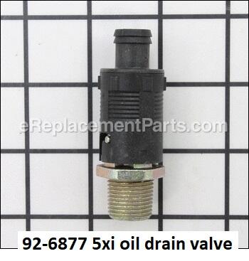

Jake Kuhn 1,600 #6 Posted April 14, 2021 Stens 125-508 is that style, just make sure the threads are the same. 2 1 Share this post Link to post Share on other sites
Pullstart 71,516 #7 Posted April 14, 2021 1 minute ago, Jake Kuhn said: Stens 125-508 is that style, just make sure the threads are the same. Hi Jake! Lot’s changed since we last said hello! Portage, I think? Share this post Link to post Share on other sites
gwest_ca-(File Mod) 12,532 #8 Posted April 14, 2021 Drain valve looks original. 1 Share this post Link to post Share on other sites
Pullstart 71,516 #9 Posted April 14, 2021 27 minutes ago, gwest_ca said: Drain valve looks original. wow, cool! Share this post Link to post Share on other sites

Jeff-C175 7,211 #14 Posted April 15, 2021 (edited) That fitting accepts a piece of 1/2" plastic tubing also. Comes in handy on some machines. I've got them on a couple machines. 3/8" pipe thread, Edited April 15, 2021 by Jeff-C175 2 Share this post Link to post Share on other sites
shallowwatersailor 3,222 #15 Posted April 17, 2021 The Kohler Command Twin used in the 518xi, 520xi, and 522xi use that drain as well. 1 Share this post Link to post Share on other sites
