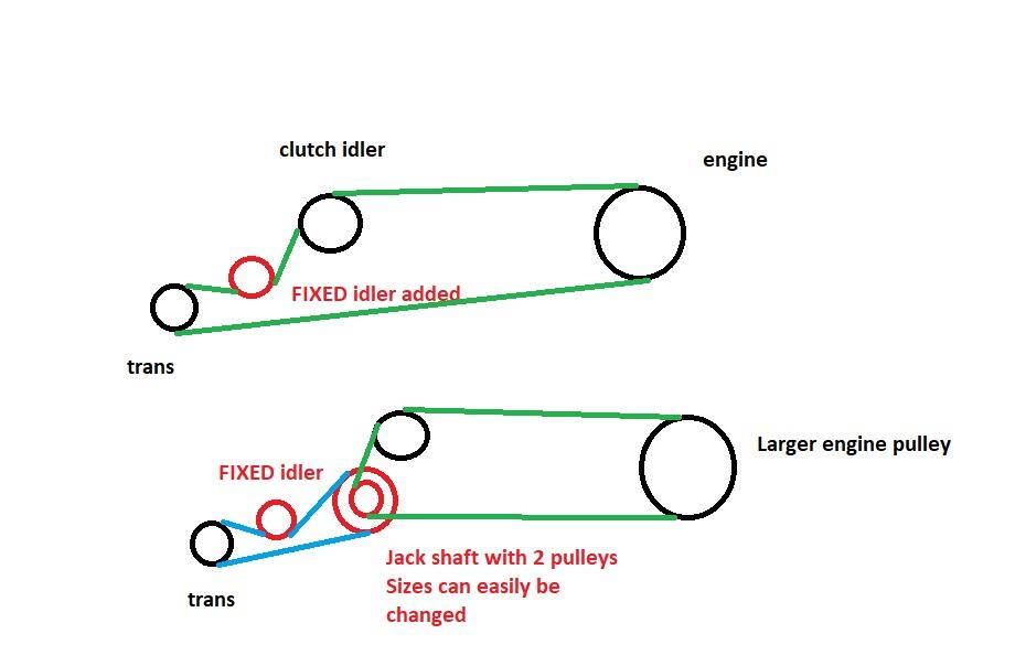

wallfish 19,323 #7 Posted April 14, 2021 Speed can be increased by pulley sizes and or the addition of a jackshaft with pulleys . If you make the trans pulley too small it will tend to slip 1 Share this post Link to post Share on other sites

wallfish 19,323 #11 Posted April 14, 2021 5 hours ago, Snoopy11 said: Wallfish, please excuse my ignorance... but what do you mean by pulley sizes... bigger or smaller? And... must these be fabricated... or can they be purchased anywhere? Pulleys, bearings, shaft, belts etc etc etc can be purchased here. https://www.surpluscenter.com/ A larger diameter V belt pulley on the engine with a smaller diameter pulley on the trans input will increase the speed. To keep pulleys within a reasonable diameter to work with and fit on the tractor, a jackshaft in between can be used to adjust pulley sizes and increase speed. Something like this. The fixed idler helps keep the belt from slipping on a smaller trans pulley by holding more belt surface to the pulley groove. There are lots of calculators online you can use to work out diameter of pulleys and RPM I don't know what spindles and tie rods you have on your tractor but if you do speed it up make sure the front end parts are up to par. 1 Share this post Link to post Share on other sites
