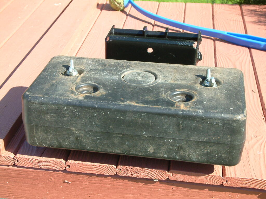

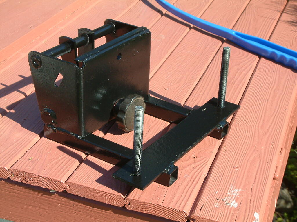

Stormin 9,988 #11 Posted April 10, 2021 (edited) I've made this for the Black Horse. Can't remember the weight, but I can't throw it around. Just something to think about. Don't forget you may need to open the bonnet/hood. Edited April 10, 2021 by Stormin 2 3 Share this post Link to post Share on other sites

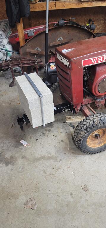

haydendavid380 759 #18 Posted April 16, 2021 (edited) They are good for quite a bit. I have a bunch of concrete on a extended shaft on mine and haven't had any problems. That's probably 120-130lbs actual weight. Even more force than that with the shaft acting like a lever. Edited April 16, 2021 by haydendavid380 1 Share this post Link to post Share on other sites
