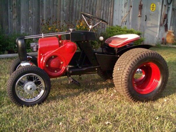

Achto 32,892 #2 Posted April 9, 2021 Here is one idea for you Eric. 2 3 6 Share this post Link to post Share on other sites
ebinmaine 81,048 #3 Posted April 9, 2021 Just now, Achto said: Here is one Geeeez ain't that some cute!! 1 Share this post Link to post Share on other sites
seuadr 490 #4 Posted April 9, 2021 that thing is sahweeeeet! Share this post Link to post Share on other sites
305 381 #5 Posted April 9, 2021 yes , radiator support rods 4 1 Share this post Link to post Share on other sites

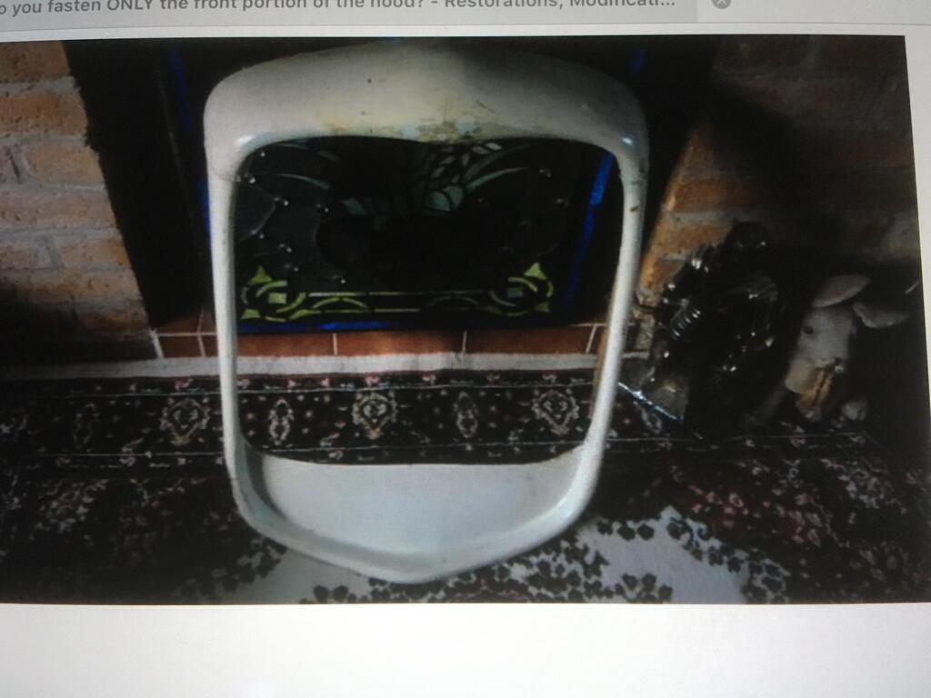

ebinmaine 81,048 #8 Posted April 9, 2021 @ranger Whatcha got there? Share this post Link to post Share on other sites
ranger 1,862 #9 Posted April 9, 2021 (edited) 8 minutes ago, ebinmaine said: @ranger Whatcha got there? Apparently it’s a cut down glass fibre “32” Ford grill shell. A friend gave it to me early eighties for a model “A” pickup truck hot rod I was building at the time. Edited April 9, 2021 by ranger 1 1 Share this post Link to post Share on other sites
