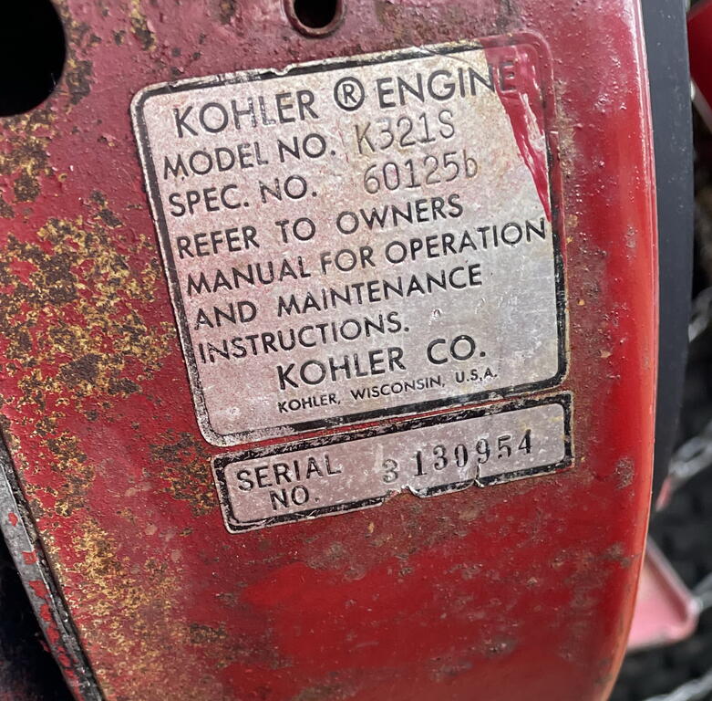

gwest_ca-(File Mod) 12,489 #3 Posted April 8, 2021 What is the model number of the tractor off the ID plate and the spec number off the engine? GT-14's don't all use the same engine. Garry 1 Share this post Link to post Share on other sites
Machria 78 #4 Posted April 8, 2021 First, I just edited my post above, I now know I have the "Breakless" ignition system per the service manual which I just downloaded and had a look and compared to mine. Squonk, I do not have a screen in the bottom of the tank as my nipple recently broke off, so I replaced the nipple with the tank insert available on ebay (rubber grommet and metal tube that sticks thru it. But I do have a inline fuel filter between the tank and the carb intake, which is clean and does not seem to be the issue. I can blow thru it not problem (tastes good too! ). However, I just read another post here in the other "wont start" thread that stated these fuel pumps like to push, but not pull to much. And I did add a fairly long length of fuel line to my setup to make it easier to deal with. I'm going to shorten that right now and see if it matters.... And by the way, I also suspect a fuel problem.... plug still looks a bit dry to me.... Share this post Link to post Share on other sites
Machria 78 #5 Posted April 8, 2021 6 minutes ago, gwest_ca said: What is the model number of the tractor off the ID plate and the spec number off the engine? GT-14's don't all use the same engine. Garry Share this post Link to post Share on other sites

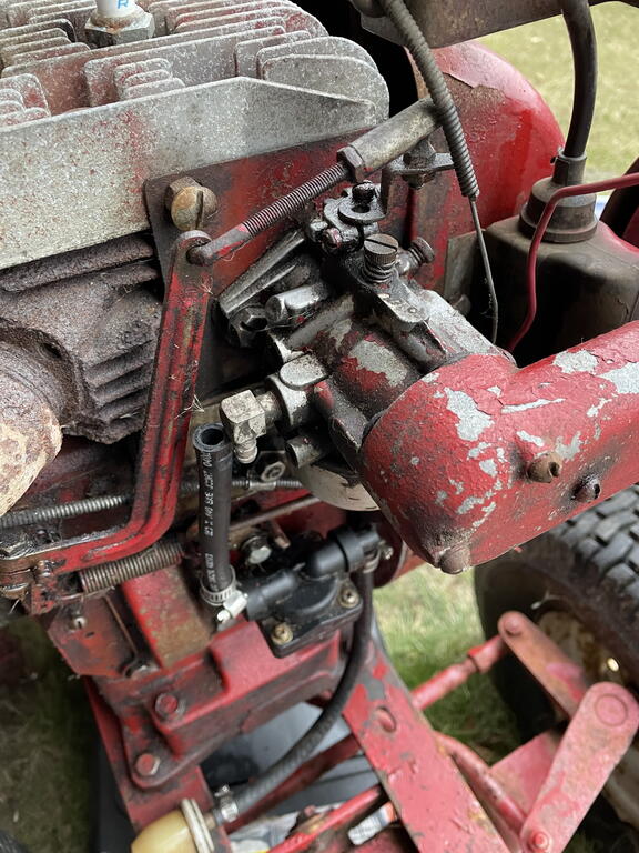

Machria 78 #6 Posted April 8, 2021 This is the carb and fuel pump (cheap plastic ebay one) before sending out to rebuild.. I've since put the orig pump back on. Share this post Link to post Share on other sites

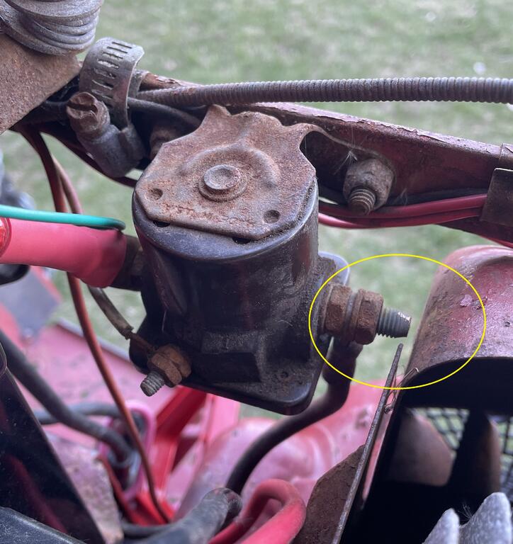

Machria 78 #8 Posted April 8, 2021 (edited) Update, shortened fuel lines back to about the orig. one, same result. BUT, while turning over noticed some sparking from the terminal bolt on the right side (the front of) this thing, which was almost touching the cover to the right. I pulled it away about 1/8" from the cover and the sparking stopped. But it still would not start afterwards. I wonder if that being shorted out blew something up? Anything I should check? Edited April 8, 2021 by Machria Share this post Link to post Share on other sites

Machria 78 #12 Posted April 8, 2021 Is that last picture the starter solenoid? 1 Share this post Link to post Share on other sites
953 nut 69,556 #13 Posted April 8, 2021 6 minutes ago, Machria said: Not sure what you mean? If I disconnect the fuel line, how would it pump up from the tank?? In any case, I removed the bowl (suggested by the guy who did the rebuild), float seems fine and not stuck. With the tank connected to the rebuilt fuel pump inlet and the outlet hose as shown in your picture will the fuel pump pump fuel as the engine is turned over? 1 Share this post Link to post Share on other sites
Machria 78 #14 Posted April 8, 2021 3 minutes ago, 953 nut said: With the tank connected to the rebuilt fuel pump inlet and the outlet hose as shown in your picture will the fuel pump pump fuel as the engine is turned over? Got it, thanks. I will try that tomorrow. Silly me, sounds like and easy way to test your getting fuel to the fuel pump, and the pump is pumping! Seems so easy when sitting at the computer, but I can never think of this stuff when I have fuel spilling all over me! 3 1 Share this post Link to post Share on other sites
WHX?? 58,225 #15 Posted April 8, 2021 36 minutes ago, Machria said: Is that last picture the starter solenoid? Yes and probaly not the problem but good catch on the sparking you do not want that to happen. That's what I was getting at Richard .... does the pump move fuel. Another thing Mach does it fire when you try what we call hand feeding? That is by a shot of bang juice down the carb? Just for grins try a new spark plug... cheap and easy. BTW next time you need a carb or pump rebuild consider sending it to one of us. I know @ebinmaine likes and does a mean carb and I can handle a pump. Bet we'd both do it for parts kit, shipping and a beverage. 4 Share this post Link to post Share on other sites

R Scheer 524 #18 Posted April 9, 2021 In that picture of your starter solenoid there is a metal hose clamp that appears to have a throttle or choke cable running through it as well as electrical wires. If those are wires I'd check them in case the insulation is damaged. 1 Share this post Link to post Share on other sites

Machria 78 #21 Posted April 9, 2021 15 hours ago, R Scheer said: In that picture of your starter solenoid there is a metal hose clamp that appears to have a throttle or choke cable running through it as well as electrical wires. If those are wires I'd check them in case the insulation is damaged. That wire isn't really in the hose clamp, it is just tucked behind the loose end of the hose clamp. I double checked anyway it was not damaged or nicked and it's fine. 11 hours ago, Tuneup said: So, in this thread, seems like you addressed everything but the plug. It's got spark, goes bang when you squirt fuel up top, hanging a tank above the carb has no effect - plug still dry. Rebuilt carb and pump. I was going to suggest hanging a tank but you took care of that and still a dry plug? Makes no sense unless that sparking at the solenoid is playing games with the electronic coil - which is definitely at the end of its life. It may spark in the air but not in the cylinder under mild ACR compression. Might be time to go with the standard coil and points firing. It's a good thing to do , is a cheap swap, and considering the age of the tractor - won't be wasted. Well, after testing the fuel pump, and seeing fuel spurt nicely with the hose disconnected, I ruled out that. So I removed the little inline fuel filter, just to be sure that wasn't causing more suction issue. I'll pick up a new one. And THEN, I put in another brand new spark plug (I had changed the plug last year when it first wouldn't start). Low and behold, it started up on the first crank!! SHAKING HEAD HERE!! It was running like sheet, but I was prepared for that since the carb just came back from re-build. I followed the service manual instructions to adjust the carb starting with idle, then at fast. Got it pretty good but I'm sure somebody who knows what they are doing could do it better. Anyway, put it all back together (which I'm pretty good at, at this point!), and started her up. After 2 minutes, while I was putting the tools away, it just shut down as if somebody had turned the key off. Bingo, it would not re-start again! So I put more fuel in to be sure the tank wasn't to low, no go. After looking around, I see the wires connected to the bottom of the coil (the ignition trigger wire and ignition switch) disconnected. I must have bumped them loose when putting it back together and they fell off when it was running! wheeeeeew!!! Plugged back in, started up and took her for a ride. Now I can get back to work about moving some firewood around my yard. This thing is my mule and greatly needed, it's also my snow blower which was missed this past winter. THANKS FOR ALL THE HELP GUYS! A bit of a learning experience for me. Here she is running fast, and then idling.... 4 Share this post Link to post Share on other sites
