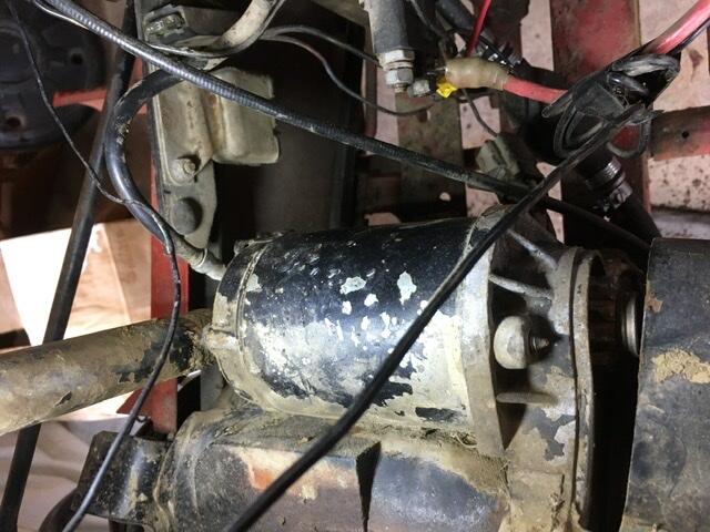

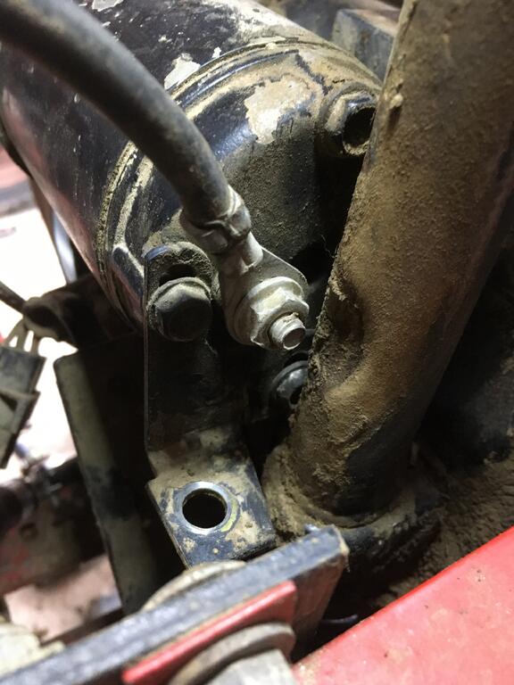

AHS 1,674 #1 Posted April 5, 2021 Ok, so many questions! Do I have to remove the oil tube? I think I do. Is it just connected by the three screws on bottom? The starter; I have removed the two 9/16” head on bottom, the 7/16 head on back... is that all? I have a used Kohler starter, one that does have the bolt hole in the correct place.. I guess I will have to get another one. The key is a KOHLER starter... not a reman. Share this post Link to post Share on other sites

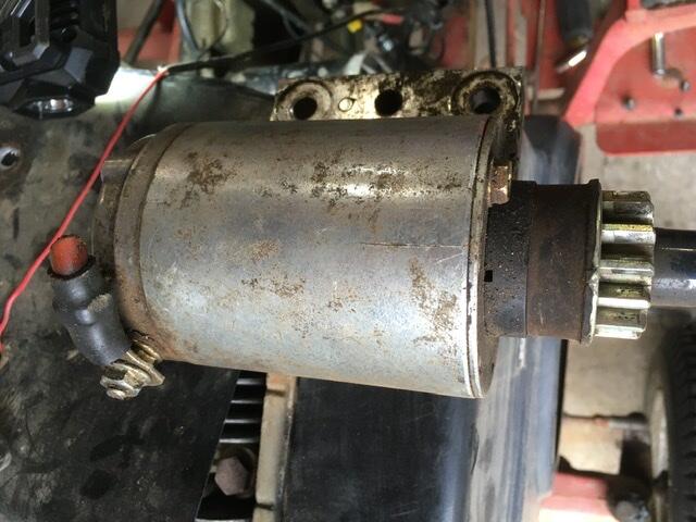

AHS 1,674 #4 Posted April 5, 2021 1 minute ago, ebinmaine said: I don't have any Magnum engine so I can't really help you with the removal of that one. As far as getting a durable replacement I'm much more prone to rebuilding an OE Kohler starter. So here's the question, what's wrong with that one? Is it an original one? It has an awful loud noise when the key is turned. And it needs a rebuild, a new starter gear and spring. I may just have that one rebuilt. 1 Share this post Link to post Share on other sites

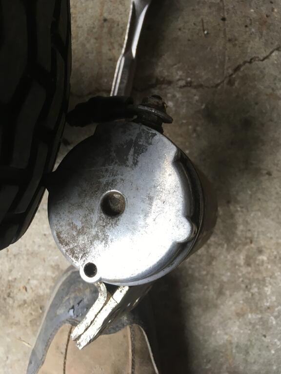

AHS 1,674 #10 Posted April 5, 2021 Well, the brushes are burnt, one coming apart. And the magnets got one piece that is cracked. So time to buy another one. 1 1 Share this post Link to post Share on other sites

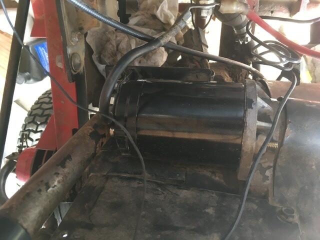

AHS 1,674 #12 Posted April 7, 2021 I know some of you may have bouts with DB electrical, but that’s who I got my starter from. With a 1 year warranty and $61.00 from DB...and a Kohler starter for $275.00. Hopefully that is the last one I will have to put in there!! I doubt it! The starter bolted right up, and is a lot quieter than the last one!😀 2 Share this post Link to post Share on other sites
