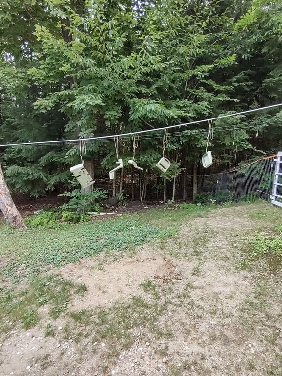

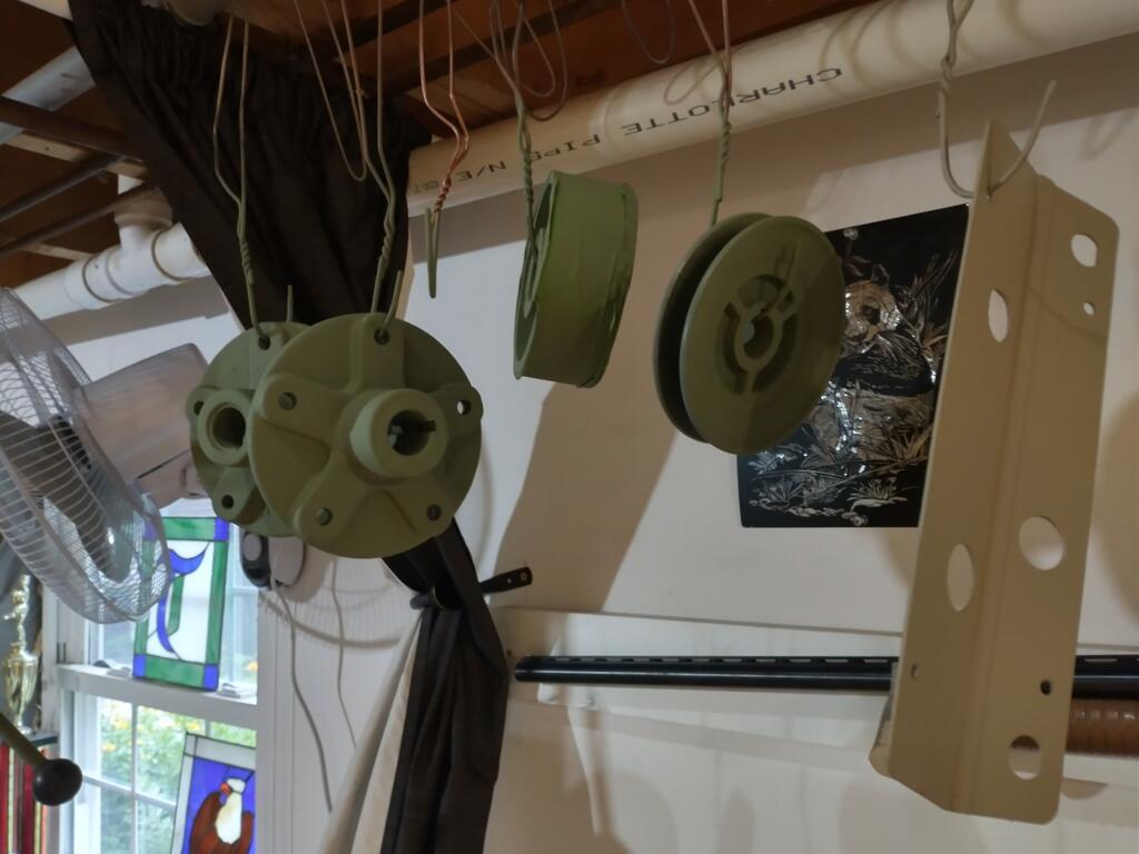

kpinnc 19,015 #51 Posted June 16, 2021 I love seeing parts hangin on the old clothes line setup. ...Maybe my wife will let me decorate the Christmas tree with red parts next year! 1 2 Share this post Link to post Share on other sites
ebinmaine 80,975 #52 Posted June 16, 2021 4 hours ago, kpinnc said: I love seeing parts hangin on the old clothes line setup. ...Maybe my wife will let me decorate the Christmas tree with red parts next year! I don't know why not.... You tell her some crazy Bear 🐻 in Maine said it was ok.... Share this post Link to post Share on other sites
kpinnc 19,015 #53 Posted June 16, 2021 7 hours ago, ebinmaine said: You tell her some crazy Bear 🐻 in Maine said it was ok.. Will do! 1 Share this post Link to post Share on other sites

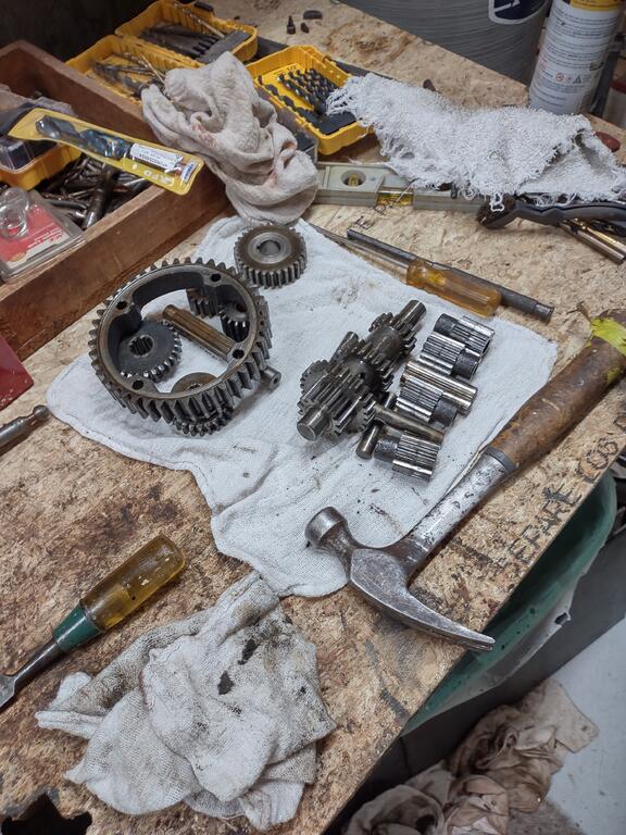

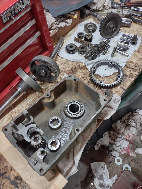

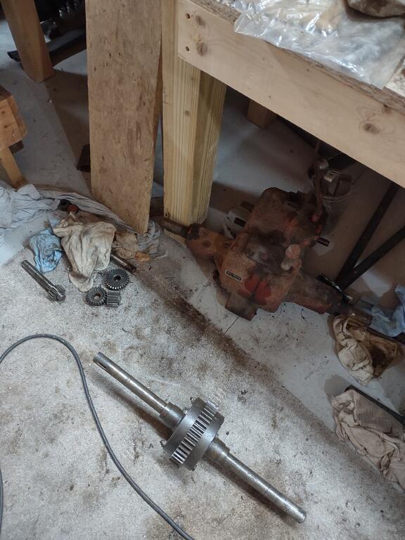

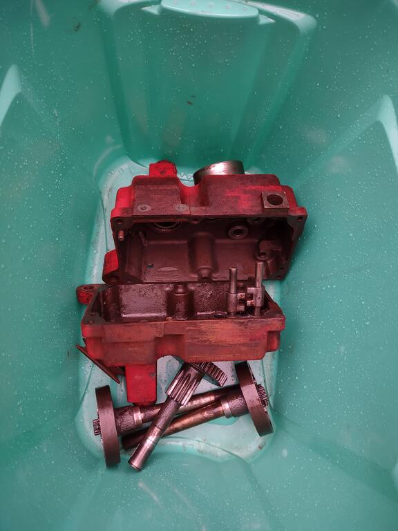

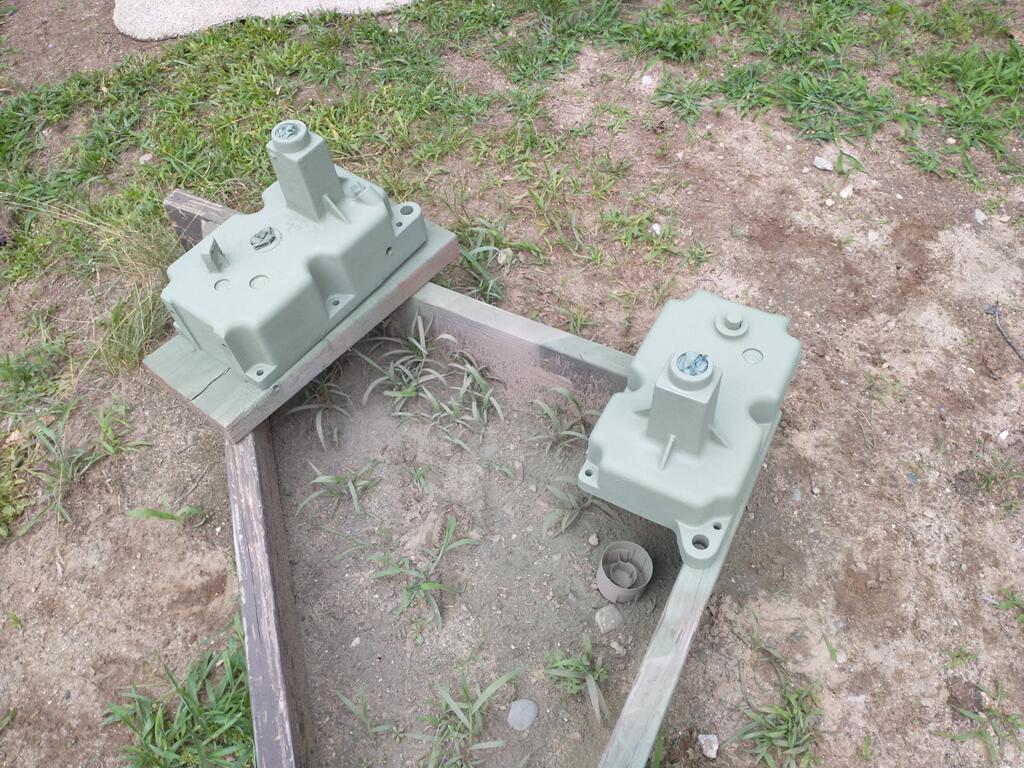

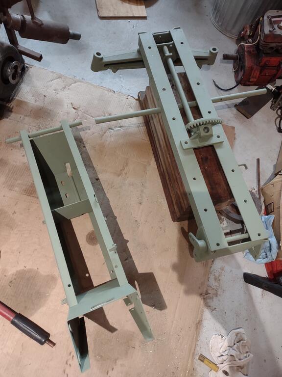

ebinmaine 80,975 #54 Posted July 4, 2021 Got a little more done on the rig today. I finished disassembly on the transmission. I found a wheel bearing that was somewhat beyond repair. Also discovered that when the differential and bull gear bolts came out at least one rode around the bull gear some. The bottom of both case halves is scun up but not worn through. One side is cracked but not broken. This'll be a very lightly used and rarely driven tractor so I'll opt for attempting a J. B. Weld repair if deemed necessary later on. Trina helped clean the largest of the muck off. We got a plastic tote bin container holder and placed the halves along with some of the other parts in it. Add 5 gallons of diesel and cover. Tomorrow or the next day we'll take out the pieces, scrub a tad, and flip em over back into the juice. 5 3 Share this post Link to post Share on other sites

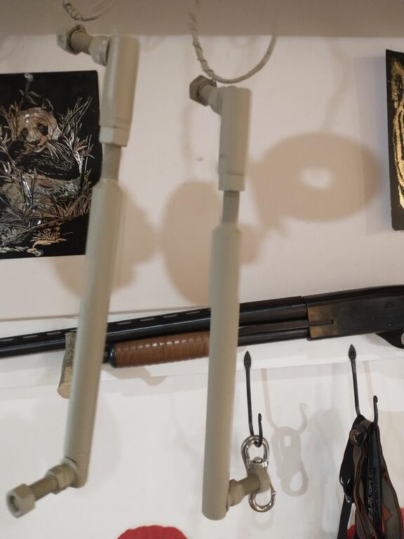

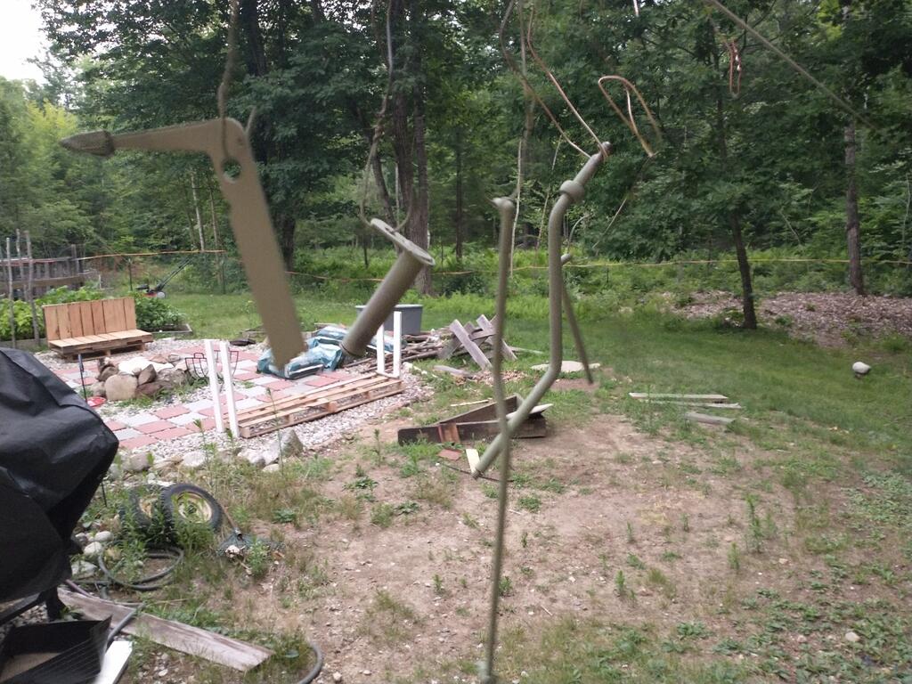

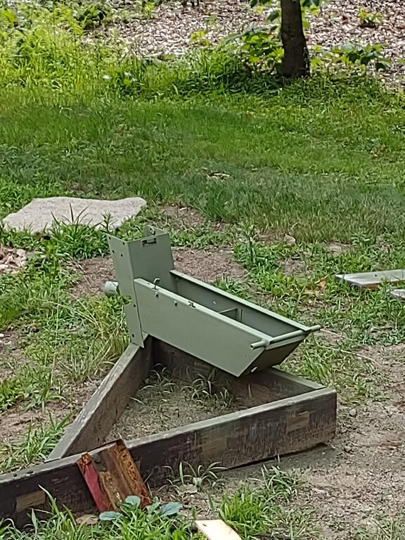

ebinmaine 80,975 #55 Posted July 6, 2021 Well folks we're getting really narrowed down on things left to paint. All that's left is the wheels, couple of rods and levers, and I still need to put the transmission together so that can be painted... Here's today's progress: 4 4 Share this post Link to post Share on other sites

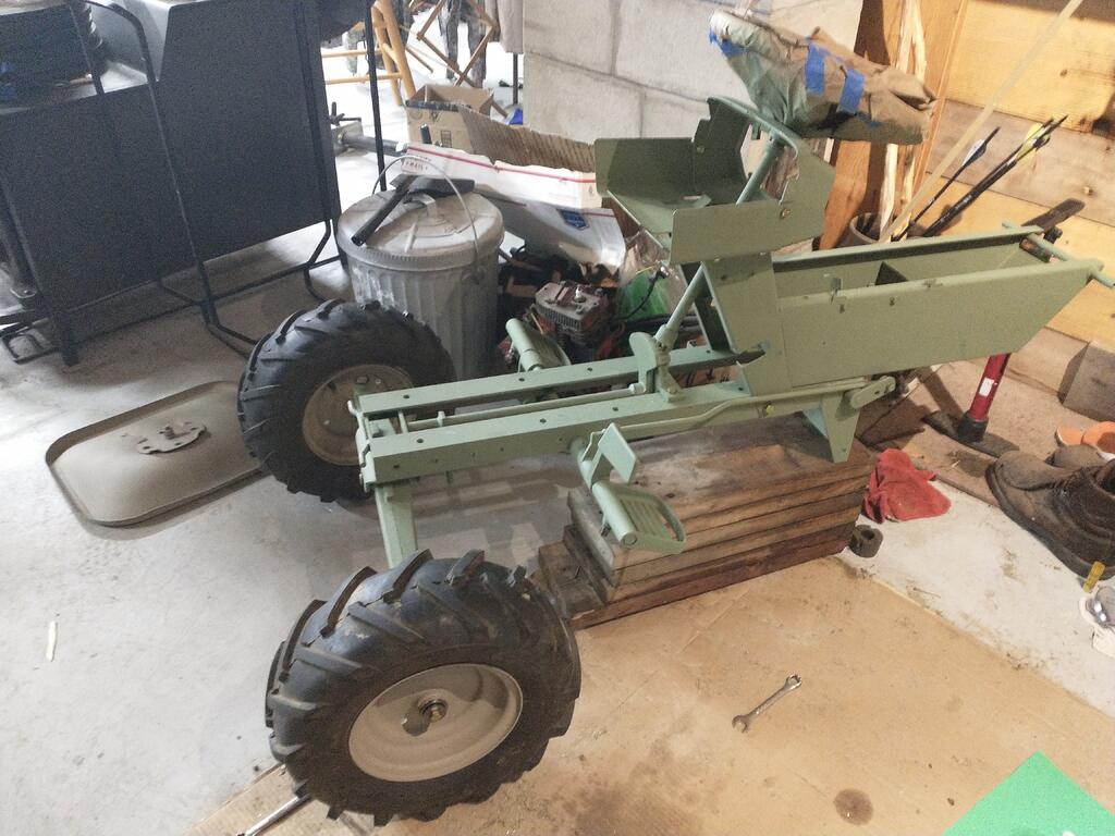

ebinmaine 80,975 #57 Posted July 7, 2021 Near as I can figure all we've got left at this point is wheels, engine, transmission. She's likely to begin assembly in the next couple days. 6 3 Share this post Link to post Share on other sites
Pullstart 71,386 #58 Posted July 8, 2021 Once again, those are some sweet wind chimes BBT! 1 1 Share this post Link to post Share on other sites

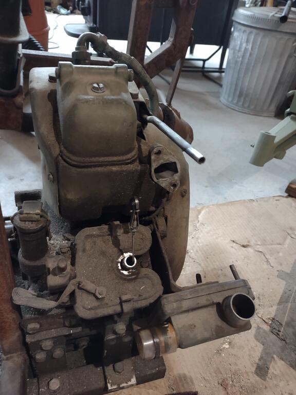

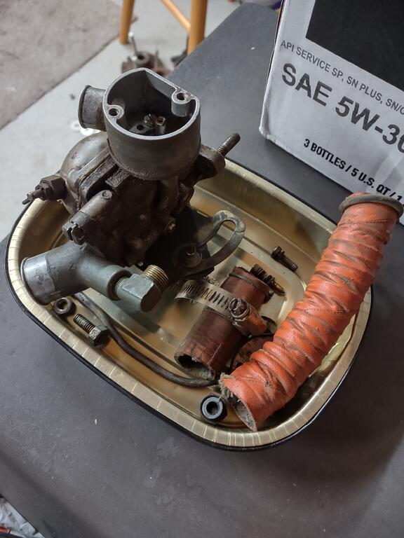

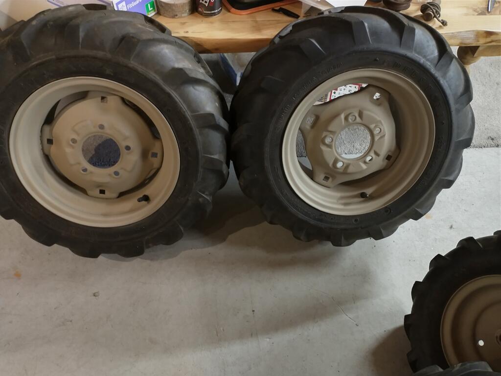

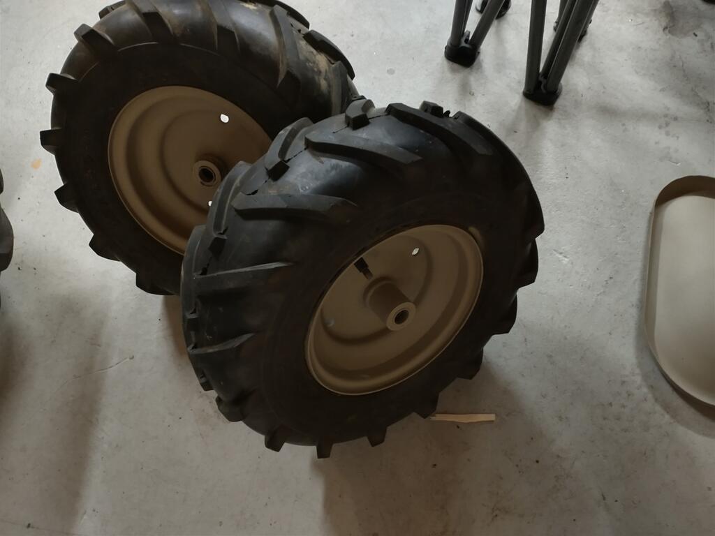

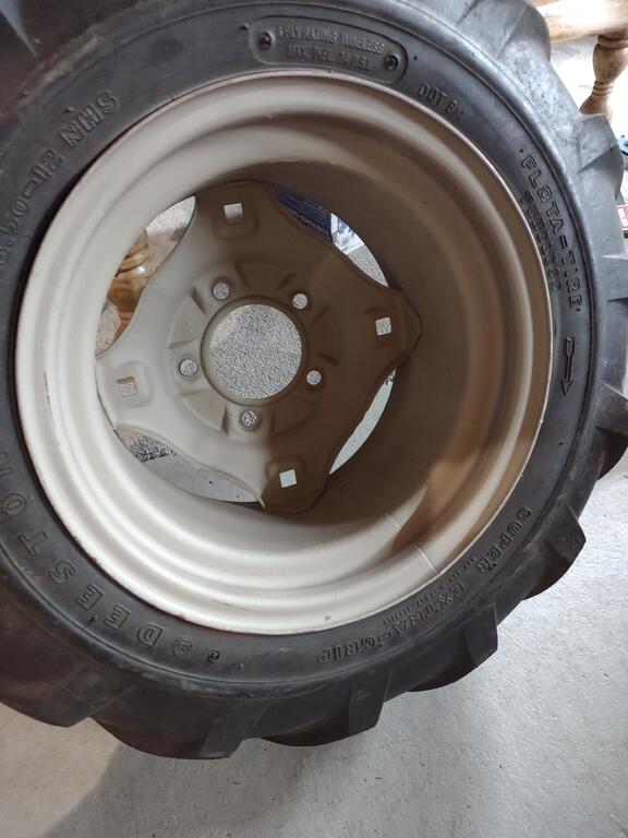

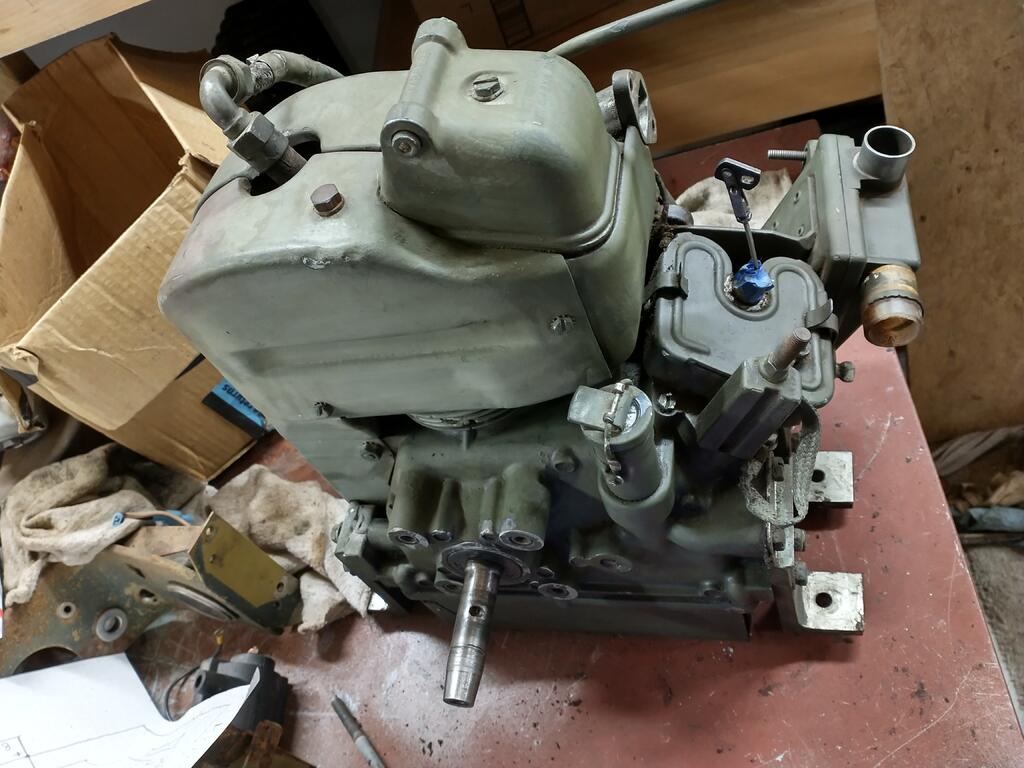

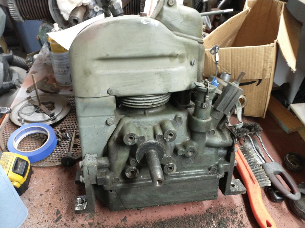

ebinmaine 80,975 #62 Posted July 9, 2021 Trina started a wee bit of assembly this evening. Front axle is hung. Steering set in place. I pulled the carb off the engine. Seems simple enough. Not the filthiest one I've ever seen but certainly overdue for a good cleaning. Need to find/make gaskets and get it back together. I'll take a peak at the manual @pfrederi sent me. The governor arm was loose so I'll need to adjust/set that. Also here's a picture of a rear wheel after 1 coat of paint. 2 5 Share this post Link to post Share on other sites

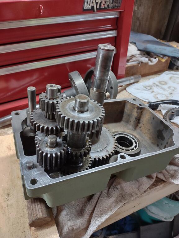

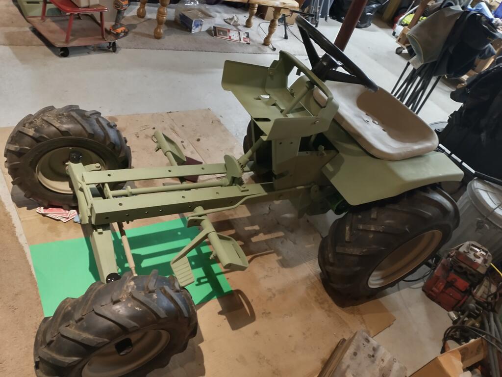

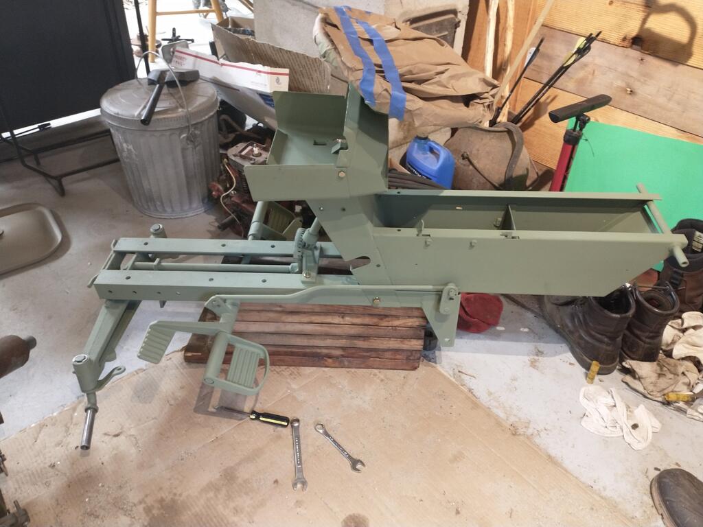

ebinmaine 80,975 #66 Posted July 11, 2021 Today's progress was good. I finished up cleaning out the transmission. Got that all spotless inside and out. BBT scraped it a bit with a hand wire brush to free up a little left over loose paint and rust then washed with her usual bare metal prep of acetone. That and several other things got newly painted or more paint. Here's the chassis as it sets tonight. And a bonus deer pic from this morning out my kitchen window. Zoom in at center. 3 3 Share this post Link to post Share on other sites

ebinmaine 80,975 #68 Posted July 13, 2021 Work continued today with Trina swapping out the bearings in the front wheels for the new SEALED units I got in the mail today.... Then bolting the front wheels on. Also, she worked on getting the fuel tank off the carriage frame the engine sits in and lining it up to mount in the tractor. While she did that I modified my transmission mounting desk a bit, set the trans half in and put the gears in the case. I had to scavenge the 4 differential bolts from the parts pile. Ran out of time before I could get them cleaned up and installed. Perhaps finish up the transmission tomorrow. 4 8 Share this post Link to post Share on other sites

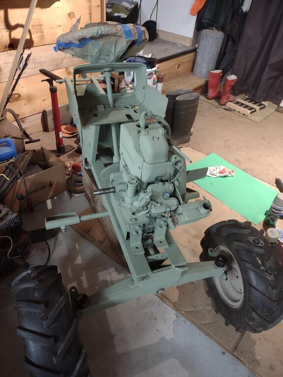

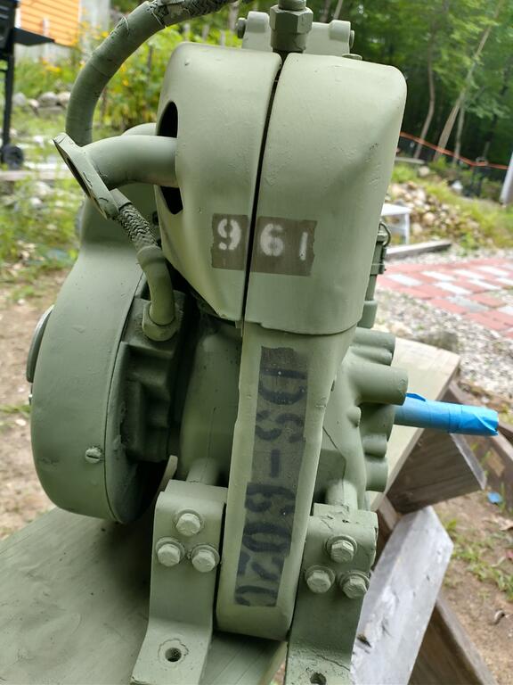

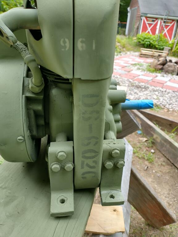

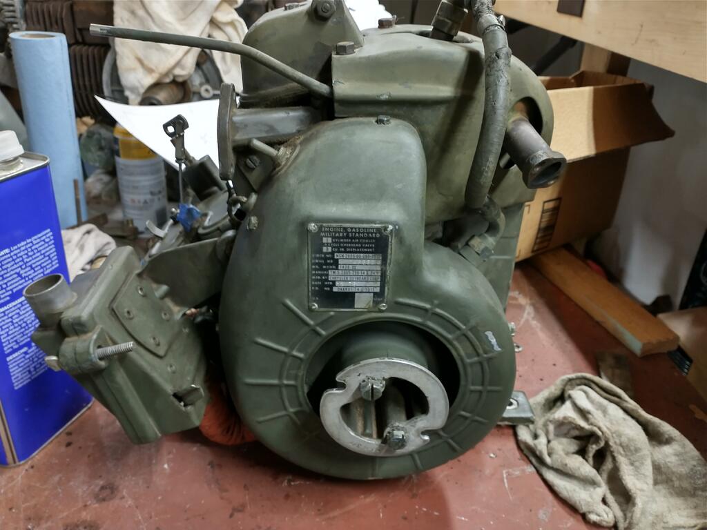

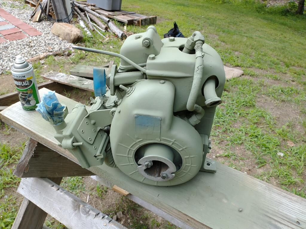

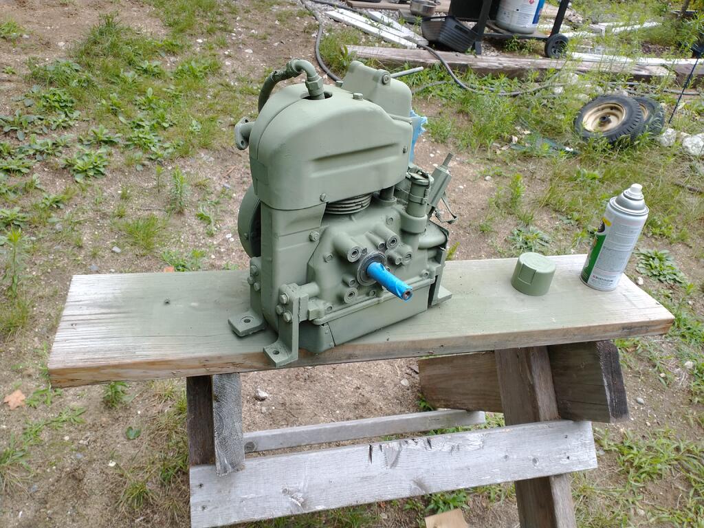

ebinmaine 80,975 #69 Posted July 13, 2021 (edited) Trina's been cleaning up and repainting the engine today. Got it out of the stand that it was in. Scraped it down then wiped it with acetone. She put a couple coats of paint over most of the engine. Here's the side with the original military letters after BBT painted it. Obviously she had masked off that area. She wasn't satisfied with the way it looked so a little bit of controlled overspray later..... And here it is sitting in the tractor. Edited July 13, 2021 by ebinmaine Moved pics 2 7 4 Share this post Link to post Share on other sites

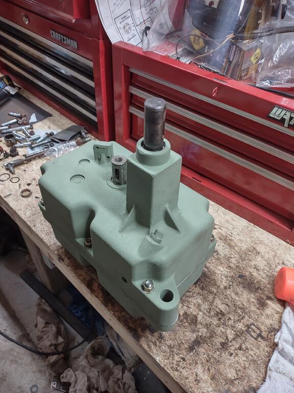

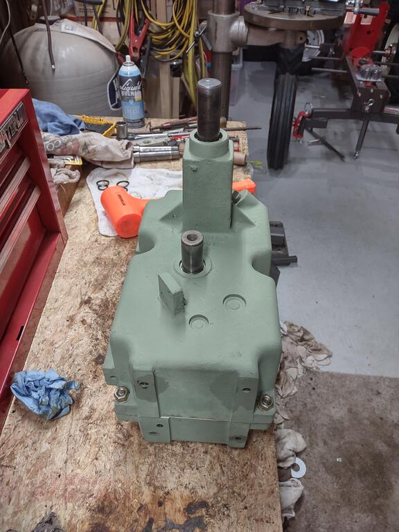

ebinmaine 80,975 #72 Posted July 14, 2021 17 minutes ago, Oldskool said: Making really good progress there. Time is getting short. Counting down the days lol Gettin' there Mike. This evening we got the transmission together. Trina will put one more coat of paint on later. Need to install the 4 seals and bolt it in place. Thought some of you would get a kick out of this old Toro label. The gasket is from the auction we went to almost 3 years ago now. 15 years old. 7 4 1 Share this post Link to post Share on other sites

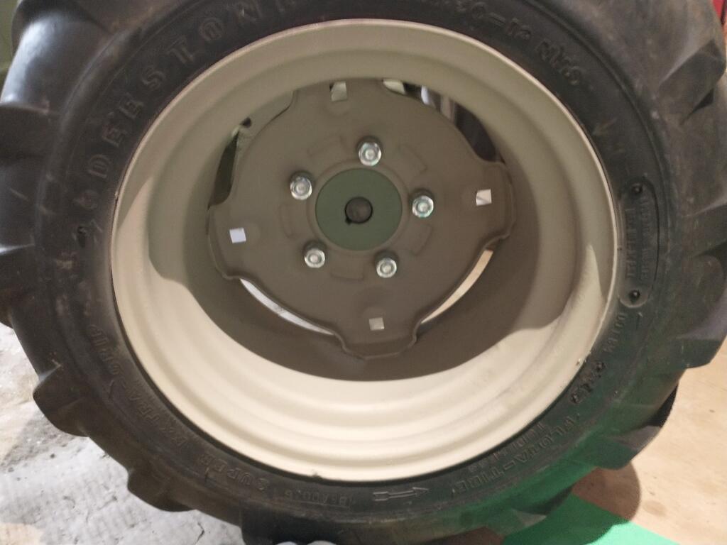

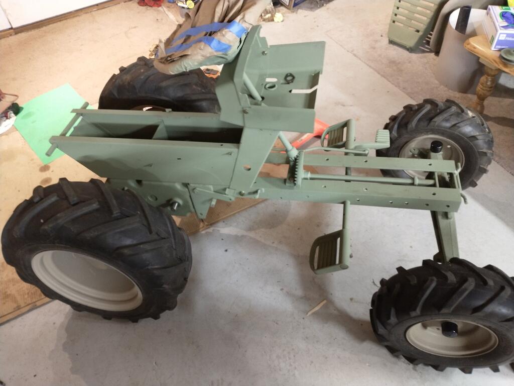

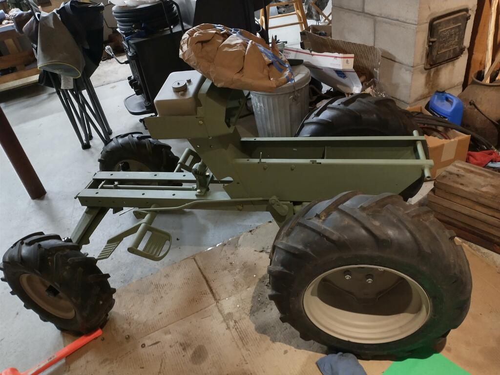

ebinmaine 80,975 #73 Posted July 15, 2021 This evening we got the transmission together and in the tractor. Millie's a roller!!! Of course the now "standard on all our builds" lug nut conversion. Last coat of paint on the fuel tank. 2 6 Share this post Link to post Share on other sites

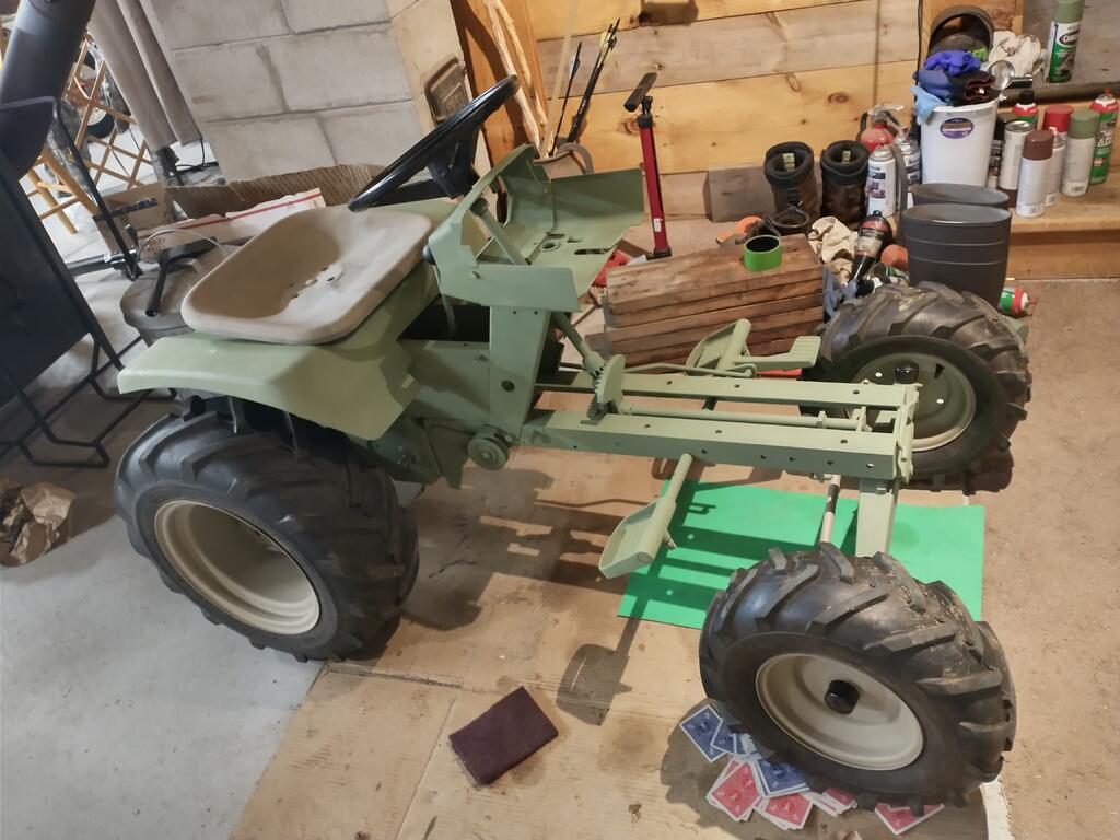

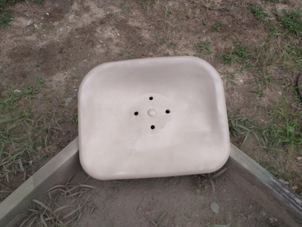

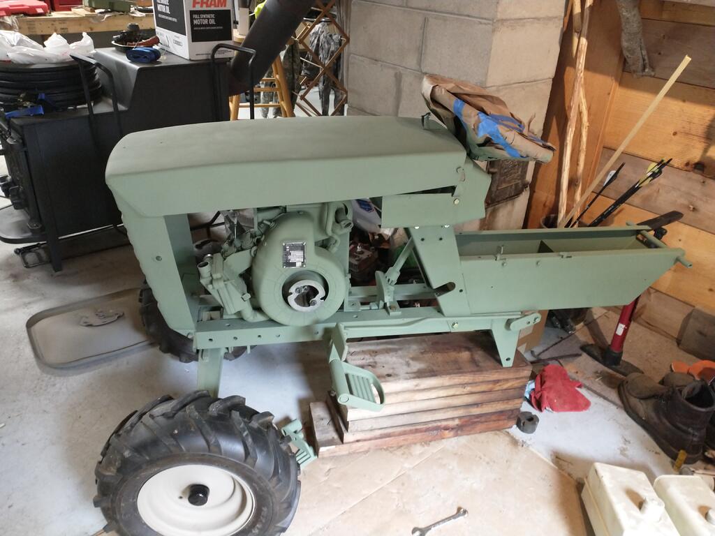

ebinmaine 80,975 #74 Posted July 16, 2021 (edited) Transmission filled with 80w-140. Shift lever in. Drive and brake drum on transmission. We rolled it outside so The Paint Department could do a quick overall spray to cover the tractor as a whole. Painted over the nuts and bolts, areas where things were touched or scratched during assembly, etc. She put the tie rods on but they need adjustment or replacing. It's towed OUT something fierce. I'll pick up some 3/8 fine rod and get some together. Added the seat pan and seat... Edited July 16, 2021 by ebinmaine Correct auto correct 3 2 Share this post Link to post Share on other sites
