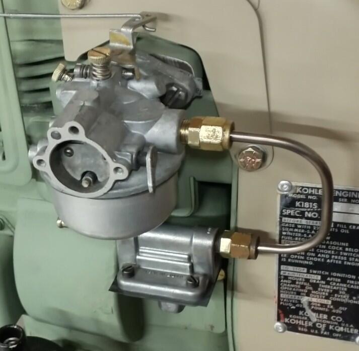

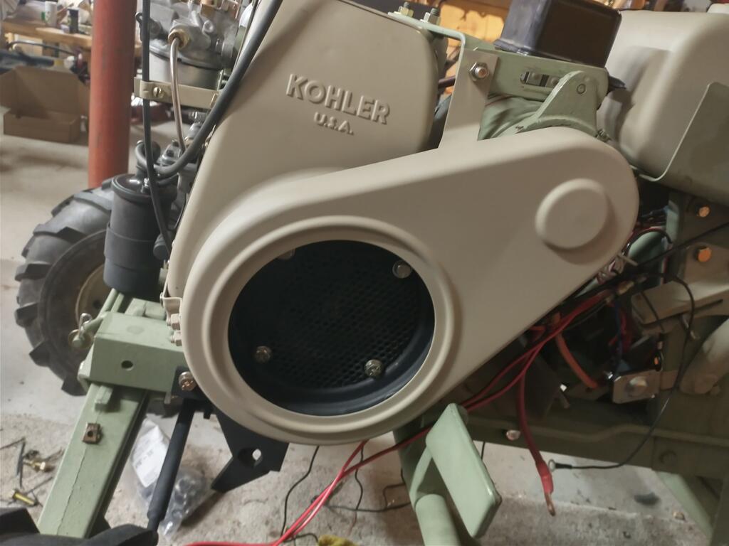

ebinmaine 80,974 #301 Posted April 12, 2023 This evening we rebuilt the fuel pump and carb. Polished up the fittings. Trina installed both. 1 13 Share this post Link to post Share on other sites
Oldskool 6,678 #302 Posted April 13, 2023 Nice install. 1 1 Share this post Link to post Share on other sites

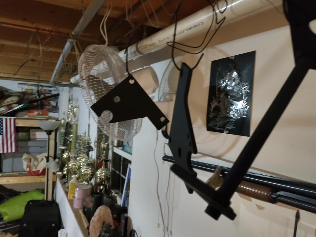

Lee1977 7,805 #303 Posted April 13, 2023 5 hours ago, ebinmaine said: Found out this hitch does NOT fit the tractor. Oh well. Is this what you need? Fresh "USED" parts got some rust, ware and old paint. Just 52 years old almost new. Not one of those fancy spring loaded latch hitch, uses a pin comes with an extra hole to tighten on warn hitch bar. You can saw off the part where the pulley was attached and make them match. It can be yours just PM me your address and the name of your Wheel Horse Restoration Establishment. Just let me know I'll mail it out bright and early at our One Horse Post Office, but the truck won't come by until 5: 30 PM. 1 2 Share this post Link to post Share on other sites
Tractorhead 9,217 #304 Posted April 13, 2023 She looks hot Eric 1 1 Share this post Link to post Share on other sites
ebinmaine 80,974 #305 Posted April 13, 2023 6 hours ago, Lee1977 said: Just 52 years old almost new. 6 hours ago, Lee1977 said: Is this what you need? . Not one of those fancy spring loaded latch hitch, uses a pin comes with an extra hole That's perfect Lee! Yepp. Trina's familiar with how those work because that's what's on her 867. I just didn't realize the 70s hitches were too wide to clear the steering. Thanks!! Share this post Link to post Share on other sites
Lee1977 7,805 #306 Posted April 13, 2023 You need that piece for the pulley sawed off. If so let me know. 1 1 Share this post Link to post Share on other sites
ebinmaine 80,974 #307 Posted April 13, 2023 1 hour ago, Lee1977 said: You need that piece for the pulley sawed off. If so let me know. PM sent.. Thank you very much for sending that. 1 Share this post Link to post Share on other sites

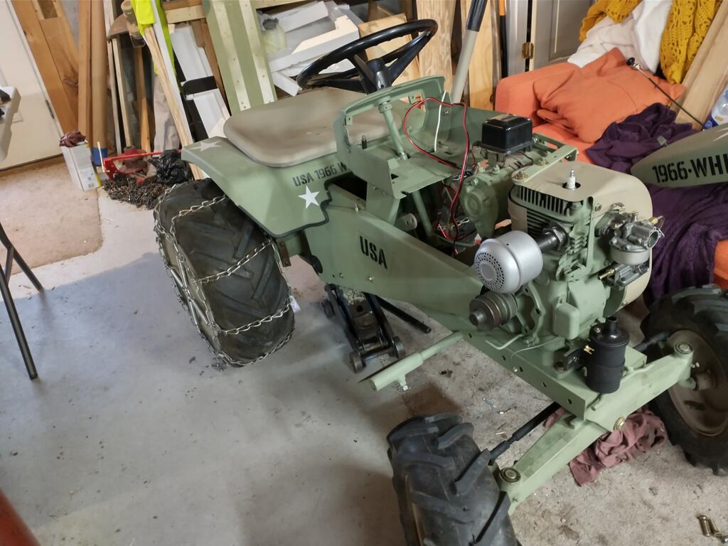

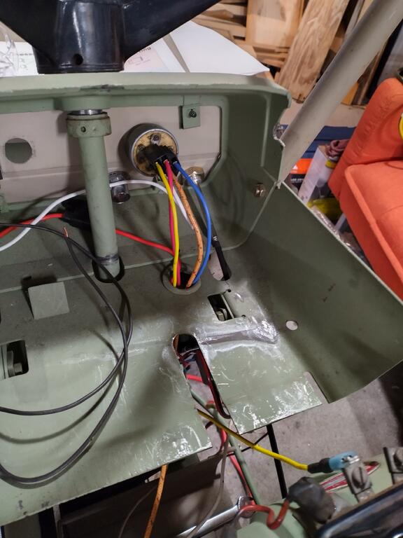

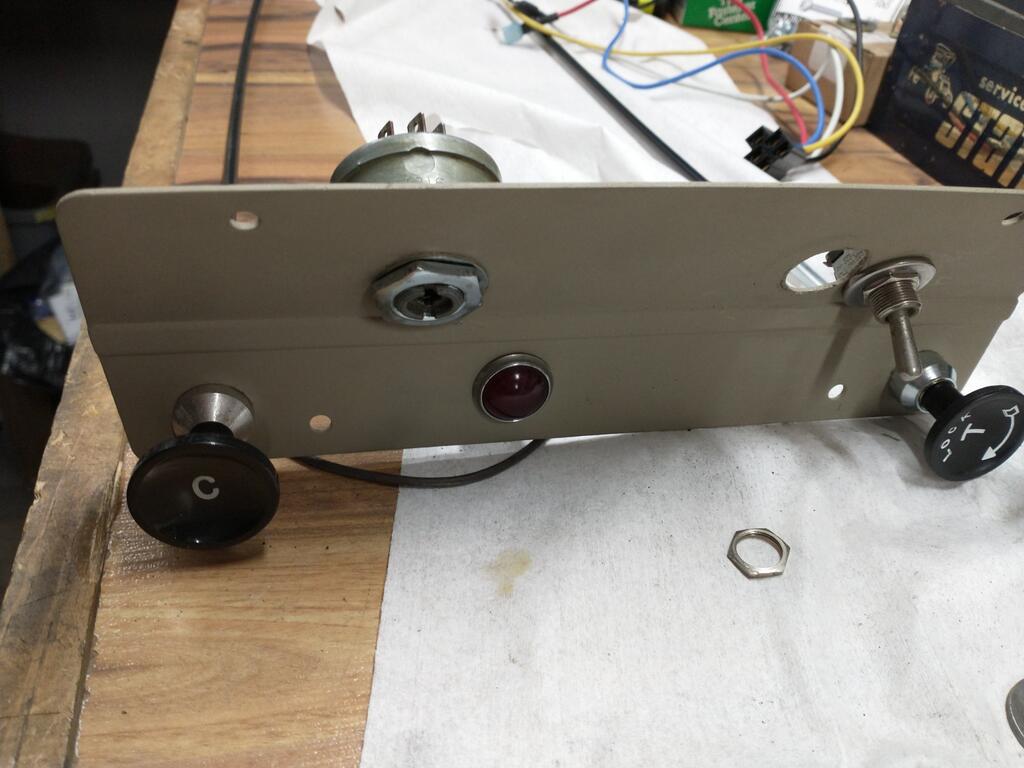

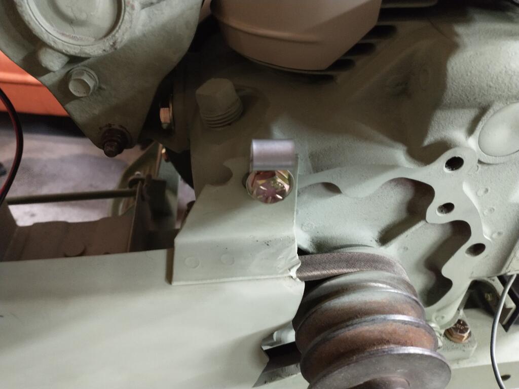

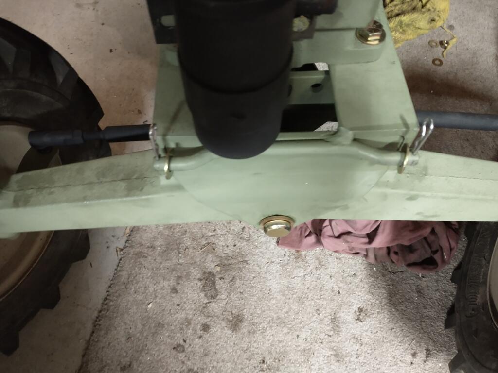

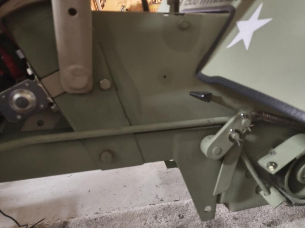

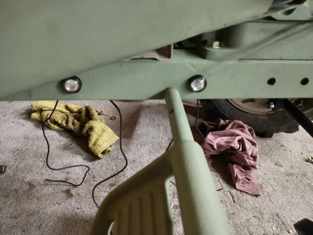

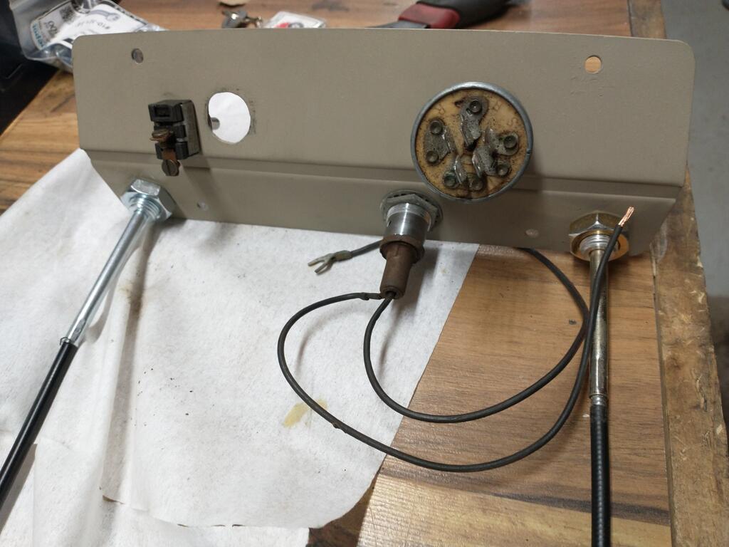

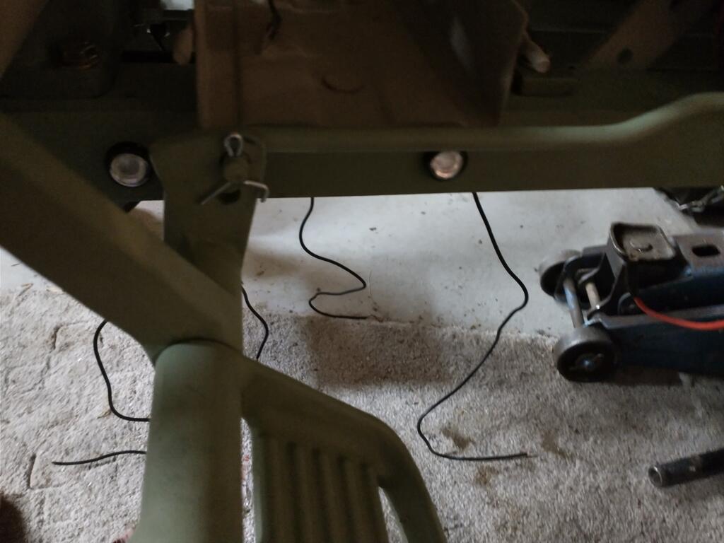

ebinmaine 80,974 #308 Posted April 14, 2023 Got a few more trinkets installed this evening. I cleaned out the holes in the ends of the hood supports and found washers with hairpins to use there. This tractor hasn't had those there since the last build because the holes were stuffed with ... Stuffff. Dash faceplate assembled with cables and switches. Frame side lights in. S/G belt on. Holding clip for the fuel line on. 2 6 Share this post Link to post Share on other sites
WHX?? 58,307 #309 Posted April 14, 2023 What's with the grade 8 bolts? Little over kill ain't it? Or just what ya had laying around? 1 Share this post Link to post Share on other sites
kpinnc 19,015 #310 Posted April 14, 2023 4 hours ago, WHX?? said: What's with the grade 8 bolts? Little over kill ain't it? Or just what ya had laying around? I use them alot too. At TSC, they sell the same grade by the pound. I usually just get a big bag and use them until they are gone. 4 Share this post Link to post Share on other sites
ebinmaine 80,974 #311 Posted April 14, 2023 7 hours ago, WHX?? said: grade 8 bolts? I switched over to using almost exclusively grade 8 hardware a few years ago. Pricing nowadays is excellent. Very comparable to grade 5. The extra strength is worth what little extra costs I incur. All our equipment - tractors, trailers, chipper, log splitter, snow removal equipment, etc get moved around and used on tough terrain. There's no such thing as flat ground here without rocks stones stumps roots except right between the house and barn. I've seen grade 2 and 5 wear out or even break with metal fatigue. It's also about corrosion resistance. The zinc coating can be had on gr 5 but it's standard for gr 8. Bolt depot. Hingham Massachusetts. Excellent pricing and customer service. 4 1 1 Share this post Link to post Share on other sites

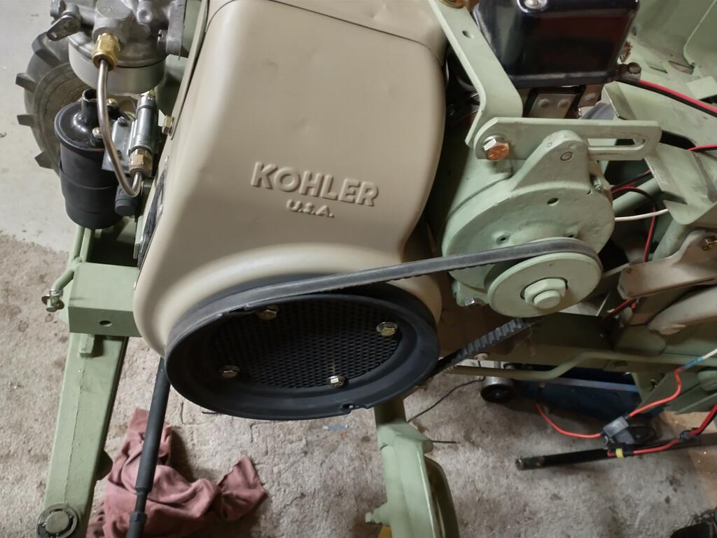

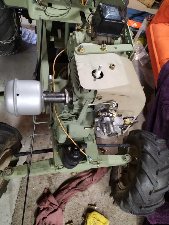

ebinmaine 80,974 #312 Posted April 18, 2023 The S/G belt is too short. How do we find the right one? Share this post Link to post Share on other sites
rjg854 13,405 #313 Posted April 18, 2023 What did you do with the one that was on it? 1 Share this post Link to post Share on other sites
ebinmaine 80,974 #314 Posted April 18, 2023 1 minute ago, rjg854 said: What did you do with the one that was on it? Didn't have one. Pile of stuff in a box... Share this post Link to post Share on other sites
ebinmaine 80,974 #315 Posted April 18, 2023 2 minutes ago, rjg854 said: What did you do with the one that was on it? The one we put one was a spare from the wall. Share this post Link to post Share on other sites

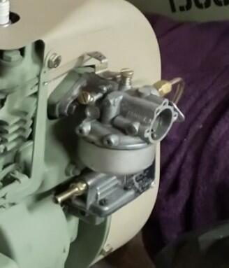

Racinbob 13,213 #316 Posted April 19, 2023 That cogged one in the picture looks like it will work but if anything going to a fuzz longer. Definitely not shorter. Check the p/n on another K-181 S/G unit? Share this post Link to post Share on other sites
ebinmaine 80,974 #317 Posted April 19, 2023 40 minutes ago, Racinbob said: That cogged one in the picture looks like it will work but if anything going to a fuzz longer. Definitely not shorter. Check the p/n on another K-181 S/G unit? Nuthin readable around here. Looking at a listing @Rob J. shared with me I think if I try something 1.5" longer we may have it. 1 Share this post Link to post Share on other sites

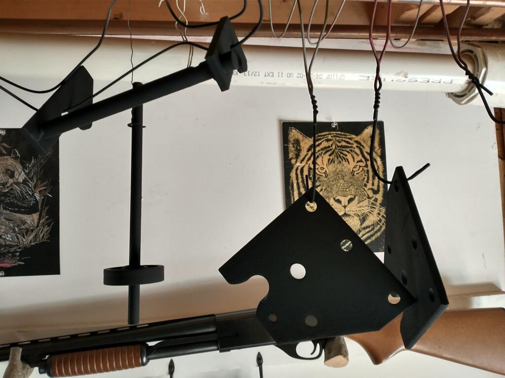

ebinmaine 80,974 #318 Posted April 20, 2023 @Lee1977 sent a mid hitch to Trina. I cut that a bit the other day. This evening she a ground the edge and threw some paint on it. I started laying out the wiring harness. 5 2 Share this post Link to post Share on other sites

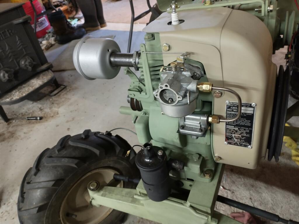

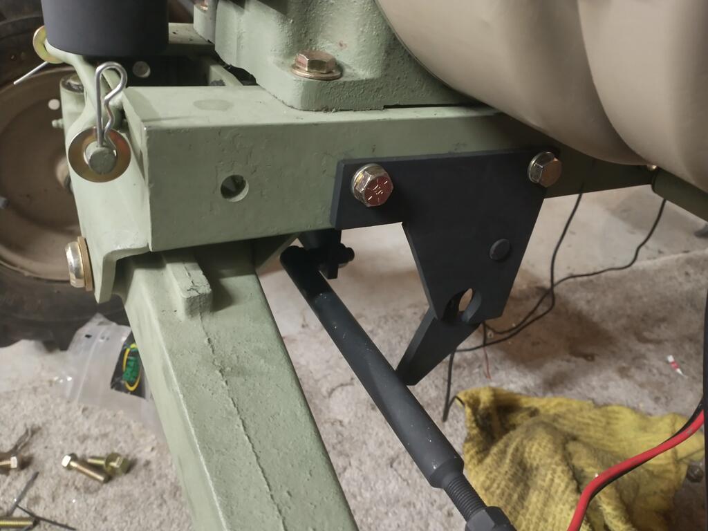

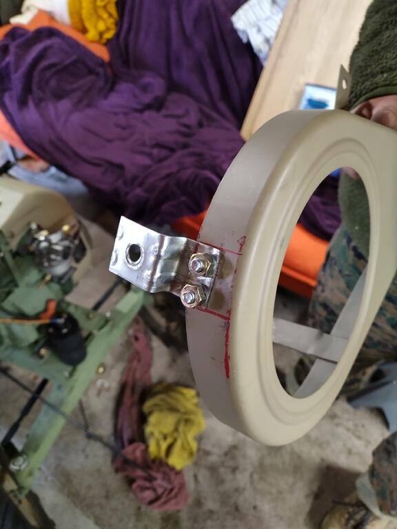

ebinmaine 80,974 #319 Posted April 23, 2023 The bottom bracket of the S/G belt guard was broken off. Trina found a spare hunk o metal laying around and made a bracket for the Millie engine. It'll get painted later this week. 4 1 Share this post Link to post Share on other sites

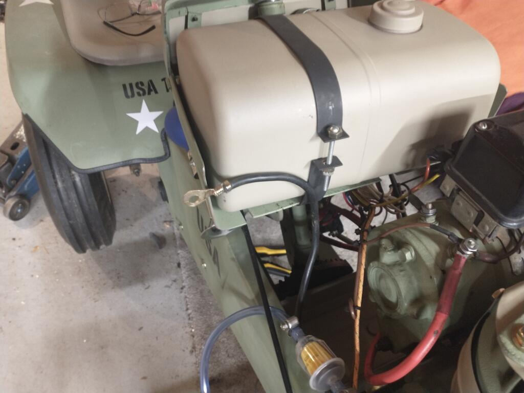

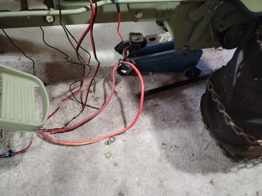

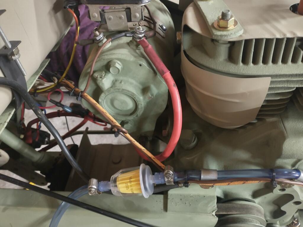

ebinmaine 80,974 #323 Posted May 1, 2023 Well we've been pretty on the past edge of ridiculous busy for a few days but we've got a few more things done on the Millie tractor. Here's the mid mount hitch sent up by @Lee1977 Trina got a few small parts painted and installed such as this belt guard she repaired with spare parts off the shelf. Also above is the choke bracket we borrowed from another engine while we find one for this. Trina got the brake and clutch linkage all corrected and back on. One bolt broke so we'll have to address that when we get back from Zagray. Also seen above is the location of the starter solenoid. I've been working on building a whole new wiring harness over the last couple weeks. I like to use plenty of zip ties to keep it in place and away from other pieces. Trina added the fuel filter and lines. We got the fuel tank in place this evening. Next session we'll finish connecting that. In order to get this tractor in the 5 x 8 trailer we'll have to set it in sideways across the back. To reduce width and length we changed the rear tires for a set of fronts I keep for Cinnamon Horse. That uses 5 lug rims. At the show(s) we'll pop the other set back on. Note the BBT "half face" selfie..... 6 9 Share this post Link to post Share on other sites
