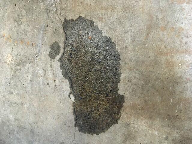

AHS 1,552 #1 Posted April 2, 2021 It started with the puddle on the floor, it’s probably 15 oz worth. Which lead me to my right axle seal. I got the hub off and cleaned the axles seal up, this lead me to checking the axle fluid.... full! Did I have too much in there? About 1.5 quarts. The fluid stain goes all the way up to the fill.. which by the laws of gravity cannot be dripping while sitting there! I changed it in about December of last year.. and it looks to be about full. It sat for about a month, maybe longer. I’m stumped... is 1.5 quarts too much? Could the vent be clogged/where is the vent? Can I just change the axle seal with the hub off, it looks easy? I will check today to see if any axle lube is in that bucket, and where it came from. 1 Share this post Link to post Share on other sites

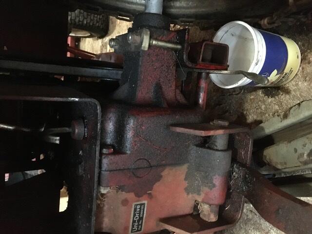

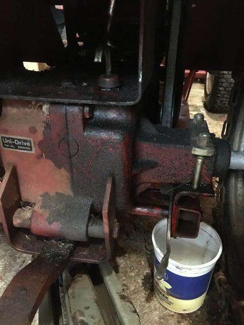

Ed Kennell 42,363 #6 Posted April 2, 2021 All good advice above from Eric, Richard, and Garry. Just a couple observations from your pictures. That stain on the floor looks like much less than 15 oz to me. With all that oil on the top of the case , it appears the leak may be from the fill tube. And yes, before you replace the seal, file the area around the keyway to remove all burrs and sand the axle so the hub wlll slide over the full length of the axle. 5 Share this post Link to post Share on other sites

WHX?? 52,079 #8 Posted April 2, 2021 Neck was hurting .... Sure does look like coming from further up? 3 Share this post Link to post Share on other sites
WHX?? 52,079 #9 Posted April 2, 2021 (edited) 2 minutes ago, WHX24 said: Neck was hurting .... Sure does look like coming from further up? I would check those bearings, change oil & give her rear end a bath and monitor. Whoops quoted my own post instead of edit.... Brain fog from that second jab yesterday! Edited April 2, 2021 by WHX24 Share this post Link to post Share on other sites

ebinmaine 73,288 #12 Posted April 2, 2021 Definitely want to get yourself three or four cans of brake clean or whatever degreaser is Handy to you and get that transmission cleaned up. I'm not at all thinking that the axle seal is causing all that fluid at the top of the transmission. 7 Share this post Link to post Share on other sites

ebinmaine 73,288 #15 Posted April 2, 2021 Just now, clueless said: Clean it up first then watch for a slow leak, your assuming it the axle seal, that's a lot of oil above the axle seal even if is creeping up. I've never had an axle seal allow oil to creep up more than maybe half an inch above the tube itself so in my mind it isn't an option that the axle seal is causing that entire mess although I've been known to be proven wrong on some occasions..... Many many years ago. Share this post Link to post Share on other sites
stevasaurus 23,325 #16 Posted April 2, 2021 My guess is the axle seal if just fine. The oil by the fill tube is from when it was filled last December. It goes in slow and some went over the top before it could drop into the transmission. The spill on the concrete is from only a few drops of oil that finally dripped down the side of the case. I'd bet, if the case was cleaned up, no more oil would be on the floor. Clean case first and check to see if that fixed your leak. 5 Share this post Link to post Share on other sites
