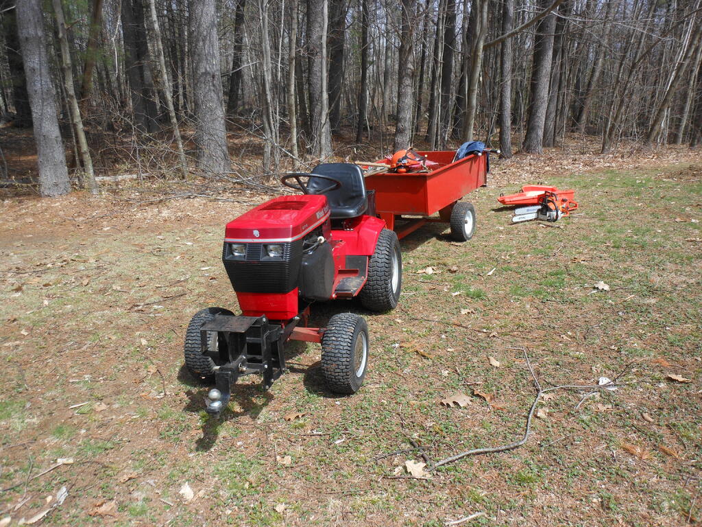

ebinmaine 80,932 #76 Posted May 2, 2021 1 minute ago, JCM said: No, picked that up at the dealer years ago and turned it into a front hitch set up with a front electric winch years back. Yepp Yepp. I'm thinking mine might end up multi-use. Perhaps a gen-set mount? Maybe an air compressor mount? Pop off and swap out for multiple things. 1 Share this post Link to post Share on other sites

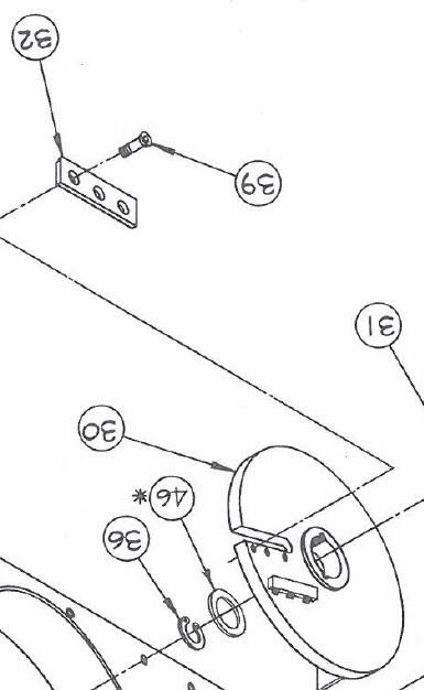

gwest_ca-(File Mod) 12,510 #88 Posted May 4, 2021 This is what I see when I open the door to remove the knife. There is a bar welded to the flywheel that the knife mounts up tight to and takes the constant blows of the cuts. There are 3 flat head screws (3/8" I think) that take an Allen wrench. They want Loctite on the threads. I use a manual impact driver that you hammer for removing and reinstalling. Have to heat the head of the bolt to release the Loctite even though I use the light blue strength. Don't like hammering on the flywheel and bearings too hard. From the description early models had 3 holes with plugs to access the screws for loosening. Then you rotate the flywheel to get the knife to the chipper opening to remove them and the knife. Mine has a door at the 9:00 o'clock flywheel position with the chipper opening at 3:00 o'clock with the chipper chute mounted square on the machine. I see the photos of the new models have the chipper chute at about 2:00 o'clock and mounted at an angle. Don't know why. Do wish the knife was 1/2" longer or the chute 1/2" narrower. Sometimes a sliver of wood will go in past the ends of the knife and wrap it's self around the shaft. Perhaps that is the reason for the change. Mine has what I suspect is the original engine with an August 27, 1991 build date. Machine serial number 514686. Garry 1 Share this post Link to post Share on other sites

Handy Don 17,561 #90 Posted May 4, 2021 2 hours ago, gwest_ca said: a bar welded to the flywheel that the knife mounts up tight to and takes the constant blows of the cuts. There are 3 flat head screws (3/8" I think) that take an Allen wrench. That's the Tomahawk arrangement as well. On the flywheel it is set a at an angle to the branch-feed opening so it "slices" across. 1 Share this post Link to post Share on other sites

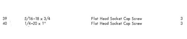

seuadr 490 #91 Posted May 4, 2021 5 minutes ago, Handy Don said: That's the Tomahawk arrangement as well. On the flywheel it is set a at an angle to the branch-feed opening so it "slices" across. mine turned to mush when i put an allen wrench in them(the holes). i'm going to be using an alternative tool - a 7/32 cobalt drill bit 1 Share this post Link to post Share on other sites
Handy Don 17,561 #92 Posted May 4, 2021 2 hours ago, seuadr said: mine turned to mush when i put an allen wrench in them(the holes). i'm going to be using an alternative tool - a 7/32 cobalt drill bit I bought a box of those screws. New every time I swap the knife. 1 Share this post Link to post Share on other sites
seuadr 490 #93 Posted May 4, 2021 8 minutes ago, Handy Don said: I bought a box of those screws. New every time I swap the knife. Do you know the thread offhand? I'm going to get a tap and clean the threads up after i use an easy out to finish getting the screws out. I drilled through the center, hoping they'd back out but no bueno. 1 Share this post Link to post Share on other sites
seuadr 490 #94 Posted May 5, 2021 16 hours ago, seuadr said: Do you know the thread offhand? I'm going to get a tap and clean the threads up after i use an easy out to finish getting the screws out. I drilled through the center, hoping they'd back out but no bueno. looks like they are a 5/16 -18 does that seem right? Share this post Link to post Share on other sites
Handy Don 17,561 #95 Posted May 5, 2021 1 minute ago, seuadr said: looks like they are a 5/16 -18 does that seem right? The Tomahawk uses screws and nylock nuts, no threads in the flywheel hole. They are 5/16" though 1 Share this post Link to post Share on other sites
gwest_ca-(File Mod) 12,510 #96 Posted May 5, 2021 Knife and anvil screws. 2 Share this post Link to post Share on other sites

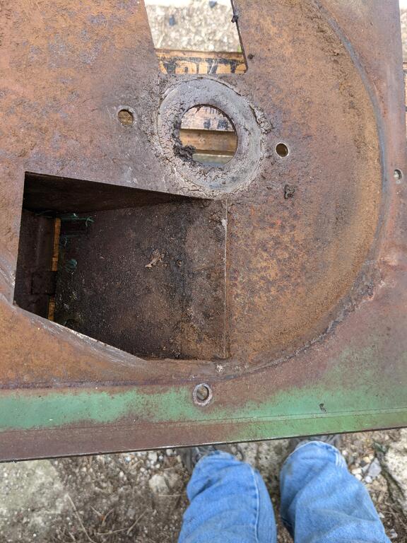

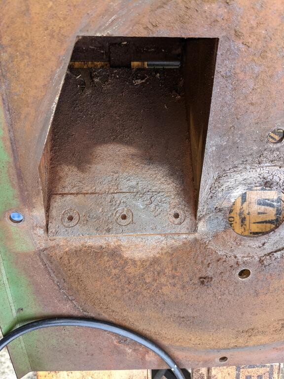

seuadr 490 #97 Posted May 5, 2021 10 minutes ago, gwest_ca said: Knife and anvil screws. you know, it is kind of interesting - i don't have an anvil on mine. when i was looking, i don't even recall seeing a spot for it, i'll have to double check, though. Share this post Link to post Share on other sites
seuadr 490 #98 Posted May 5, 2021 1 hour ago, seuadr said: you know, it is kind of interesting - i don't have an anvil on mine. when i was looking, i don't even recall seeing a spot for it, i'll have to double check, though. Well I'll be damned. There it is! 1 1 Share this post Link to post Share on other sites
Handy Don 17,561 #99 Posted May 5, 2021 That replaceable anvil is a nice feature! Tomahawk doesn't have that -- just the thick steel plate of the chute. Share this post Link to post Share on other sites
