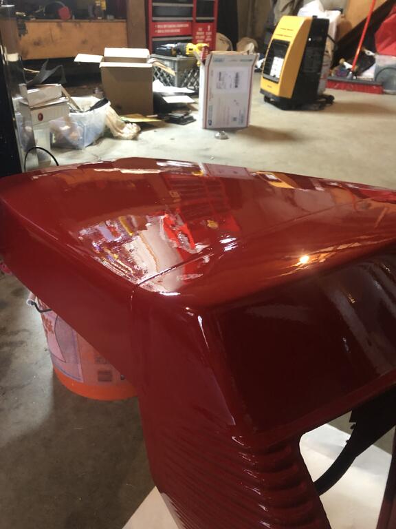

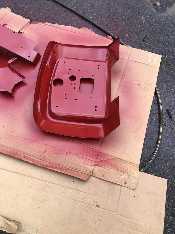

WheelhorseBob 1,550 #1 Posted March 26, 2021 Painted the underside of some 416-8 tins to get a feel for mixing Rustoleum/acetone/hardener. For my first time I’m happy. The weather really wasn’t ideal for painting but I will definitely wait for better conditions to do the top sides. This was also the cheap harbor freight purple gun. 10 1 Share this post Link to post Share on other sites

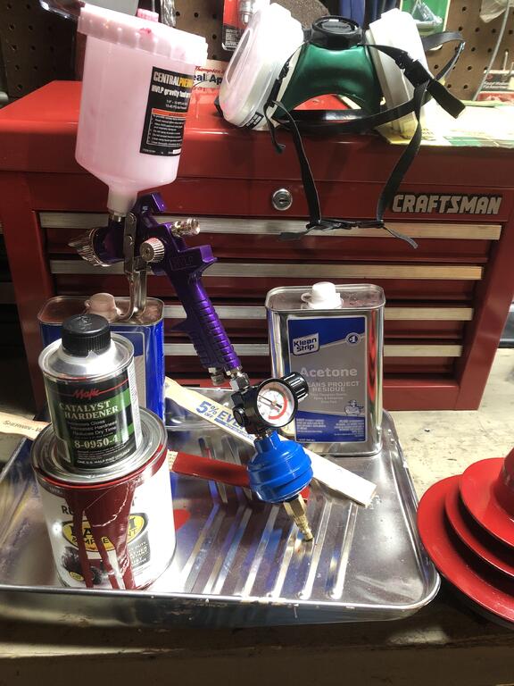

WheelhorseBob 1,550 #3 Posted March 26, 2021 Well I prefaced this with the fact that I’ve never used a spray gun or mixed paint for spraying before. You have to consider that when I give my opinion. I watched a few YouTube videos and googled a bit. Seems you can use enamel thinner, mineral spirits or acetone. I had acetone on hand. Thinned it very well. Better? No idea. I used 8oz. Paint, 4oz. Acetone and 2 cap fulls of Majic hardener. Might be all wrong and would love the input of those more experienced. I’ll say this though, I think I’m done with rattle cans! 3 1 Share this post Link to post Share on other sites
Achto 32,891 #4 Posted March 27, 2021 Here are a few mixing pointers Using mineral spirits in Rustoleum would be great on a warm or hot day as it will slow the drying time. Enamel reducer would be a good all around reducer and probably what I would use. Acetone will greatly decrease drying time and would be good in cooler temps. Reduction instructions should be printed on the paint can. I usually follow the recommended reduction ratio. If it is not printed on the can, check their web site for recommendations. Enamel hardener is usually added at a ratio of 16 parts paint to 1 part hardener. 3 2 Share this post Link to post Share on other sites

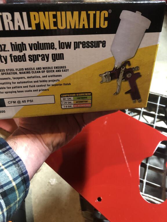

WheelhorseBob 1,550 #6 Posted March 27, 2021 2 minutes ago, Jeff-C175 said: Is that the famous "Regal Red" Bob? I had to thin some Rustoleum "Door Paint" and as I recall the instructions said to use Xylene? I was brushing it though but I wonder if Xylene would be a good thinner for gunning, and how it fits into that drying time scenario? I'm planning on picking up the cheapo HF HVLP gun myself while it's still $12.99 and looking for pint cans of the Regal Red. Not having so much luck with that so far. I used IH red and really like the color. Very close to the color of my 93 520. 1 Share this post Link to post Share on other sites

Achto 32,891 #8 Posted March 27, 2021 21 minutes ago, Jeff-C175 said: I wonder if Xylene would be a good thinner for gunning, and how it fits into that drying time scenario? I have not used xylene as a reducer, so I can not answer that question. The low dollar HVLP gun from Harbor Freight is a very capable gun. I used one for quite a while and would still be using it if it hadn't suffered some physical damage. Only thing that felt weird was paying $12 for a gallon of lacquer thinner to clean a gun that I payed $10 for. Since the demise of that gun I stepped up a couple of grades on the Harbor Freight scale and am quite happy with my new gun as well. 3 Share this post Link to post Share on other sites

WheelhorseBob 1,550 #16 Posted March 28, 2021 Being a rattle can painter, here are a few things that I’ve noticed. One using quarts of Rustoleum with thinner and hardener will be cheaper than rattle cans. I have maybe 25 bucks in the purple harbor freight spray gun with water separator and regulator. Second, rattle cans just cannot put down a thick layer of paint because the paint is so thin. I suppose it has to be to work in a can. With the HVLP gun and a two to one mix of paint to acetone I can lay down some nice heavy finishing coats. Third, no runs, not one! So much easier to do a good job! Fourth, the hardener should make it more durable but time will tell. if you have a compressor and plan on painting a tractor or whatever I would suggest trying out one of these purple guns! If I found it easy And I bet you will too! 3 Share this post Link to post Share on other sites
WheelhorseBob 1,550 #17 Posted March 28, 2021 All you need to get started! I have a cheap Craftsman 20gal. Oil free compressor and it worked well. On another note I painted the fender pan, floor boards and side panels on both sides with roughly 16oz. Of paint. 1 Share this post Link to post Share on other sites

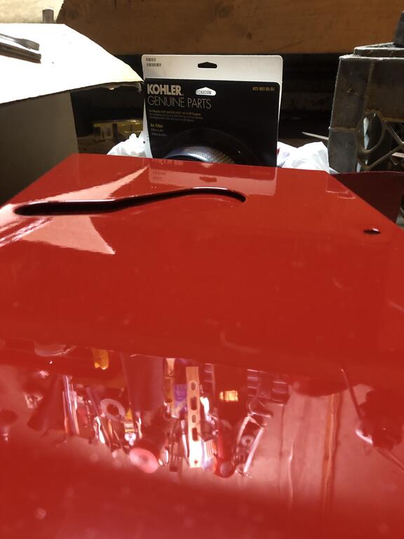

WheelhorseBob 1,550 #24 Posted April 10, 2021 Well the 416 is almost done. Very happy with the HVLP gun! Unfortunately got a bug in it before I got it inside 😡 1 Share this post Link to post Share on other sites

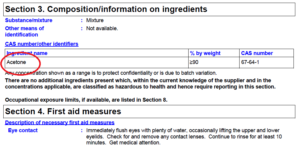

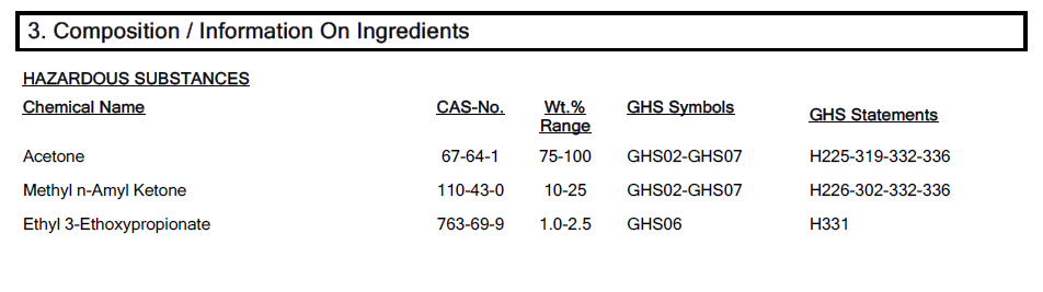

rmaynard 17,634 #25 Posted June 10, 2021 I know this topic is a little old, but I discovered something while reading the safety data sheet on a couple of enamel reducers. Here is a snippet pulled from Krylon and Rustoleum enamel reducers. KRYLON RUSTOLEUM Looks like Acetone is the ingredient in Krylon, and the major ingredient of Rustoleum. Considering how expensive reducer is in a name brand, why not just use acetone? 1 Share this post Link to post Share on other sites
