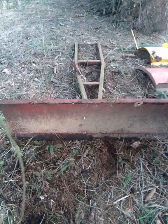

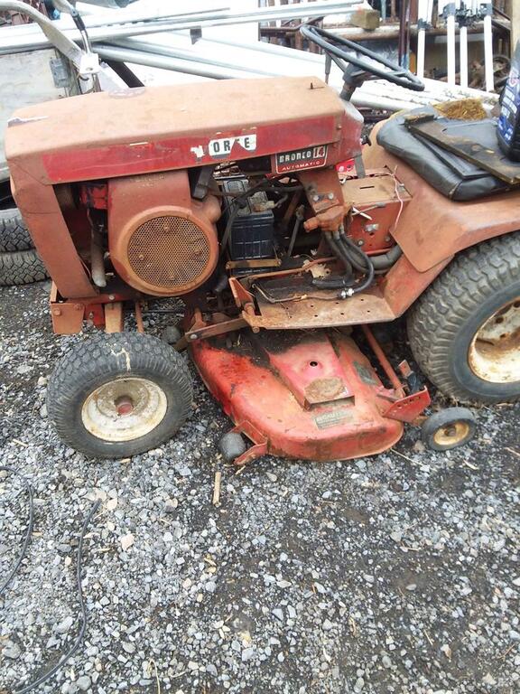

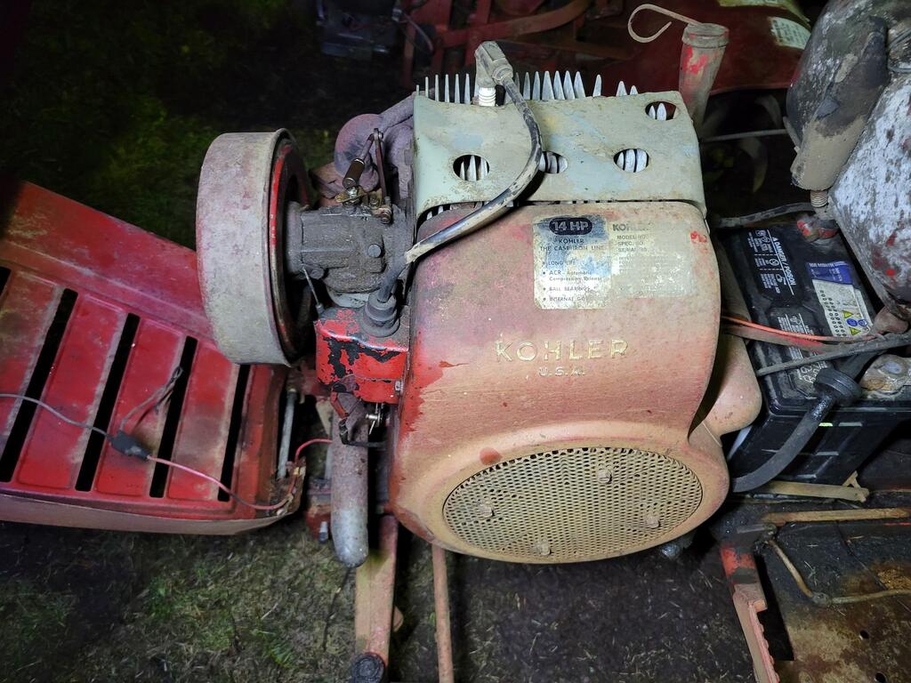

iam206 81 #1 Posted March 26, 2021 Hello Gentlemen, (yes I assumed your gender) New to the garden tractor world. I made a few purchases this spring. First is, and what is relevant to this forum, is a 71 Bronco 14. Ill see what I can do to figure out how to post pic.. It is in running condition, but will need some attention. first it needs a carb cleaning and then the ignition system addressed. so I will need to pick some brains around here as to where I can find info on here as to a thread on how to go about that. I looked threw the owners manual section and didn't see my model tractor so any help with that would also be appreciated. I bought a front "a frame" plow blade for it, little unsure if I got the right set up. I think I am missing some bracketry to attach to the hydraulic lift I did get a rear bracket for the axle though, so I will need some info on that and how it hooks to the hydro. I am missing the rear lift bracket and a cable, but don't know what I am looking for in a bracket??? I want to run a box blade of some sort on the rear. I plan to dig up and re-stone my driveway this spring. I ran it around the yard some today, The motor ran decent, has some backfiring on occasion and a slight miss, hence my need to address that, but overall good test drive. Learning the controls. The drive belt to the hydro trans is quite noisy when engaged so, I need to investigate that and do general maintenance to pulleys ect. . The steering is a little loose at the rack and pinion area so a fix is needed for that, I am also suffering from a lack of braking system. the pedal moves the hydro drive lever back to the neutral position, but is it supposed to have an actual brake??? the hydro lever is quite sensitive around neutral also, like the neutral creeps forward so i pull back slightly and it takes off in reverse. Don't know if I am explaining that properly. I am also i need or a repair idea on one of the hydraulic lines to the front of the lift piston. it was repaired with a piece of coper and is leaking. so I need the fitting replaced at the piston and a hydraulic hose, or a cleaver repair idea. So yea, it runs and drives, but needs attention to almost everything :) I think I have enough questions for my first post on here. so try not to beat me up too much. Thanks, David. The sears 12 is the other tractor I bought. but that is another story for a different forum. 1 2 Share this post Link to post Share on other sites
8ntruck 9,292 #2 Posted March 26, 2021 (edited) to the forum. Lots of good folks here who are willing to help. If you've got questions ask away. Somebody will be along who has seen whatever problem you have and has solved it. A carb rebuild on a Kohler is very easy. I use spray carb cleaner and torch tip cleaners (gently!). Takes less than an hour, unless the carb is really filthy and needs soaking. My local hardware store stocks the rebuild kits for the carb for somewhere between 10 and 20 bucks. One thing you will want to check on the carb is for excessive play between the throtitle shaft and the carb body. If it is loose, it can be repaired with brionce bushings typically available in the small parts drawers in the hardware store. Something else you should consider is changing the fluids in the engine and transmission. New air and transmission filters are a good idea too. A trip around the tractor with a grease gun won't hurt either. Doing this gives you a known starting point for your maintenance. While this is primarily a Wheel Horse site, we also enjoy other brands. Go ahead and post about your Sears in the alternate brands section of the forum. Good luck and have fun. Edited March 26, 2021 by 8ntruck 7 Share this post Link to post Share on other sites

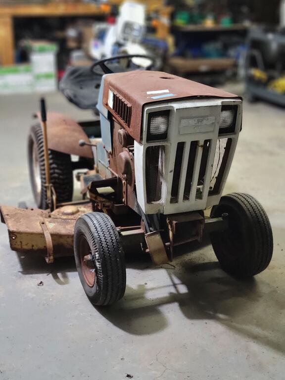

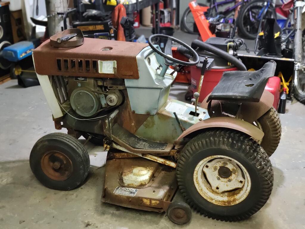

Pollack Pete 2,273 #6 Posted March 26, 2021 Love it.Looks like a good project.Also love the Sears tractor.Have fun with your new toy. Share this post Link to post Share on other sites

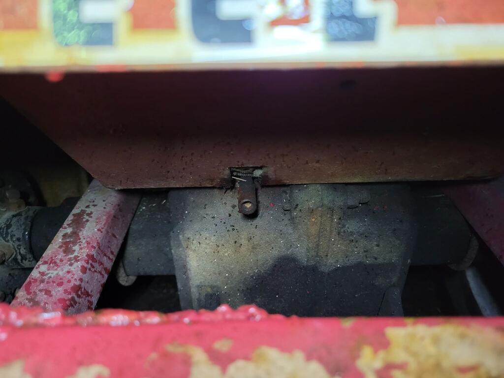

gwest_ca-(File Mod) 12,483 #7 Posted March 26, 2021 Welcome to the forum. The ID plate can be seen under the dash in the 2nd photo you posted. Post those numbers and will add them to the list. This link will take you to 21 files on the model 1-0420. There was also a model 1-0421 in 1971. https://www.wheelhorseforum.com/search/?&q=1-0420&type=downloads_file&search_and_or=or&sortby=relevancy Garry 3 Share this post Link to post Share on other sites

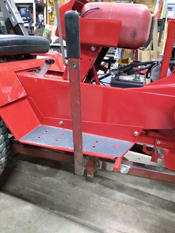

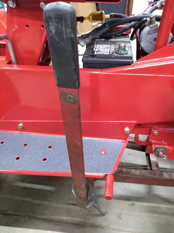

Achto 32,633 #13 Posted March 26, 2021 (edited) A few friends and I did a resto on a Bronco 14 last winter for a friend of ours. Here are some pictures of the end result. Edited March 26, 2021 by Achto 8 4 1 Share this post Link to post Share on other sites

Ed Kennell 47,266 #17 Posted March 26, 2021 6 hours ago, Achto said: A few friends and I did a resto on a Bronco 14 last winter for a friend of ours. Here are some pictures of the end result. Ha Dan, got any close ups of that blade angle lever arrangement....unique custom. Is that a short plow framw on a long frame tractor? Share this post Link to post Share on other sites
Achto 32,633 #18 Posted March 26, 2021 (edited) 1 hour ago, Ed Kennell said: Ha Dan, got any close ups of that blade angle lever arrangement....unique custom. Is that a short plow framw on a long frame tractor? It's a custom set up for sure. Needed to accommodate for a limited reach. The plow frame was originally for a short frame tractor. It was stretched to fit this Bronco 14, pivot handle placement was moved, and a custom cable set up to pull the lock pin. When finished, it worked very smoothly. Edited March 26, 2021 by Achto 3 1 1 Share this post Link to post Share on other sites

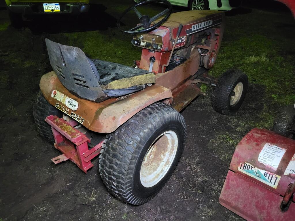

iam206 81 #20 Posted March 26, 2021 Soooo, I have been looking for hitches and stuff, got a question. If I find and install one of these clevis hitches... Can I run a box blade like this one??? Or a cultivator? Since I have no hitch and no cable, what do I need and from what donor tractors? Thanks, David. 1 Share this post Link to post Share on other sites
R Scheer 524 #21 Posted March 26, 2021 I'd check with Lowell at Wheel Horse Parts and More. I purchased his hitch kit, well made and had all pieces required. Otherwise you can post on the classified section of the forum. 2 Share this post Link to post Share on other sites
953 nut 69,147 #22 Posted March 26, 2021 2 hours ago, iam206 said: I have been looking for hitches and stuff, got a question. If I find and install one of these clevis hitches... Can I run a box blade like this one??? Or a cultivator? Since I have no hitch and no cable, what do I need and from what donor tractors? https://wheelhorsepartsandmore.com/ Lowell has everything you need, take a look. 1 Share this post Link to post Share on other sites
Searcher60 209 #23 Posted March 26, 2021 27 minutes ago, 953 nut said: https://wheelhorsepartsandmore.com/ Lowell has everything you need, take a look. Is the Brinly style hitch like shown in his picture considered superior to the cast iron genuine Wheel Horse hitch? Or, is the Wheel Horse hitch superior? Thanks. 1 Share this post Link to post Share on other sites
Achto 32,633 #24 Posted March 27, 2021 1 hour ago, Searcher60 said: Is the Brinly style hitch like shown in his picture considered superior to the cast iron genuine Wheel Horse hitch? Or, is the Wheel Horse hitch superior? The Wheel Horse slot hitch is designed for the use of Implements that were sold by Wheel Horse. A Brinly sleeve hitch will allow you to use a wider variety of implements. Both are equally strong in my opinion. 2 Share this post Link to post Share on other sites
iam206 81 #25 Posted March 27, 2021 18 minutes ago, Achto said: The Wheel Horse slot hitch is designed for the use of Implements that were sold by Wheel Horse. A Brinly sleeve hitch will allow you to use a wider variety of implements. Both are equally strong in my opinion. OK, trying to understand. Was what I pictured not a wheel horse hitch? ...and a Brinly hitch is bigger? Thanks, David. Share this post Link to post Share on other sites
