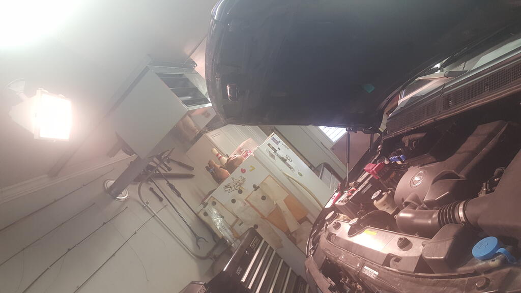

Gregor 4,848 #6 Posted March 24, 2021 I think I am going to go with T-8, 34W, Daylight, 5000 Kelvin(whatever that is), 4400 Lumen. I have high output bulbs now, so the sockets have to be changed anyway. Speaking of Lights........... I have 3, 500W floods mounted on the ceiling of my garage at the front. Now when I raise the hood, I am not left in the dark. Share this post Link to post Share on other sites

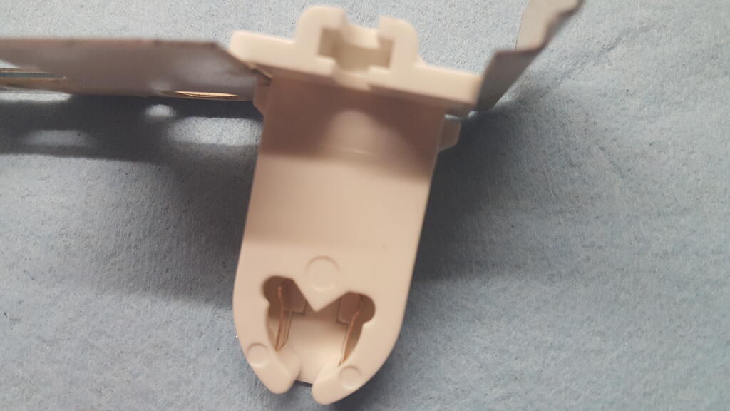

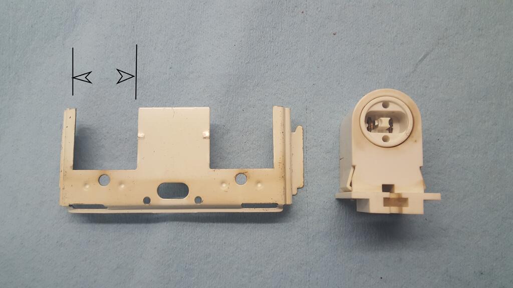

Gregor 4,848 #17 Posted March 26, 2021 Well my luck continues to hold out as usual. Seems you can't simply switch an 8', T-12 light fixture, to T-8. The light socket, (or dome as they call them) is not as wide for a T-8 as for a T-12. The socket will not fit the socket holder. Now I have 8 bulbs and 16 sockets that have to go back. Never mind that this store is 45 miles away! My wife is going to be sooooo happy. On the upside. When she gets the credit card bill for this month, I may not live long enough to have to install them. Every cloud has a silver lining, 1 Share this post Link to post Share on other sites

WHX?? 58,308 #20 Posted March 26, 2021 (edited) Somethin ain't right here Gregor - Should have almost been plug & play. I already have the correct single button tombstone socket as they are called. You can also get the single button sockets or two pin tombstones fairly cheap. It's odd they didn't fit ... pretty much universal. (12-Pairs) JESLED Single Pin FA8 Tombstone - Non-Shunted T8/T10/T12 LED Socket Lampholder Base Holder for 8FT Fluorescent Tube Light, Retrofiting Bulbs Fixtures, Flameresistant Plunger, UL Listed - - Amazon.com These are what I ordered between my sheet metal shop, warehouse and home shop I ordered at least 50 with no issues. Well I did have a few bad ones but they sent replacements right out no questions asked. CNSUNWAY LIGHTING 8FT LED Bulbs, 45 Watts, 5000K Daylight, Ballast Bypass, 4800LM, Frosted Cover, Replace Old Fluorescent Light Fixture -12 Pack - - Amazon.com Edited March 26, 2021 by WHX24 Share this post Link to post Share on other sites
Gregor 4,848 #21 Posted March 26, 2021 3 minutes ago, WHX24 said: Somethin ain't right here Gregor - Should have almost been plug & play. I have been told thisarea is wider on a High Output fixture, and domes are not interchangeable. I don't know if it's true or not. I don't even have another florescent fixture around here to compare to. I am going to the store myself, and see what's what. I'm just sitting here waiting on parts anyway. Share this post Link to post Share on other sites

WHX?? 58,308 #23 Posted March 26, 2021 If you have those sockets they are antique.... these won't work? Share this post Link to post Share on other sites
Gregor 4,848 #24 Posted March 26, 2021 Who you calling antique? The fixtures I have are 10 - 12 years old, I think. But us antique guys don't remember well. This could get cashy. 1 1 Share this post Link to post Share on other sites
Gregor 4,848 #25 Posted March 26, 2021 (edited) As usual, this just got more complicated as I went. I found single pin sockets, to fit my present fixtures, and 8' LED bulbs to match. I thought I was doing good. I thought wrong ! Checking the box. Two, 8', 34W, LED bulbs is a total of 8800 lumen Two, 8', 110W, High Output, Fluorescent bulbs, 16200 lumen I have a total of 8, 96", High Output, Fluorescent bulbs in my garage. If I have done my math right, I would drop, 29600 lumen of light by switching to LED. I'm not willing to do that, if I don't have to. As things are, with my lights, and my hearing aids, I can both hear AND watch 2 gnats making out on the ceiling. (as you might imagine, that's not necessarily a good thing.) Now maybe LED light is somehow different, brighter, better, than fluorescent light, I don't know. Never had any. SOOOOO I bought an 8' LED integrated, (no bulbs) 8800 lumen light fixture, just to check it out. I can always use more light in my storage area anyway. I honestly did not think you could buy a ballast and high output bulbs any more. I was told years ago that ALL fluorescent bulbs were being fazed out, and would no longer be available. Obviously a salesman wanting to make a sale. You have any idea how many 8' fluorescent bulb are in a 48 lane bowling alley? A LOT ! Edited March 26, 2021 by Gregor Share this post Link to post Share on other sites
