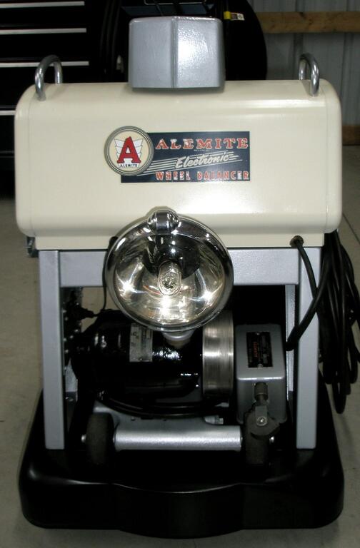

lynnmor 8,856 #24 Posted March 24, 2021 I have this on the vehicle balancer: The strobe light shows the position of the weight needed and the meter gives an approximation of the imbalance. After several retests, the balance can be brought in even better than the fancy balancers made today. Since brakes and bolt patterns are less than perfect, this balancer takes into account the entire rotating assemble. They haven't been sold for many years because the tire shops want fast and these take some time. In addition, the front wheel drives, all wheel drives and minimal clearance under todays cars make this balancer limited in application. The drive systems and large tires are quite a load to spin up to test. I use it for trailer tires, easy to use on them and trailer hubs and brake drums haven't been factory balanced in the past quarter century. I do get a kick out of the experts on RV forums thinking they are getting precision balancing on their trailers. I have had brake drums out of balance by 5.5 ounces. 1 Share this post Link to post Share on other sites
JoeM 10,053 #25 Posted March 24, 2021 1 hour ago, lynnmor said: The strobe light shows the position of the weight needed and the meter gives an approximation of the imbalance. Pretty nice machine, I used one 45 or so years ago in the garage where i worked. Like you pointed out it will balance the entire rotating unit. Plus, cord separation and out of round conditions are easy to find using those balancers. Share this post Link to post Share on other sites
