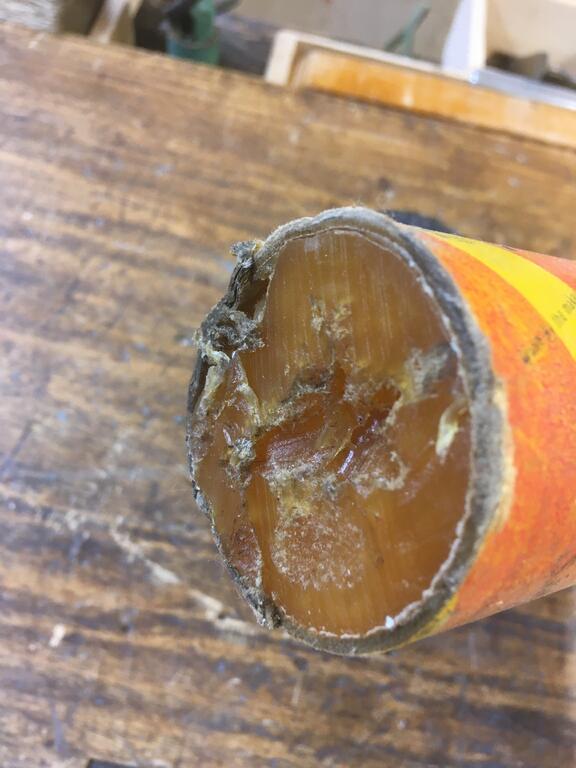

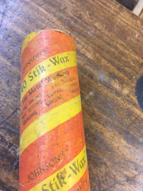

formariz 12,381 #3 Posted March 23, 2021 (edited) As it was mentioned it will be messy and not too effective since most of it will be thrown out by action of blade. I use instead a paste lubricant . The same type used on a circular blade to cut aluminum. It comes in a tube and one merely holds it against the side of the turning or moving blade. It will stick to blade with heat then spreading it even further. Its main intended purpose is not to let aluminum stick to cutter while cutting but it does cool and lubricate things down substantially. I use it to cut or drill any metal where a liquid would not be practical. Its easy to use and relatively clean. Edited March 23, 2021 by formariz 9 2 Share this post Link to post Share on other sites

formariz 12,381 #8 Posted March 23, 2021 We need to remember that although carbide tipped blades will outlast all other blades, they still benefit and in many cases need a lubricant to perform well and last long. Even when cutting some woods they need a lubricant. In the case of woods such as pine which is highly resinous one needs to apply a dry lubricant so blade does not get caked up with resin and overheat essentially rendering it useless. It is also a safety issue. Some other materials such as aluminum and any type of plastic such as Plexiglass will adhere themselves to the gullets on the blades creating an absolute dangerous situation if not addressed with the proper lubricant. Besides saving the blades, the lubricated blade will also leave a flawless finished cut where the non lubricated blade will leave a rough ragged cut. This is most obvious with aluminum and Plexiglass but also obvious with any wood. I have a lubricant stick next to every single machine I have and constantly use them. 4 1 Share this post Link to post Share on other sites
