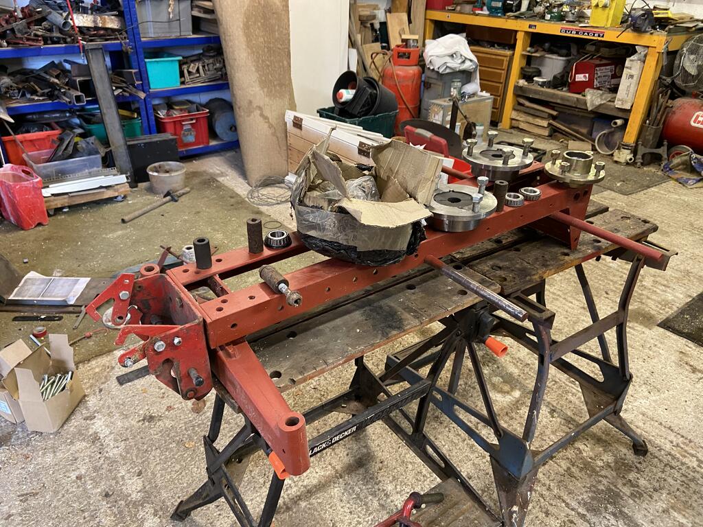

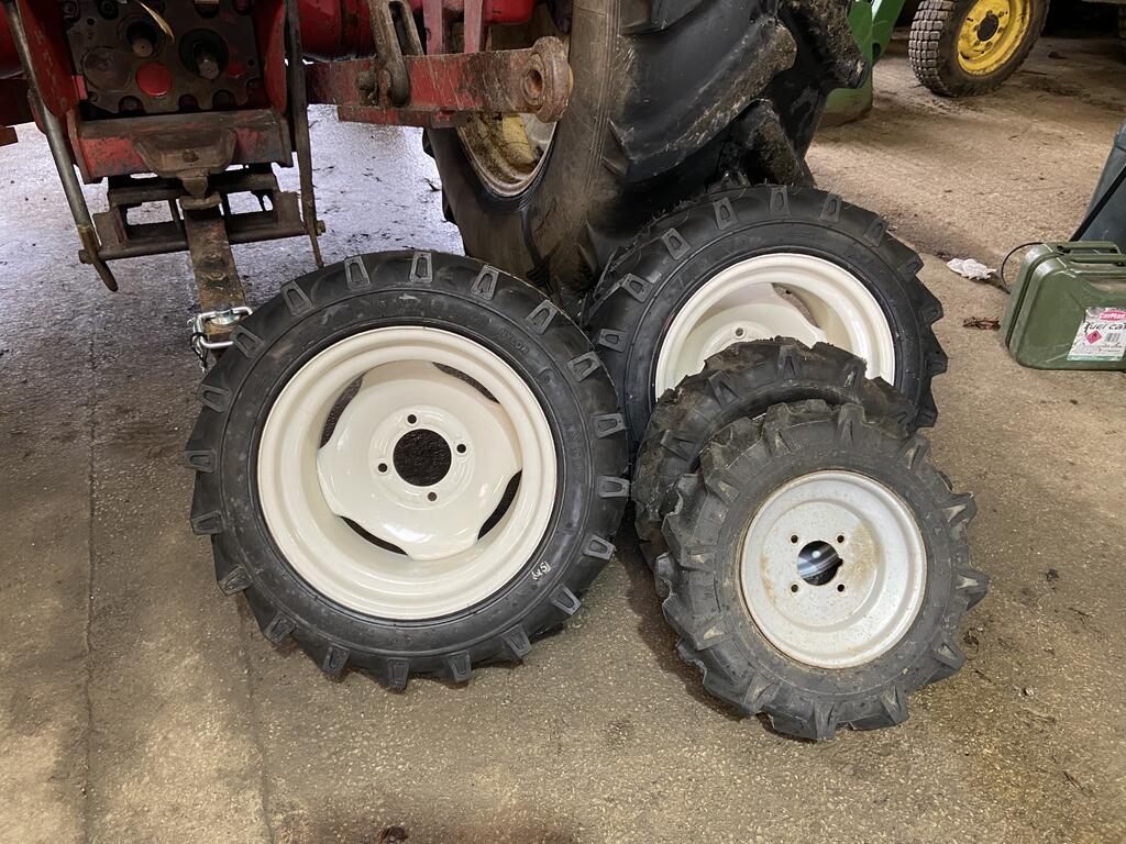

meadowfield 3,191 #1 Posted March 22, 2021 I know you can buy a C-195.... but not here in the UK - and besides, what’s the fun in buying when you can make your own so starting with a gearbox and frame - I’m adding the bits. Big front wheels and GT-14 rears. 7 11 2 5 Share this post Link to post Share on other sites

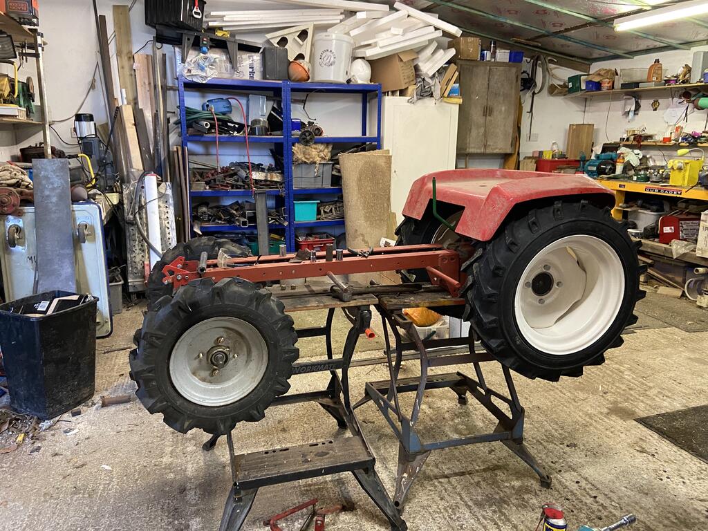

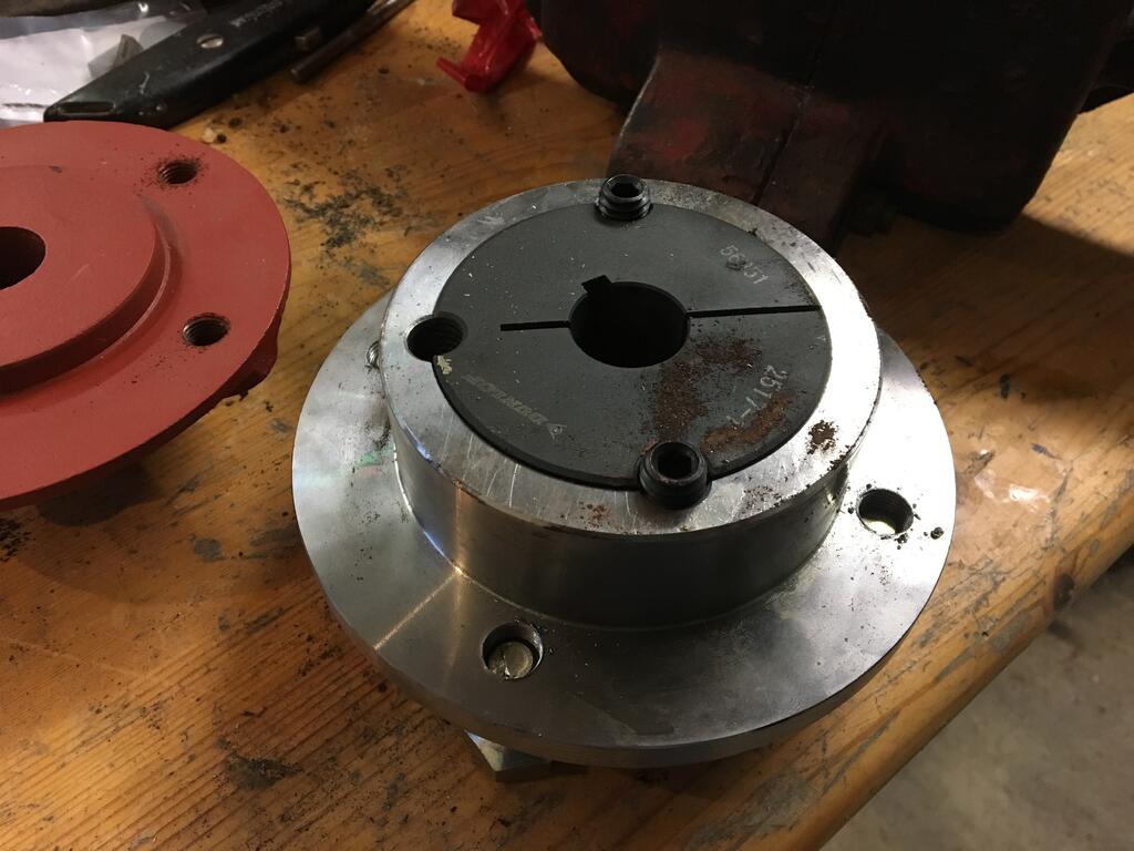

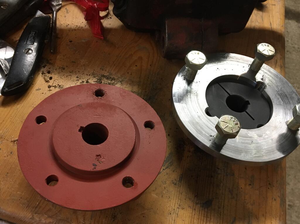

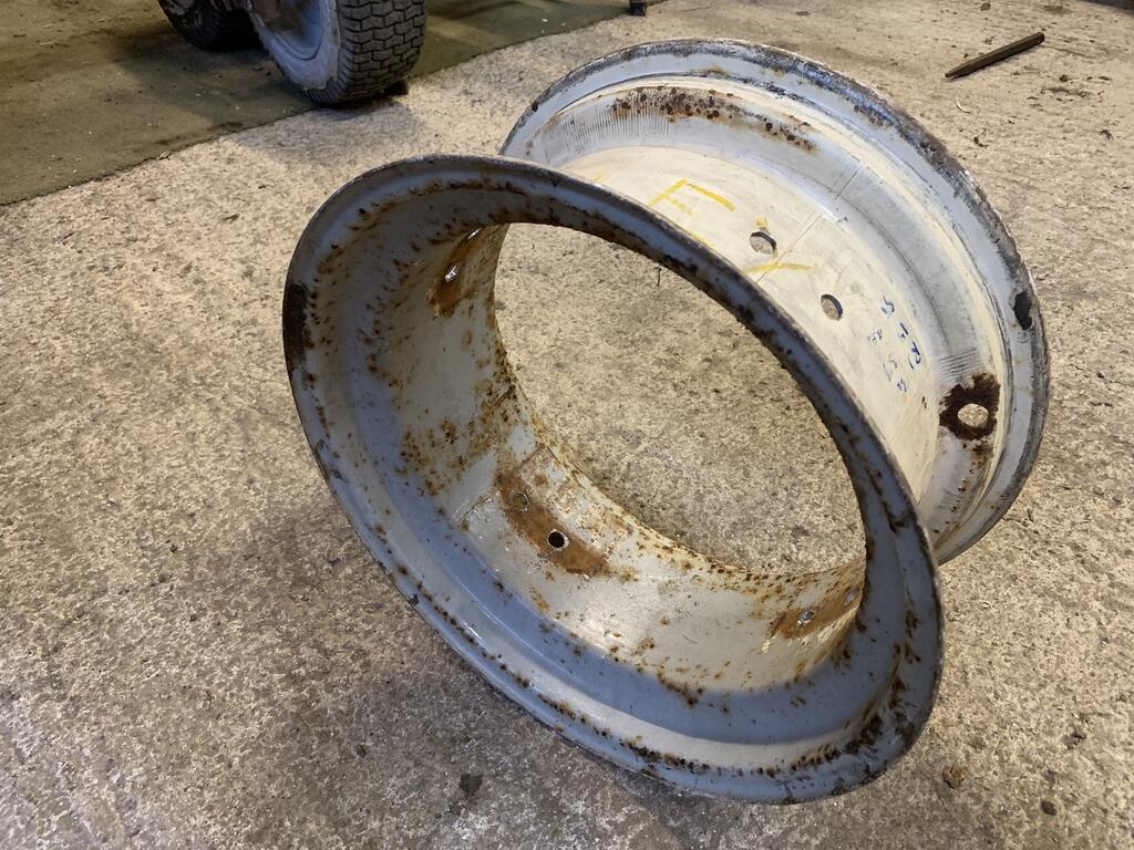

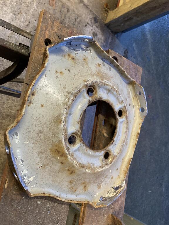

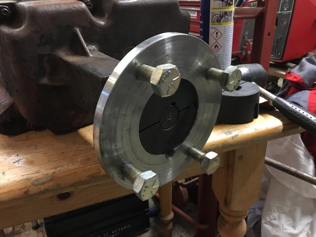

meadowfield 3,191 #7 Posted March 22, 2021 (edited) before I miss some pictures and progress, best add a little more detail. I didn't have any GT14 hubs, and besides they won't fit a manual trans. So made my own... I don't think these are going anywhere soon, I think they should work well. Once I bolted the wheels one, theres a snag - the offset it wrong and it is about 26 inches wide at the rear! So off with the tyre and drill the spot welds out to move the centres. this was tedious - but needed doing. It now looks to sit a little better - also put 10" wheels on trailer hubs at the front to balance it. Edited March 22, 2021 by meadowfield 6 17 1 Share this post Link to post Share on other sites

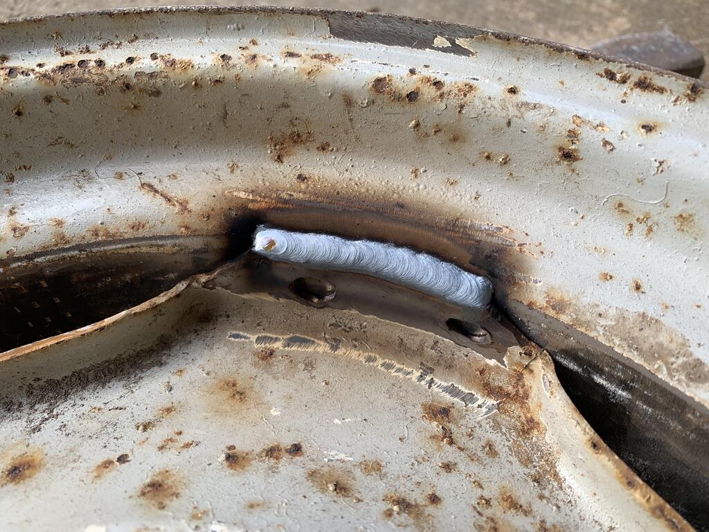

8ntruck 9,310 #19 Posted March 22, 2021 1 hour ago, Jeff-C175 said: That's a right nice looking bead! That's not ALL of it though, or is it? You going to fill in the holes I imagine? Actually, if you had enough press fit between the disc and rim, the holes won't hurt anything. The speeds and loads the wheel will see in garden tractor service aren't that high, and the failure mode (if it ever does) will be a crack through the rim causing air loss. Well, they would create a place for dirt/grunge to collect and start a rust spot. Share this post Link to post Share on other sites
Jeff-C175 7,211 #20 Posted March 23, 2021 2 hours ago, 8ntruck said: the holes won't hurt anything. That wasn't really my concern though. I would not trust a single weld on the leading edge of that flange. That weld is going to crack, sooner or later. In fact, I think I already see a crack: Then, there's the appearance aspect. 1 Share this post Link to post Share on other sites
DennisThornton 4,773 #21 Posted March 23, 2021 11 minutes ago, Jeff-C175 said: That wasn't really my concern though. I would not trust a single weld on the leading edge of that flange. That weld is going to crack, sooner or later. In fact, I think I already see a crack: Then, there's the appearance aspect. Good catch! Certainly a crack but a good time to fix it. 2 Share this post Link to post Share on other sites
8ntruck 9,310 #22 Posted March 23, 2021 Yup, that is a crack. That one will grow towards the center of the wheel. It will grow more quickly when the wheel is subjected to side forces - like when turning a corner. If all you ever did was drive in a straight line, it might not grow at all. For use on a garden tractor, a good repair would be to vee the crack, then run a weld bead in it. 2 1 Share this post Link to post Share on other sites
meadowfield 3,191 #23 Posted March 23, 2021 (edited) thanks for the comments so far guys, re: the crack - there are small stress cracks on the tight bends as the centre was pressed. It's a thick piece and heavier than it looks. Rather than make it look welded I left them as is as they were probably shipped that way. As for welding along that edge, I have a few sets of wheels that were assembled and welded in the same place. In particular the rear wheels on my 4x4 which are 12x12 and I had to move the centres. I cut the original weld and just moved the centre. Now that horse has been up and down stairs, through creeks, even rock crawling, so I trust my weld Love the attention to detail though. Edited March 23, 2021 by meadowfield 9 Share this post Link to post Share on other sites
