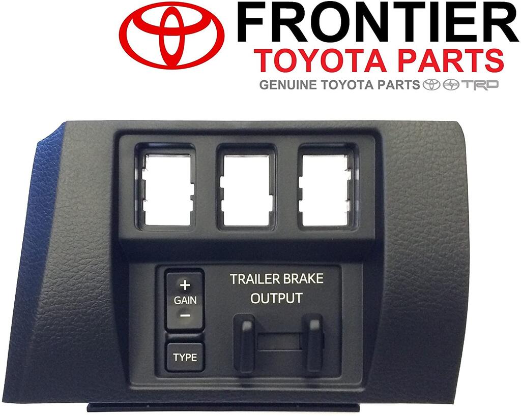

Achto 32,795 #4 Posted March 22, 2021 (edited) Look your dash over. If you have factory installed trailer brake control you will find some thing similar to this on your dash. Nissan's may look a little different but there will be some type of adjustment knobs/switches labeled "trailer brake". If you don't find any thing like this then you'll have to install a controller. With the correct harness adaptor this should be a plug & play installation. I like a controller with a digital read out. I pull a few different trailers and the read out allows me to set the brakes for the trailer I'm pulling. Example - 22ft flat bed trailer. I set the number to 25 empty and 35 loaded. This one is just an example of one with a digital read out on it. https://www.amazon.com/Reese-Towpower-8508211-Proportional-Brake-EVN/dp/B01M59QRWK/ref=asc_df_B01M59QRWK/?tag=hyprod-20&linkCode=df0&hvadid=312153119455&hvpos=&hvnetw=g&hvrand=14249982300988350604&hvpone=&hvptwo=&hvqmt=&hvdev=c&hvdvcmdl=&hvlocint=&hvlocphy=9018899&hvtargid=pla-457188737714&psc=1 Edited March 22, 2021 by Achto 1 Share this post Link to post Share on other sites

Gregor 4,848 #7 Posted March 22, 2021 1 minute ago, Achto said: Look your dash over. If you have factory installed trailer brake control you will find some thing similar to this Nothing like that Share this post Link to post Share on other sites
