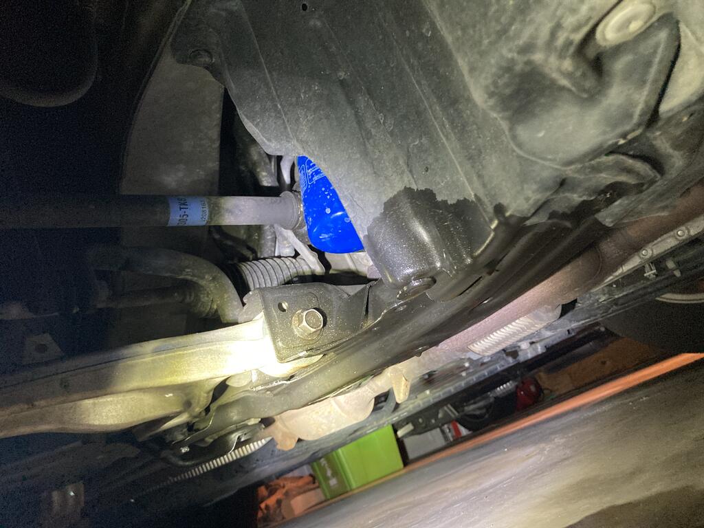

wh500special 2,454 #1 Posted March 22, 2021 (edited) Usually I do all of my own simple maintenance on my cars. I drive fairly new vehicles, so really they don’t need much attention. About a week ago my 2016 Honda van started asking for an oil change. I’ve been busy and a local dealer was running a $30 special so I figured I’d let them do it. They’re professionals of course. So, made an appointment and my wife dropped in and waited on it last Friday. They were done in about an hour. Oil change and tire rotation. They of course recommended all kinds of other services that I declined. Later that Friday night I decided it was worth popping the hood to make sure the oil level looked ok...just in case. Opened the door and found a big greasy black footprint on the gray plastic door sill. Great. Cleaned that up. Mostly. Some of it is stained permanently. Pulled the dipstick. Seemed ok. Looked underneath and saw a few drips of oil on the chassis and on my garage floor. Figured they probably just spilled a little oil changing out the filter so cleaned it up. Monday they sent an email survey. I noted the oil spillage and the greasy footprint. Kind of thought there would be a follow up, but there wasn’t. No big deal, stuff happens. We did some running around to enjoy the weather yesterday. Filled the tank and checked the oil. Still good. Figured all clear. Drove home and parked overnight. Today i was working in the garage. Retrieved a screwdriver from my toolbox that is right in front of where the van sleeps at night. Dropped it on the floor. Oops. when I kneeled down to retrieve it from under the van I see it had narrowly missed falling into the puddle of engine oil on the floor. Pictures below. Not Exxon Valdez level spill, but still quite the mess. Seems the professionals didn’t bother to tighten the oil filter. It was loose enough that it wiggled on its stud. I tightened it about a turn and a half by hand. I added a half quart of oil to bring the level back up. Thankfully, it must not have been super loose until pulling in the garage or we’d be testing how good their service department was at installing a new engine. Judging by this and previous experiences in their service department, I have my doubts. Now, I realize that the guys changing the oil probably aren’t the most experienced or senior guys but this is pretty basic stuff. I wonder what the story will be when I talk to them tomorrow. I also hope whoever comes to clean my garage floor is friendly. So much for convenience. better go check the lug nut torque... Steve Edited March 22, 2021 by wh500special 1 12 Share this post Link to post Share on other sites

Jeff-C175 7,211 #4 Posted March 22, 2021 1 hour ago, wh500special said: better go check the lug nut torque... 200 ft lb guaranteed. 2 Share this post Link to post Share on other sites

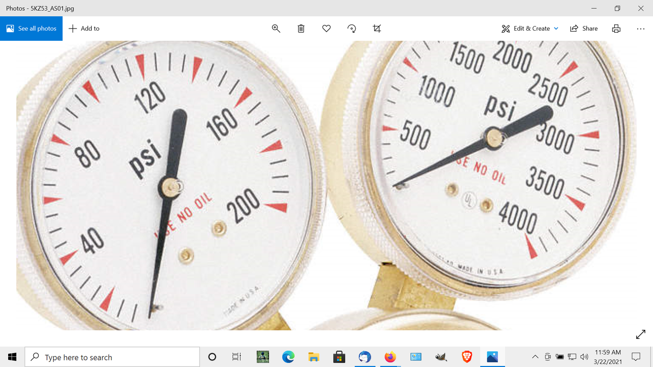

bc.gold 3,406 #23 Posted March 22, 2021 (edited) One day I take in a load of scrap and the yard forman is trying to unclog a diesel fuel line, I ask Bob if he would wait until I leave before continuing. He's at least curious enough to ask why. I point to the gauges on the oxygen bottle to where it says ( USE NO OIL ) and that diesel fuel is an oil which could react violently with an oxidizer. Edited March 22, 2021 by bcgold Share this post Link to post Share on other sites
