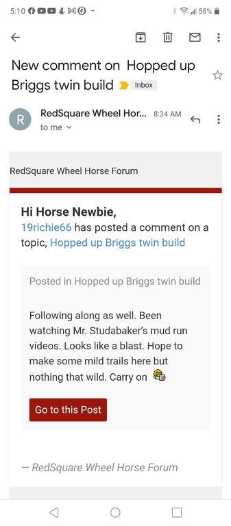

Horse Newbie 7,405 #58 Posted July 9, 2021 (edited) On 7/7/2021 at 4:13 AM, Greentored said: Why is there not a place for others to "like" or put up a smiley face on my posts? I know sometimes when I don't see the "reaction" emojis, I need to scroll down the page and log in...I guess because I usually come to Red Square through an email notification, and sometimes I guess I have lost my last log in. Edited July 9, 2021 by Horse Newbie 1 Share this post Link to post Share on other sites
ebinmaine 81,139 #59 Posted July 9, 2021 4 minutes ago, Horse Newbie said: log in I never log out!!! 1 Share this post Link to post Share on other sites
Horse Newbie 7,405 #60 Posted July 9, 2021 (edited) 14 minutes ago, ebinmaine said: I never log out!!! Me either...I usually just hit the email notification...hit "go to this post", and it goes to Red Square...but sometimes (don't know why), I have to log on... Edited July 9, 2021 by Horse Newbie 1 Share this post Link to post Share on other sites
