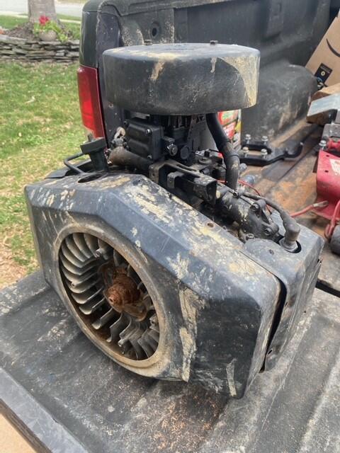

Greentored 3,221 #1 Posted March 18, 2021 (edited) Been having a RIOT on the B1 Bomber, and the stock, yet tired K321 has been great and offers more than enough power for getting up the hills and building some wheel speed for getting through slop. However, I miss that opposed twin snarl my 520H had. Certainly cant afford an Onan, but along comes a 18hp Briggs flatty on marketplace, running, for 60 bucks. Now, yanking a good Kohler off a Horse and replacing it with a Briggs seems like blasphemy to me, but after much consideration, I came up with the "I'm saving a good Kohler from possible death" excuse- so the Briggs build begins. There's not a lot of info out there on hopping these up, but I did find a couple limited conversations about oiling mods, as these are a splash system. Being that we offroad guys see some seriously steep hills and off camber situations quite often, oiling mods are an absolute requirement in my book. So far I've pulled the pan and checked the rods and crank and they are perfect, and a couple parts are ordered, stay tuned as this build progresses! Edited March 18, 2021 by Greentored 4 4 Share this post Link to post Share on other sites

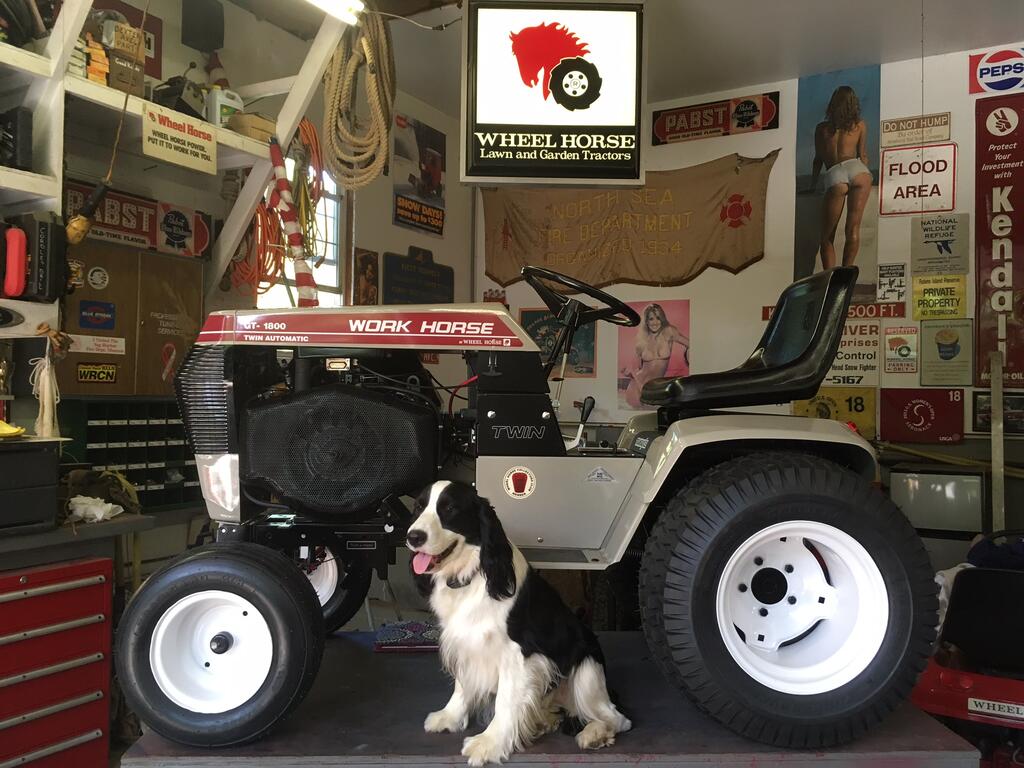

cschannuth 3,821 #4 Posted March 18, 2021 (edited) 1 hour ago, Greentored said: Kohler off a Horse and replacing it with a Briggs I wouldn’t be too upset. Wheel Horse had to do the same thing in 1978, ha ha. It’s still all original and running strong after all these years. I don’t know if my dad was just lucky but he mowed our yard with this thing for decades and it was so steep he probably shouldn’t have been on a garden tractor and he never had any issues with it. Edited March 18, 2021 by cschannuth 3 2 Share this post Link to post Share on other sites

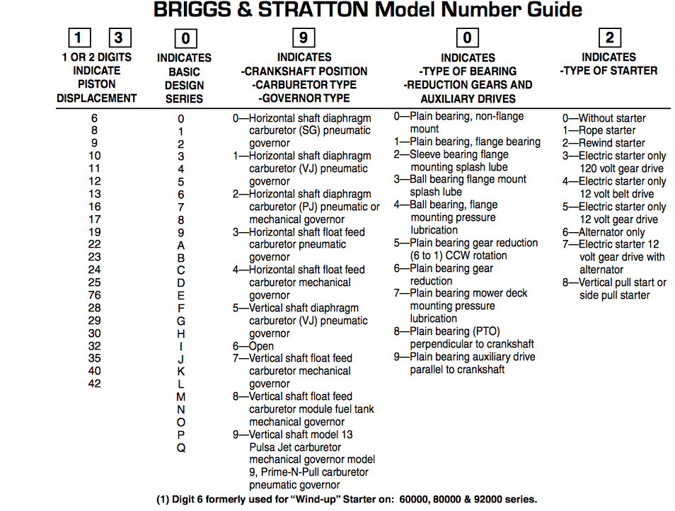

bds1984 1,519 #9 Posted March 18, 2021 2 hours ago, Jeff-C175 said: I've got an 18HP Briggs twin on an old pressure washer (BIG! pressure washer!) that I don't use anymore. I wonder if it's the same one that WH used and if needed, could I swap the KT out with the Briggs. Any particular engine numbers I should be looking for? If you want to use the Briggs engine with a Wheel Horse PTO, the second to last character in the model number needs to be a 3 or a 4. Those numbers will tell you that engine has ball bearings on the PTO; 3 is is splash lube and a 4 is pressure lube. I had a 424437 I regret selling as I needed it for a 312-8 that was sans motor. Chances are that if the engine is a horizontal 18 hp twin, it has ball bearings on the crank but better be safe to check. 4 1 Share this post Link to post Share on other sites
bds1984 1,519 #10 Posted March 18, 2021 Also, I wouldn't have any shame running a Briggs flat twin in place of a Kohler. I love my K, Magnum, and Command series, but the Briggs Twins are good engines, too. They received a bad rap from being installed in cheap lawn mowers in the 80s and 90s and being sold to cheap owners who never maintained them properly. 3 1 Share this post Link to post Share on other sites
Jeff-C175 7,211 #11 Posted March 18, 2021 (edited) 9 minutes ago, bds1984 said: I had a 424437 OK! This one is a 422437 What does the "Basic Design Series" mean exactly? So since this one has the ball bearing, it could be used I think. Does the WH PTO assembly fit right on with no modification? This engine ran fine with one exception... it was hard starting and when I did manage to get it started it always seemed to run very lean. I rebuilt the carb but that didn't help. I stopped using that pressure washer because of this, can't be fiddling with an engine when I'm on a job! Sounds like a job for this coming spring to get that thing going again! I'm sure there must be a thread I can search where someone has already done this research... Edited March 18, 2021 by Jeff-C175 1 1 Share this post Link to post Share on other sites
Charbs152 257 #12 Posted March 18, 2021 6 minutes ago, Jeff-C175 said: OK! This one is a 422437 What does the "Basic Design Series" mean exactly? So since this one has the ball bearing, it could be used I think. Does the WH PTO assembly fit right on with no modification? I'm sure there must be a thread I can search where someone has already done this research... i beleive that is the generation of the motor. I have a 421437 in my C-175 and its a super early 80s engine from what i can tell. Theres a sticker on the engine that also says L-468950 which i am told means that the block has been re manufactured or something. 2 Share this post Link to post Share on other sites

Greentored 3,221 #20 Posted March 19, 2021 (edited) This particular one is a model 422437 as well- ball bearings AND an alternator under that flywheel, folks! No need for a PTO on mine, but looks like thats the one WH used for it This engine was on an old 1967 Roper- the cleanliness versus the rest of the machine AND any research done told me this was not original. Sure enough, its manufacture date is 1988. As for the 60 dollar steal, consider it payback for all the Horses I see you guys rescuing from junkyards and next to sheds for 50 bucks or even free. Anything under 300 down here in NC gets my serious attention, and chances are at that price it will be well used, have flat, dry rotted tires, and no mower deck. A complete, big block powered 70s model ready to go for 450-500 is a 'decent deal'. Edited March 19, 2021 by Greentored 4 Share this post Link to post Share on other sites

c-series don 12,656 #24 Posted March 22, 2021 In August of 1984 I bought a brand new Work Horse GT-1800 with the Briggs 18 hp you guys are talking about. I can personally attest this engine has several thousand hours on it. I used it commercially for almost ten years, mowing, lots and lots of mowing plus snow plowing and tilling many gardens. I still have this tractor and restored it a few years ago. The Briggs is still running strong and all I ever did was change the oil(a lot) and replace a few starter gears. As many of you guys know I own many Wheel Horse tractors and this would be the last one I would ever sell. I was a kid when I bought it and I remember like it was yesterday the owner of the dealership telling me as I sat on my new Work Horse, he said “Son, you take care of this tractor and your kids will drive it someday!” Damned if he wasn’t right,my kids did drive it and someday hopefully my grandkids will drive it. God bless American made Briggs and Stratton and Wheel Horse tractors. 4 4 2 Share this post Link to post Share on other sites

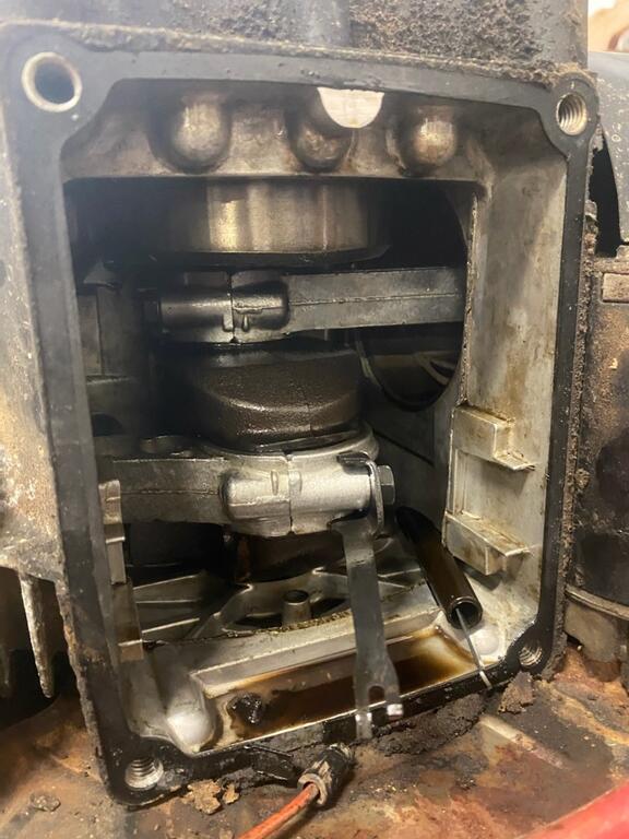

Greentored 3,221 #25 Posted March 23, 2021 Update: As per usual, a 'quick inspection' has turned into Pandora's box. Pistons are out to do the rod work, might as well hone and ring it. Valves are out to do some port cleanup and reface valves- exhaust valve guides are SHOT, like, not even acceptable for a trail bomb, so its getting exhaust guides. At this point, it should come completely down to be done correctly and clean, so waiting on the big brown truck to deliver rings, guides, and a full gasket set. Stay tuned! 4 1 Share this post Link to post Share on other sites
