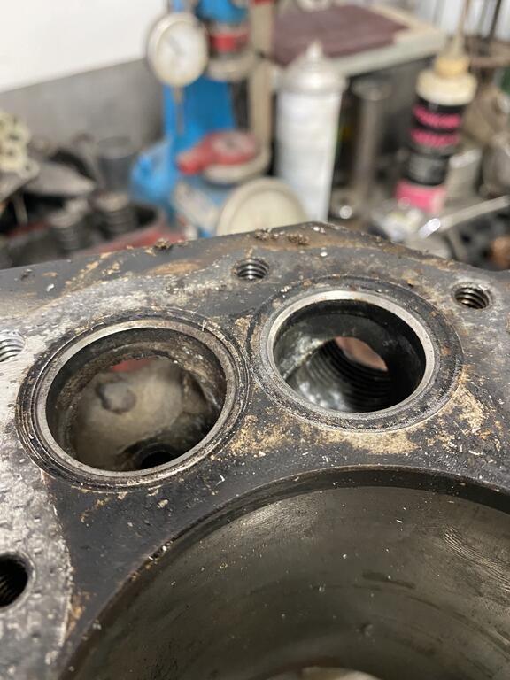

Greentored 3,220 #28 Posted March 25, 2021 On 3/23/2021 at 9:32 AM, ebinmaine said: Are you planing the heads on this one? The jury is out on that. Very little info out there on hopping these up, but the little bit I found says the opposed twins do NOT like compression, it kills the airflow and actually hurts them. This is also coming from guys who roundy round race them, which means high rpms, not bottom end grunt that Im going for. Personally cant see how pretty much any internal combustion engine will gain power with a compression bump, yet these dont? Right now, leaning toward milling them a small amount, and unshrouding the valve area like what was done on Hoss. 3 Share this post Link to post Share on other sites
ebinmaine 79,737 #29 Posted March 25, 2021 3 minutes ago, Greentored said: leaning toward milling them a small amount, and unshrouding the valve area I can't offer you any specifics on those Briggs twins either but my thought pattern is the same as yours. I wonder if the circle track guys are running an RPM range that requires a level of airflow that a milled head can't quite accomplish? I'm only guessing... 1 Share this post Link to post Share on other sites
Bill D 2,997 #30 Posted March 25, 2021 (edited) I not sure you can unshroud the valve area on that engine due to pressed in valve seats, if I understand correctly what you're talking about doing. Those engines have been known to lose valve seats like the Onans. I vote for milling the head slightly. Bill Edited March 25, 2021 by Bill D 2 Share this post Link to post Share on other sites
ebinmaine 79,737 #31 Posted March 25, 2021 15 minutes ago, Bill D said: Those engines have been known to lose valve seats Any thoughts on the cause? Do they run hot in one of the cylinders? 1 Share this post Link to post Share on other sites
Jeff-C175 7,209 #32 Posted March 25, 2021 24 minutes ago, Bill D said: Those engines have been known to lose valve seats I recently repaired a leaf blower for a friend that had the 8 HP Briggs single on it, and not too old either. In fact that engine had very low hours on it and maybe only 8 years old. It popped an exhaust valve seat! Apparently not too uncommon with Briggs. Loose fit? 2 Share this post Link to post Share on other sites
Greentored 3,220 #33 Posted March 25, 2021 No clue why these pop seats like the Onans, but I have heard of this as well. @Bill D the unshrouding will be done on the head itself, like this: 2 Share this post Link to post Share on other sites

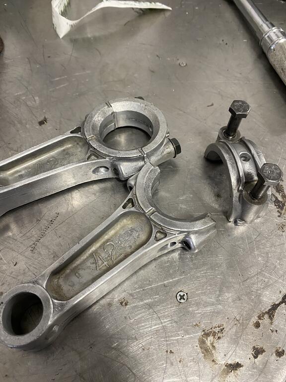

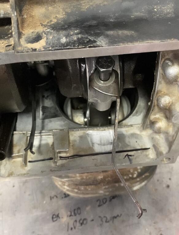

Greentored 3,220 #34 Posted June 9, 2021 (edited) Im back on the Big Briggs build! New bronze exhaust guides are done Oil holes added to rod caps, rods deburred, chamfered and cleaned up Block honed and new rings installed, with 2nd ring gap filed .002 wider than top ring. This keeps gasses from getting trapped between the rings and possibly unseating the top ring- likely not an issue with the rpms I plan to turn this thing, but..... Oil dipper mods: these splash lube engines had a single, bolt on rod dipper for 2400+ rpm, and a pair of them for under 2400rpm. I added the second dipper to splash more oil on off camber situations, but at the same time did not want it splashing a huge amount when I wind it up, so dipper #2 was modified to only touch about 1/2" of oil, and it will come into play more when things get into steeper side angles. Block was also ported and relieved- look at how nasty and restricted the factory ports were, especially the exhaust! Rumor has it opening up the ports pays off big on these, and I can see why! Stay tuned, much more to come! Edited June 9, 2021 by Greentored 2 Share this post Link to post Share on other sites

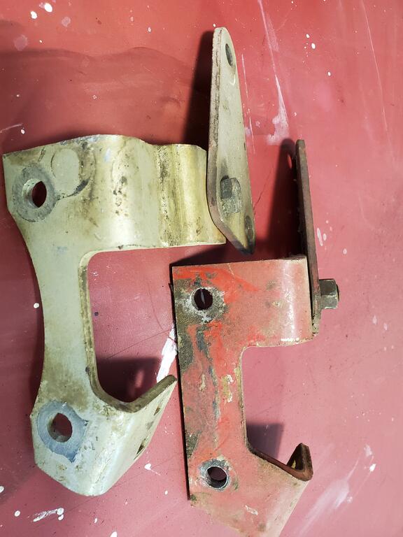

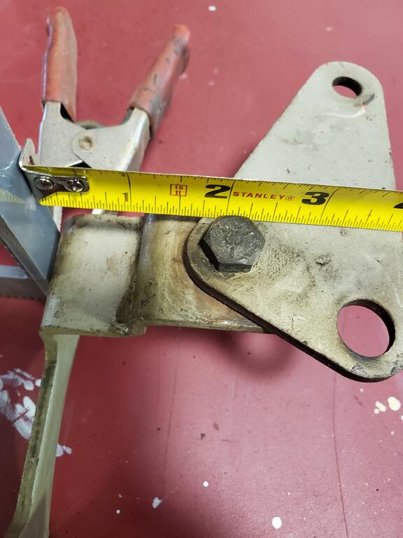

Thor27 891 #36 Posted July 5, 2021 (edited) the PTO bearing race is 1", same as a kohler 8. for the pulley, I plan to use an adapter and a 1-1/8 pulley here are some pics of the pto engine bracket with a kohler to compare. As or the linkages, i don't have them yet to compare. Edited July 5, 2021 by Thor27 Add pics from phone 1 Share this post Link to post Share on other sites

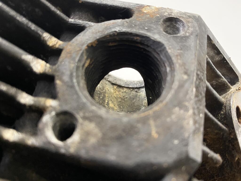

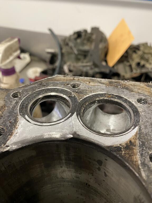

Greentored 3,220 #39 Posted July 7, 2021 Well heck, I better get updating then eh? Heres a few pics showing head work in rough in stage- they were angle milled .045 to retain some chamber size for flow and get the squish where I wanted it above the piston, then unshrouded a bit. Compression ratio 8:1 instead of in the 6s. Intake was split and ported, and made an adapter to run a Kohler command 25hp carb which is much larger, and has an accelerator pump. Some small mods to the pump circuit has it working awesome! Made my first attempt at a 2:1 pipe and collector, and it came out great. ( I also built a shorty muffler for it, more on that later.) Ignition timing was bumped up 2 degrees as well. The engine is in the machine and has been flawless! The power and throttle response are incredible- much more of both than ever expected! Stay tuned and I'll put up a video. 1 5 1 Share this post Link to post Share on other sites

Greentored 3,220 #45 Posted July 8, 2021 17 hours ago, ebinmaine said: @Greentored Thank you for updating this. Excellent work Scott. Very cool. I'm particularly impressed that you went to the trouble to split the intake. That's a new one to me. Yep, some of the early intakes were two piece, kinda like the Onans- made for easy port work. 2 Share this post Link to post Share on other sites
