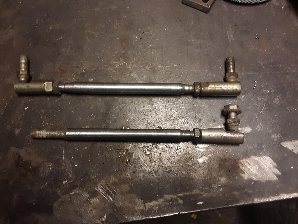

Thanks to a donor mower out back I almost have a set of tie rods. Picking up another end later today.

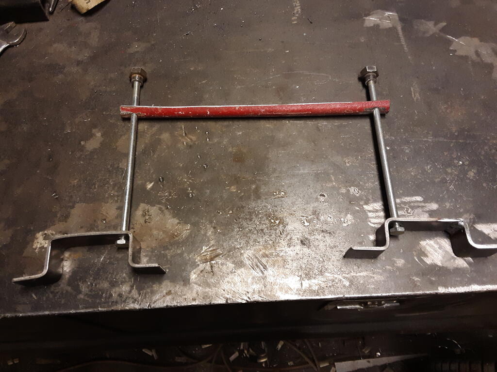

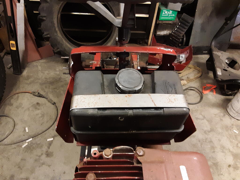

Getting a bit done today on Hiram. I had a chance to drill and thread some holes, built the battery hold down. Found a tank and made a strap for it and made an exhaust brace. Also it was time to write out a  check list. With alot of stuff down and not much finished it wa hard to keep track.

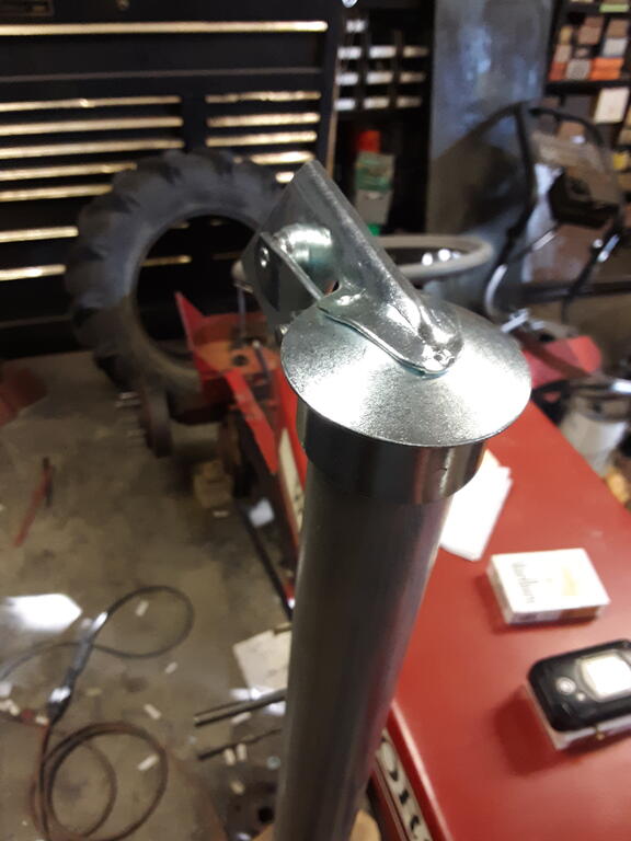

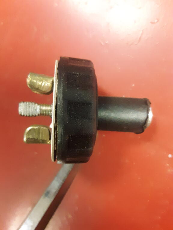

The rain cap showed up today. So that was installed. It came with an extra (odd) part

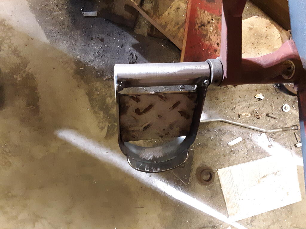

Also made some stirrups. I added a bit of a heel catch for when the wheelies happen.
  • Excellent 4
Why the rubber freeze plug?
What was the rain cap designed for??
Can you please PM me the link for those caps?
Oldskool
I have no idea why that was in with the rain cap. It's a mystery.
