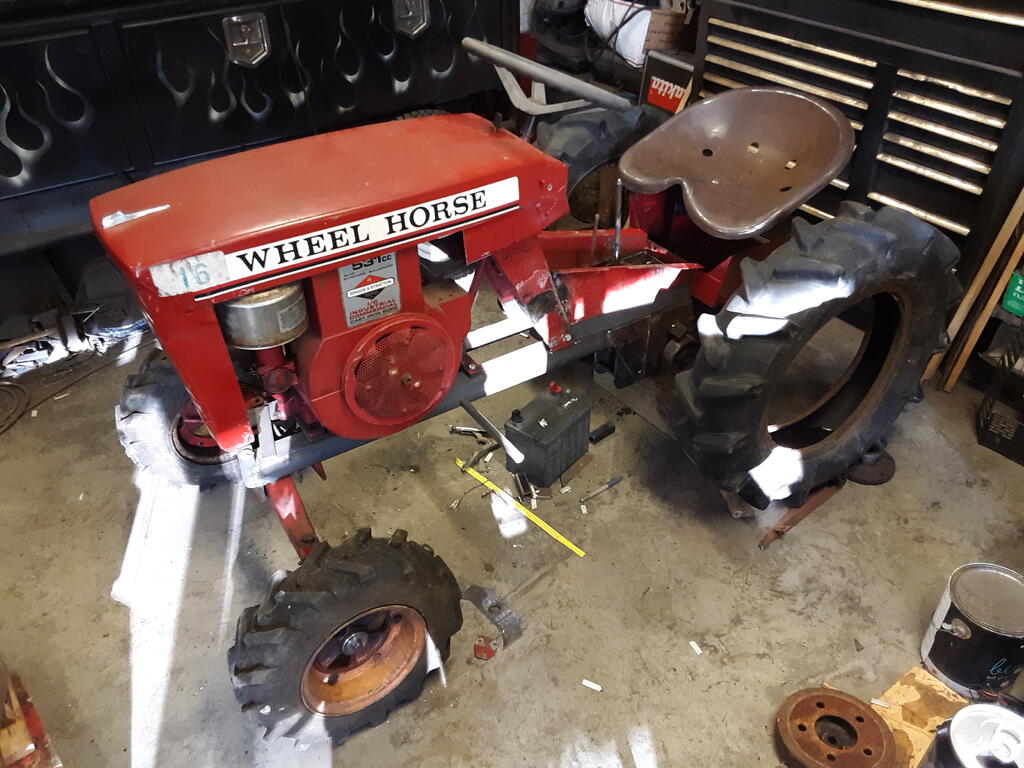

Oldskool
A Horse named Hiram
Oldskool

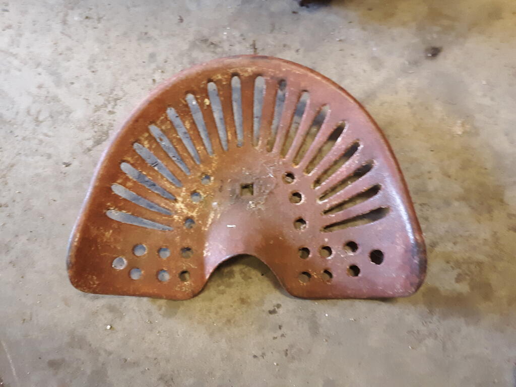

Well I had gathered up this seat for Hiram.....BUT.....the wife stole it for her tractor.

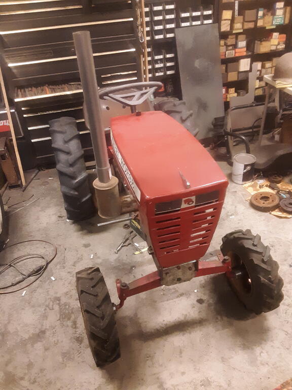

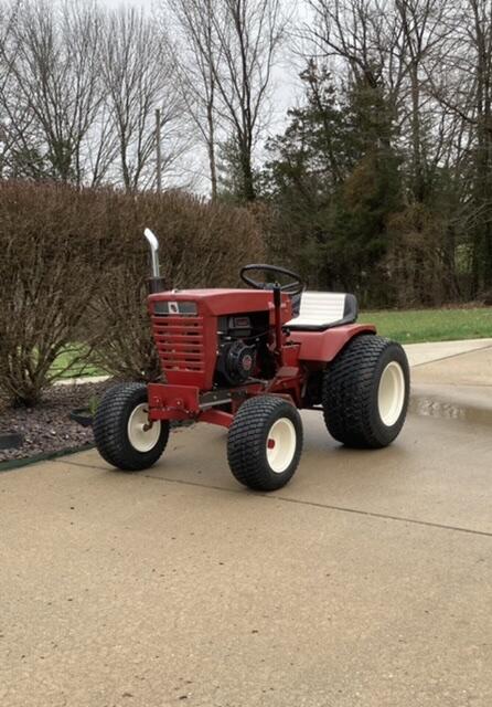

Getting some exhaust action going.
1 hour ago, Oldskool said:
exhaust
Beefy lookin.
2" pipe?
Gonna weld that right to the top of the muffler?
Oldskool
2 minutes ago, ebinmaine said:
Beefy lookin.
2" pipe?

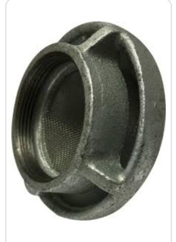

Its 1.5" pipe. Ya, I think I will just weld it on. Not sure what I will do on the top. Maybe a flapper, maybe a mushroom cap, maybe.......
Love the tink, tink, tink of a flapper... But a mushroom cap...........
Hmmmmmmm.

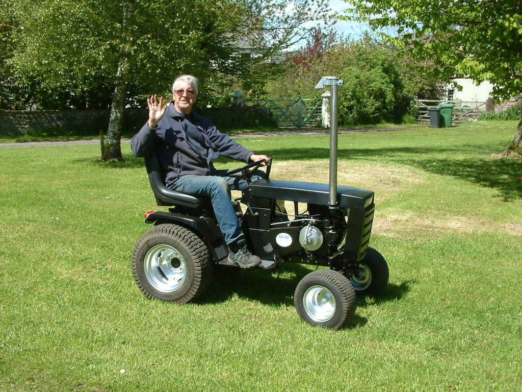

Mushroom  cap?  Would that redirect the fumes back down?
Oldskool
Out and down yes. No moving parts on the cap. Kinda like this.
It appears that the stack is still high enough to get fumes outta your face, right?
Oldskool
For the most part I think.  I'm not going to be mowing with it and spend hours at a time on it. Alot of on and off of it. I can always add more I guess.
13 minutes ago, Oldskool said:
add more I guess.
wow, that’s a stack reference outta’ @ebinmaine’s book!
Oldskool
Well most of the parts did come from his place lol

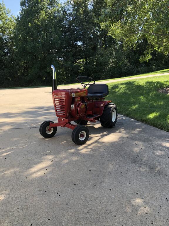

Fumes from engine stacks must depend on the engine. My Predator is my shortest stack and I never get fumes from it. The 7hp Kohler on the Lawn Ranger is similar in height but it fumigates me any time it’s running. DF9F0B17-3415-4BF5-93D9-2FC023E216D3.jpeg.4a94b1c40edc0c81da230f790cddbe2d.jpegCC60A4A2-3344-4FB3-928E-86E98F7BA951.jpeg.06ba7935c3ea3c820c545b2d8a54a0c6.jpeg
Oldskool
I would think it probably does depend on the engine. How short is your shortest stack? Mine is going to be about 18in above the hood
haydendavid380
That looks sharp
Oldskool
5 minutes ago, haydendavid380 said:
That looks sharp
Thanks. I'm having a blast building it
  • Heart 2
Stormin
Black Horses stack is about the same hight. No problem with fumes.
  • Excellent 3
cschannuth
On the 606 it’s about 10”. The muffler is 8” and the tip is 8” and only about 2” of the muffler is above hood plus the 8” tip.

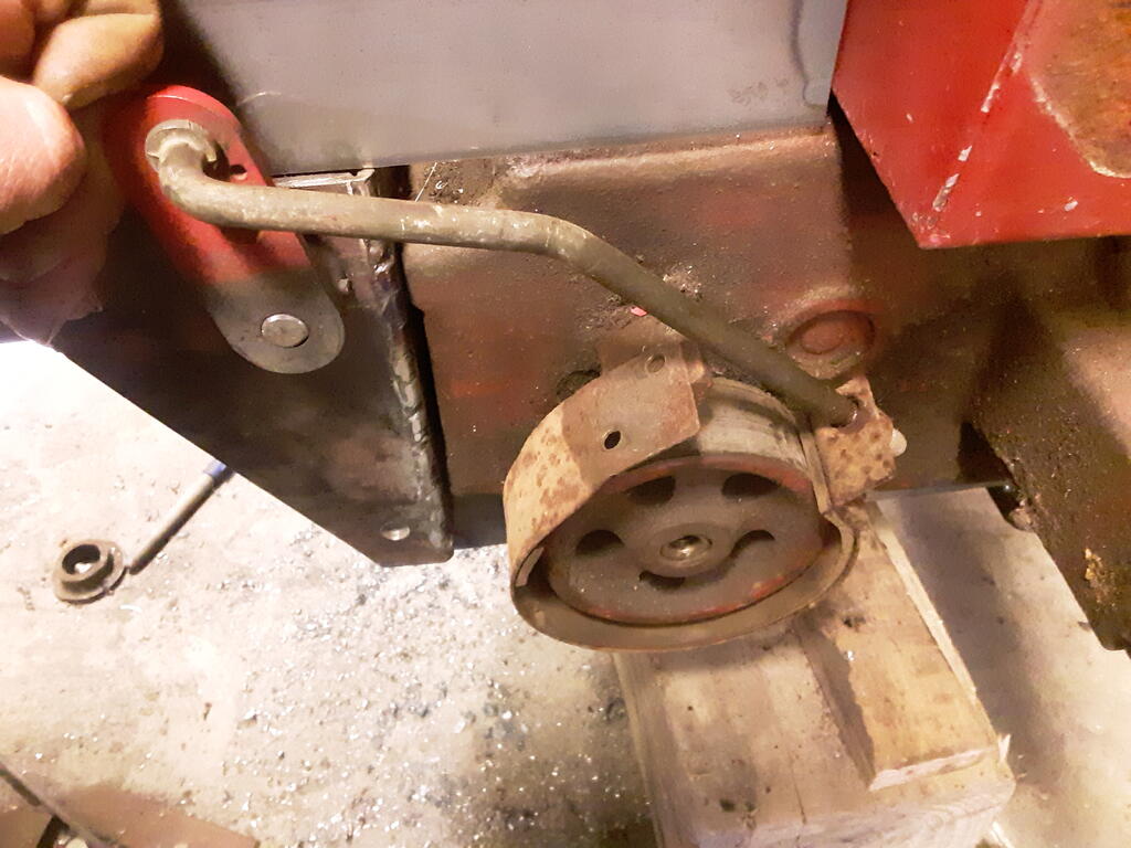

I ran into a bit of a snag. Looks like I will have to alter the rod going to the brake band. As it is now, it doesnt line up. Unless I have something out of place. Which brings me to a bit of another question. If the left pedal works the brakes and clutch what is the right pedal for?
  • Confused 1
On a 60s tractor the one pedal does both functions.
Around 1970 Wheelhorse started using 2 pedals on manual transmission tractors.
Left is clutch. Right is brake.
If your setting up your own rig it's a preference issue deciding the way you go.
I prefer 2 pedals in my hilly yahd.
Oldskool
Ok so I was thrown off by the frame i got from you. It had both pedals but the one pedal ran both. Now that I'm set up that way I may back track and split them. Thanks for clearing that up.
If you need any reference pics I can take some of Cinnamon.
Oldskool
If you could,that would help alot. Thanks
Absolutely. I'll get a few Monday afternoon for you. Maybe a video too.
