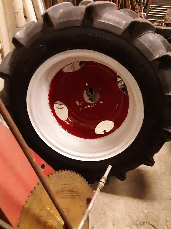

Hey can you give a short tutorial about how you fill those holes with weld?
Those old lug holes were about 9/16" in diameter. The rim was approx. 5/16 " thick. I used a 1/2" rod cut into 3/16" thick pieces. I then placed a magnet on the back of the rim over a hole. Then dropped a 1/4" washer in the hole for a spacer. Then the 3/16" x1/2" rod piece was placed in the hole on the washer. Once that was done I did a rosette weld on top of that piece. Flipped the rim, removed the magnet and washer. Then did a rosette weld on that side. Grind smooth. If it was structural I probably would have gone with a smaller diameter rod to get more weld in there.

Niiiice.
Thanks.

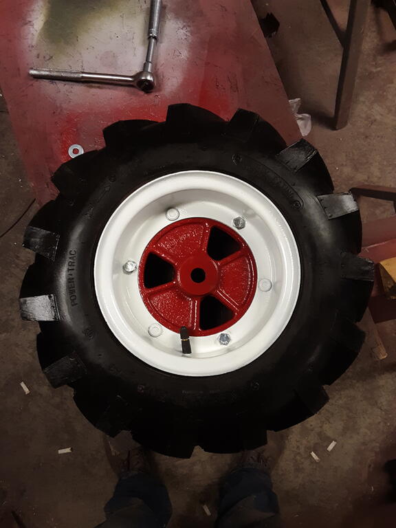

I did NOT make the same paint mistake on the front wheels.

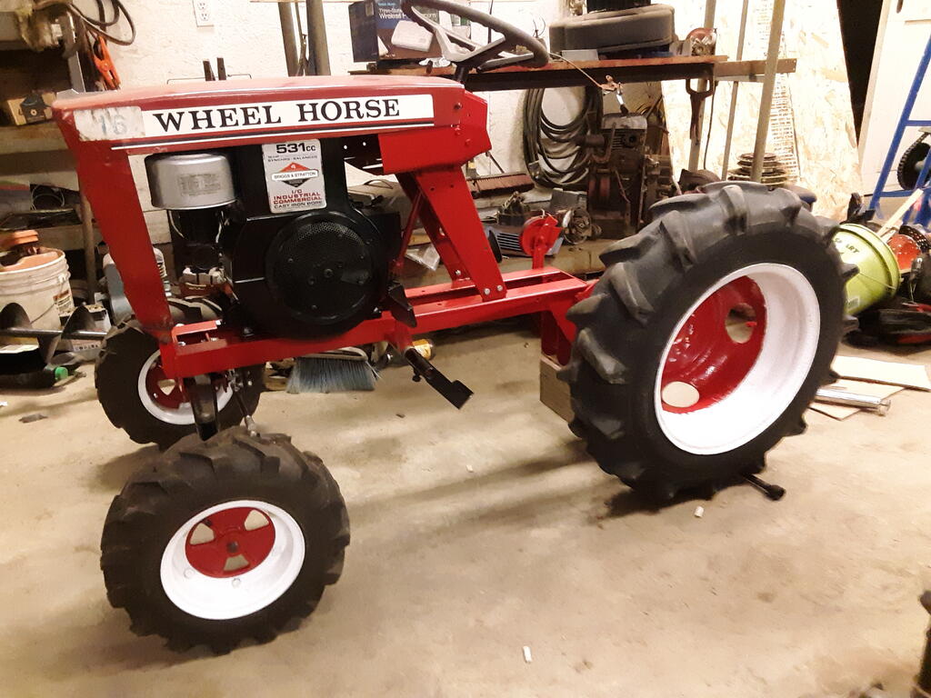

Starting to look more like a tractor again
  • Excellent 5
Tractorhead
Great Color Combo 👍
Oldskool
1 minute ago, Tractorhead said:
Great Color Combo 👍
Thanks. I'm really happy with it.

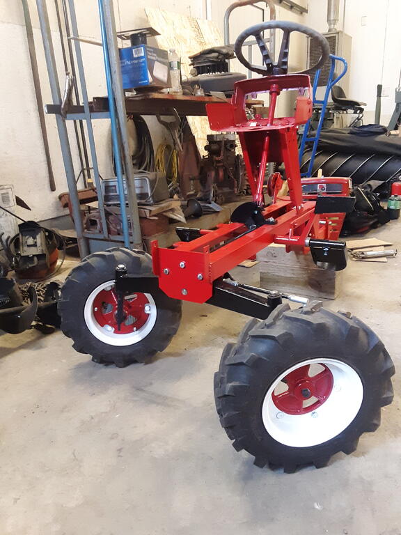

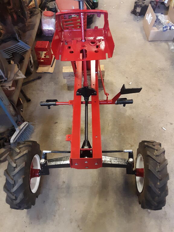

Just curious. How far do the wheels usually turn to the side? It probably is just me but they seem to turn quite far.
OldWorkHorse
Your wheels seem to be a few degrees more turned then my wheels will do but my axle has stoppers on it so the spindles hit them and stop b4 going full 90. Maybe ur axle has them and I can't see them?
Edited by OldWorkHorse
OldWorkHorse
Good example of the tire angle
Oldskool
I dont think my axle has stops. My steering stops when the steering  gear hits the frame
Oldskool
@OldWorkHorse ya that looks the same as mine. It just seemed really sharp
OldWorkHorse
Yeah until I had both wheels on when I 1st turned that 1 wheel I just thought to myself well I better not cut to wheel to fast but once I got both on it looked a bit more natral and turns nicly. Mind you my wheels are pushed about 2ish" from where they would normaly be on the spindles so angle may be a little less then stock not sure how that effects it.
OldWorkHorse
Maybe weld sum stoppers to the spindle arm to stop it at a less aggressive angle?
Oldskool
My fronts are out a bit more then stock as well. I may put some bump stops on, but I kinda like the radius. I will have to see how it steers and how recovery is from a turn
Edited by Oldskool

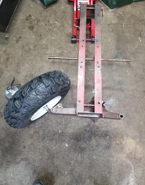

      I've wanted to do this type of project for a while now. So here we go. The name was given by @wallfish. It will be called "The Yeti".  It will be painted and badged in a military theme. The front axle is in progress now.
