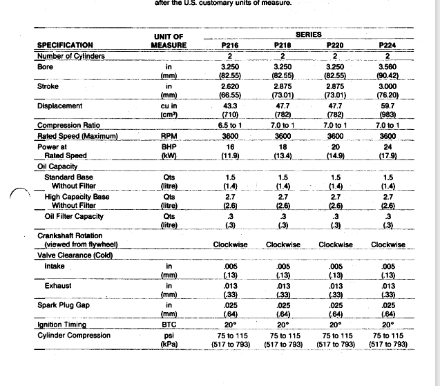

grinchsr 672 #1 Posted March 14, 2021 (edited) I just did a compression test on my 1992 520 with 1176 hours on the clock. Rear cylinder had 140 PSI and the front had 128. I thought 100 PSI was normal. Test taken with choke and throttle wide open Thoughts?? Edited March 14, 2021 by grinchsr Share this post Link to post Share on other sites
JohnD 145 #2 Posted March 14, 2021 (edited) I believe people will say that's pretty good, about 4-6:1 compression. 100 psi is only a little better than 3:1, and the KT-17 manual indicates less that 90 psi can indicate issues, and your cylinders should match between 15%. Yours are within 10%. Edited March 14, 2021 by JohnD adding detail Share this post Link to post Share on other sites
lynnmor 8,915 #3 Posted March 14, 2021 Many compression testers are not very accurate, but that rear cylinder may be too high. Unless you have done a de-carbon, it is over due and may be the cause of the high reading. Share this post Link to post Share on other sites

JohnD 145 #6 Posted March 15, 2021 Oops, i had funny math there. Standard is 14.7 psi at sea level, so 100 psi is 6.8:1. Share this post Link to post Share on other sites
