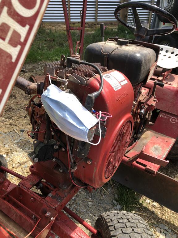

krystolo 504 #1 Posted March 11, 2021 Hello friends, Any top tips for diagnosing a non-starter? Will give a couple of turn overs, then nothing. No clicking, no buzzing, just dead. I changed the battery, but I fear this is something more sinister. Also, I’d there supposed to be an air filter here? 🤔 1977 C160 Share this post Link to post Share on other sites
Pullstart 70,766 #2 Posted March 11, 2021 Do you have a volt meter? Tracing the power along for basic troubleshooting will be the best way to diagnose the issue. There are safety switches on the PTO and seat, most likely. Sometimes the clutch pedal has one as well. 1 Share this post Link to post Share on other sites
Pullstart 70,766 #3 Posted March 11, 2021 Yes, you need an air filter base, filter and prefilter and a cover. 1 1 1 Share this post Link to post Share on other sites

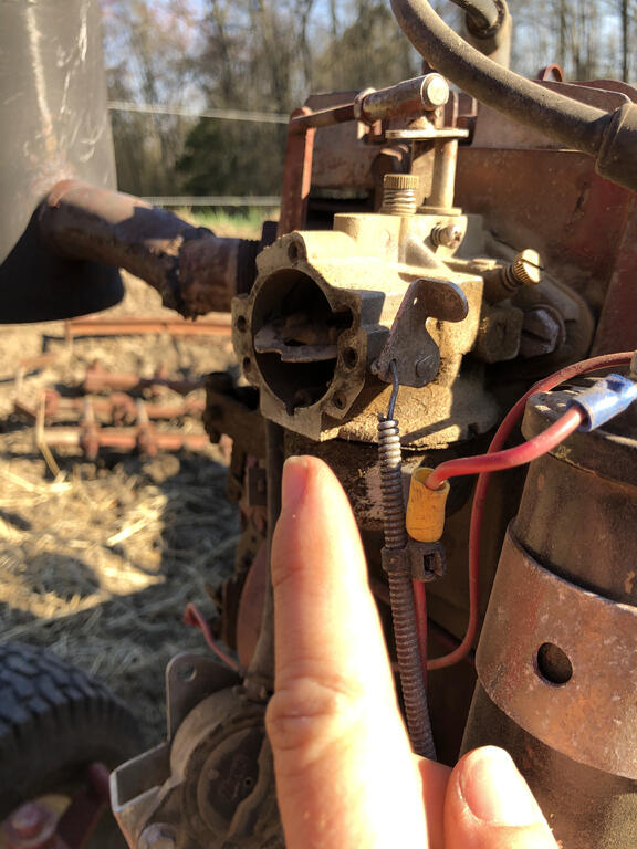

krystolo 504 #11 Posted March 14, 2021 OK, so I poked around on the electrics, and one of the wires to the regulator rectifier is shot. Kinda melted and burned. Perhaps this explains the dead batteries. Also, I cleaned the carburetor with some spray stuff, and now it won't start even with a jump. It will turn over and over, but not start. I'm so impatient to learn how to take care of her, but I sure am hitting my limits. Share this post Link to post Share on other sites

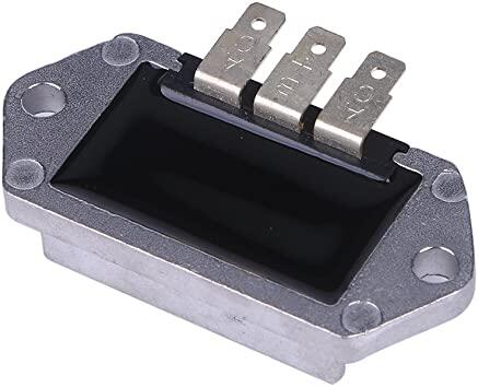

953 nut 67,488 #16 Posted March 16, 2021 9 hours ago, krystolo said: I tested a lot of the wiring, and found that there is power to the coil and to the power to the points, and it will start with a jump. However, when I turn the key nothing happens, or just a little crank, then nothing. Probably time to clean and tighten all electrical connections including grounds. ANY bad connection can cause a problem so clean them all. There seems to be power to the ignition switch, and the headlight comes on. I'm struggling to figure out the wires coming out of the engine to the regulator. They are both red, and I'm not sure which is positive/negative. Need to check voltage there, too. The two wires coming from your engine produce AC voltage in the range of 24 to 36 Volts Alternating Current depending on engine RPMs. Funny thing is that I think the fuse is blown on my multimeter, so had to get a second multimeter to test the fuse. LOL Put a little pause in my work, but I managed to get some diagnostics done... Thanks again for all of your help! Oh! The spark plug was quite charred. Sanded it off and it helped. Anyone know what plug I need, off hand? Champion H-10C 1 Share this post Link to post Share on other sites
krystolo 504 #17 Posted March 16, 2021 @953 nut So it doesn’t matter which wire coming from the engine goes to which connector on the rectifier? thank you for your help! This process is fun and frustrating at the same time. Such a steep learning curve. Share this post Link to post Share on other sites
Tuneup 1,459 #18 Posted March 16, 2021 (edited) No matter - it's just a matter of AC phase and the regulator doesn't care. Just be sure to connect its battery terminal properly. As Richard said, you'll be chasing electrical gremlins forever unless you at least assure that the grounds are clean. So, there is power to the coil and the engine can be jumped - great. The ignition switch is powering the coil. The starting circuit provides power to the solenoid switch which separates the starter from battery start power. Connect the DMM to the small terminal on the solenoid and the other to the battery (-). Turn the key to Start. You should see 12V. If not, key switch or power to that switch - wiring or interrupt switches. To test the solenoid, touch a lead from the battery (+) to the solenoid small terminal. You should hear a loud click and the engine should attempt to start. If not, bad solenoid. There is an assumption that the solenoid is well grounded as well. If click but no starter turning, weak battery or bad battery leads or still bad solenoid or even starter. Those switches are cheap and common. Battery leads of various lengths are at auto parts stores but I always check Wally World first as auto stores are a rip-off. I paid $10 for good marine grade grease last weekend. If it clicks and starts, your starter circuit - ignition switch, bypass switches and/or wiring is suspect. Edited March 16, 2021 by Tuneup 2 Share this post Link to post Share on other sites
953 nut 67,488 #19 Posted March 16, 2021 17 minutes ago, krystolo said: doesn’t matter which wire coming from the engine goes to which connector on the rectifier? The two AC wires go to the outboard terminals marked AC, The third (center terminal) will go to the "R" terminal of the ignition switch. 2 Share this post Link to post Share on other sites
