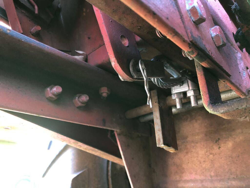

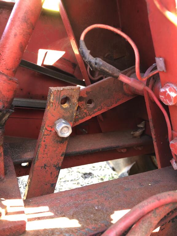

krystolo 504 #1 Posted March 9, 2021 I'm adoring the new little tractor, but it seems she's had a rough go of it. Many of the points for attaching blades and so forth have been sheared off. The prior owner has been using bolts to hold the implements on, and I'm just not familiar enough to know what I'm looking at. Is there a diagram that shows the various lift points and what they are for? That rear belly grading blade is the bomb! Oh, also, is it ok to powerwash the engine and hydraulics area? Looks like there is a hydraulic fluid leak. Thanks, everyone! IMG_1471.HEIC IMG_1470.HEIC Share this post Link to post Share on other sites

Handy Don 16,944 #6 Posted March 9, 2021 2 minutes ago, krystolo said: Wallowing out comes from friction without lubrication (and lots of usage) or misalignment. On the left, having a bolt means that the bearing surface for both the lift arm and the lift bar is the threads of the bolt and not a smooth surface. That's why most of us use a pin with a cotter or "R" clip. To help with alignment, use washers to make sure the joint can rotate smoothly but has no other play. On the right, it is correct to have the clevis with a pin and R-clip--this arrangement balances the force across the two sides of the clevis and centers it on the lift arm. Having the cable with clamps isn't uncommon (we already saw images of the other end of that cable and the broken arm on the hitch). 2 Share this post Link to post Share on other sites
Handy Don 16,944 #7 Posted March 9, 2021 Should have added the both of these connections should get greased periodically! I am curious bout the seemingly sawed off arm on the shaft just aft of the cable clamp in the right picture. Anyone know what that is? Share this post Link to post Share on other sites
JAinVA 4,638 #8 Posted March 9, 2021 Hope you don't want to run a mower deck to much. The photo on the right shows the lift link for the mower deck to be hacked off. Share this post Link to post Share on other sites

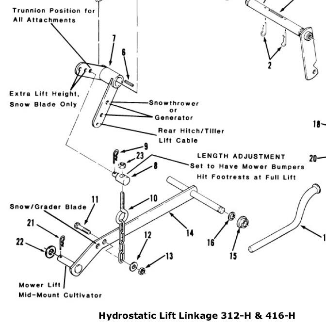

gwest_ca-(File Mod) 12,353 #9 Posted March 10, 2021 Your lift does not look modified. 1 Share this post Link to post Share on other sites
krystolo 504 #10 Posted March 10, 2021 @gwest_ca perfect! this is exactly what I was looking for! Is this the same diagram for the C160? Thank you! Share this post Link to post Share on other sites
krystolo 504 #11 Posted March 10, 2021 4 hours ago, JAinVA said: Hope you don't want to run a mower deck to much. The photo on the right shows the lift link for the mower deck to be hacked off. Fortunately, we have another mower. I can't figure out how one would replace that piece. Any ideas? Share this post Link to post Share on other sites
oliver2-44 11,628 #12 Posted March 10, 2021 As gwest said your Rockshaft item 7 on the diagram looks ok. It looks like your Mower Lift Bar item 14 is what’s cut off. 1 Share this post Link to post Share on other sites
Pullstart 70,696 #13 Posted March 10, 2021 9 hours ago, krystolo said: Fortunately, we have another mower. I can't figure out how one would replace that piece. Any ideas? there are c-clips that hold the round bar inside the frame. Pop those clips and with the help of removable bushings it’ll walk right out. 1 Share this post Link to post Share on other sites
