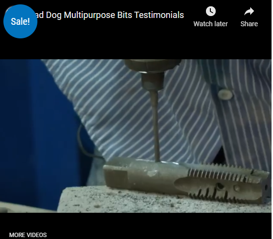

WVHillbilly520H 10,379 #27 Posted March 9, 2021 Not knocking those bits as I have not experience with them myself, but here are "machinists" takes on them around 10 years ago... https://www.practicalmachinist.com/vb/general/anyone-tried-bad-dog-drill-bits-236059/ 1 Share this post Link to post Share on other sites

DennisThornton 4,773 #31 Posted March 9, 2021 36 minutes ago, WVHillbilly520H said: Not knocking those bits as I have not experience with them myself, but here are "machinists" takes on them around 10 years ago... https://www.practicalmachinist.com/vb/general/anyone-tried-bad-dog-drill-bits-236059/ I'm not going to defend the negative comments within, only that I've seen and tried them at several shows but it seems the only time I used one at home I broke it, so other than seeing and trying them at the shows, I can't offer much. I gather that it is important to operate as instructed but obviously I never got good at it. Sidenote: I will say that their Biter nibbler is incredible! Only used it a few times for small projects so I don't know how long it will hold up but it will do some crazy cuts! Share this post Link to post Share on other sites

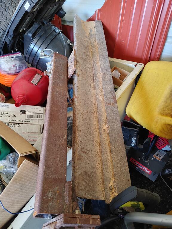

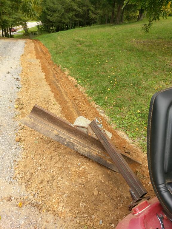

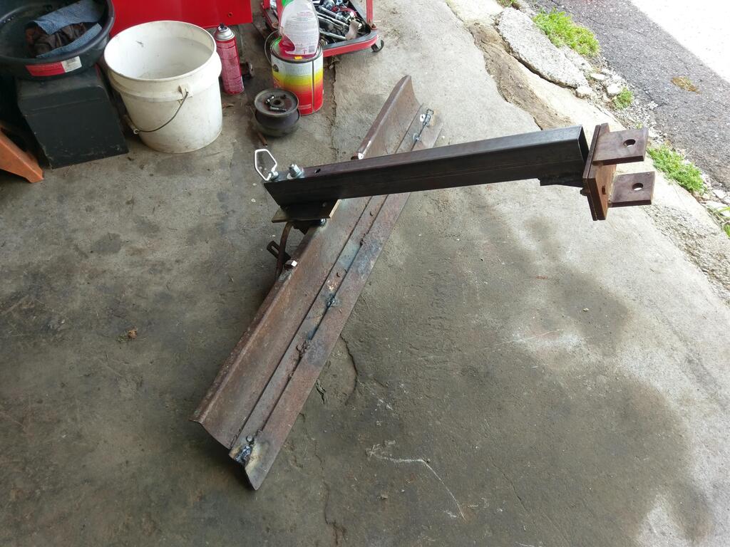

ol550 869 #33 Posted March 9, 2021 I have used this to drill leaf springs that I use for snow plow edges. Cobalt bits and cutting oil. 2 Share this post Link to post Share on other sites
DennisThornton 4,773 #34 Posted March 9, 2021 1 hour ago, ol550 said: I have used this to drill leaf springs that I use for snow plow edges. Cobalt bits and cutting oil. Man! I've been looking for years and NEVER seen one for sale! Bet I still haven't... Probably should just plain on making one! How do you straighten the leaf springs? Share this post Link to post Share on other sites
ol550 869 #35 Posted March 9, 2021 1 hour ago, DennisThornton said: Man! I've been looking for years and NEVER seen one for sale! Bet I still haven't... Probably should just plain on making one! How do you straighten the leaf springs? 25 Ton press. Have to be careful when you get close to the tie bolt holes, have broken some there. Share this post Link to post Share on other sites
DennisThornton 4,773 #36 Posted March 9, 2021 2 minutes ago, ol550 said: 25 Ton press. Have to be careful when you get close to the tie bolt holes, have broken some there. Certainly seen broken leaf springs and some sagging but I never thought I could bend them on a press. And you've made 4ft long edges? What trucks are good choices? Share this post Link to post Share on other sites
ol550 869 #37 Posted March 10, 2021 37 minutes ago, DennisThornton said: Certainly seen broken leaf springs and some sagging but I never thought I could bend them on a press. And you've made 4ft long edges? What trucks are good choices? I have been using GM springs as that's what I have around. Think they are 2 1/2 wide. Have welded some together to make the longest a 6 footer. 1 Share this post Link to post Share on other sites
WVHillbilly520H 10,379 #38 Posted March 10, 2021 (edited) 1 hour ago, DennisThornton said: Certainly seen broken leaf springs and some sagging but I never thought I could bend them on a press. And you've made 4ft long edges? What trucks are good choices? 1 hour ago, ol550 said: I have been using GM springs as that's what I have around. Think they are 2 1/2 wide. Have welded some together to make the longest a 6 footer. That's what dad used on the rear scraper blades he made many years ago, instead of drilling we just welded it the original 1/4" CRS/HRS edge under the bolts... Start in the center then using C clumps as you got out the ends definitely wears better than plain CRS/HRS. and when it does grind off welds flip and reweld this has been on it for over 20 years through hard sandstone, limestone base and packed clay. Edited March 10, 2021 by WVHillbilly520H 1 2 Share this post Link to post Share on other sites

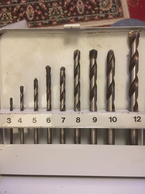

ranger 1,860 #39 Posted March 10, 2021 I have a set of drills bought at a show many years ago. I’ve messed up one, the 8mm. I’ve drilled through files, stainless steel and leaf springs. They really want to be used in a drill press to keep the pressure on to cut and minimise slipping, also you shouldn’t drill a pilot hole, that is the quickest way to ruin them apparently. I drilled the cast iron “Aldi” weights I used for wheel weights with the 12mm one, it went through as if it was butter! Doug. 3 Share this post Link to post Share on other sites
