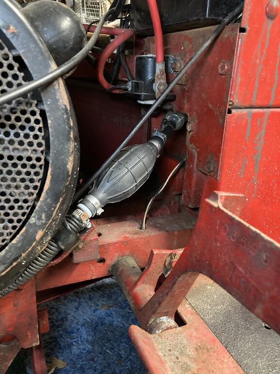

SylvanLakeWH 32,823 #15 Posted March 7, 2021 Super simple, cheap, works every time... 2 Share this post Link to post Share on other sites
pfrederi 21,312 #16 Posted March 7, 2021 Clearly the primer bulb is a good inexpensive option for slow starting...BUT When a mechanical pump fails internally you can destroy the engine. Common occurrence no, but $30 for a pump vs how much for an overhaul??? 5 Share this post Link to post Share on other sites
