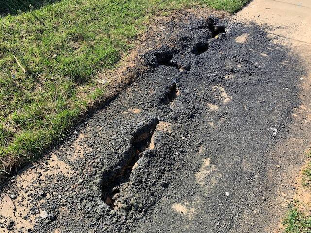

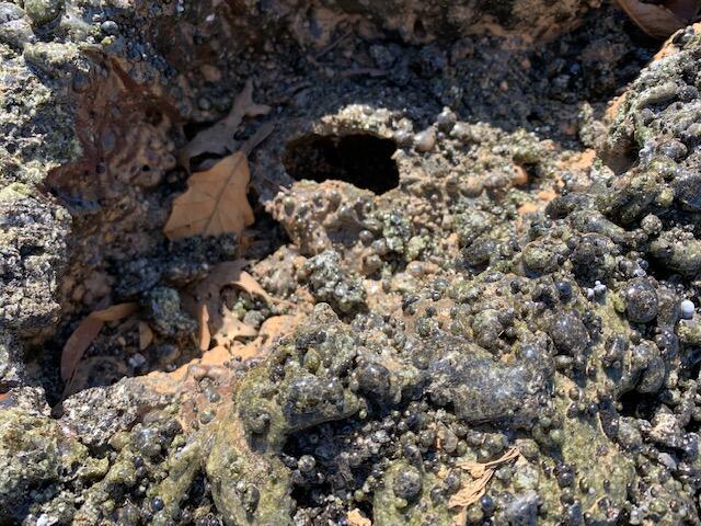

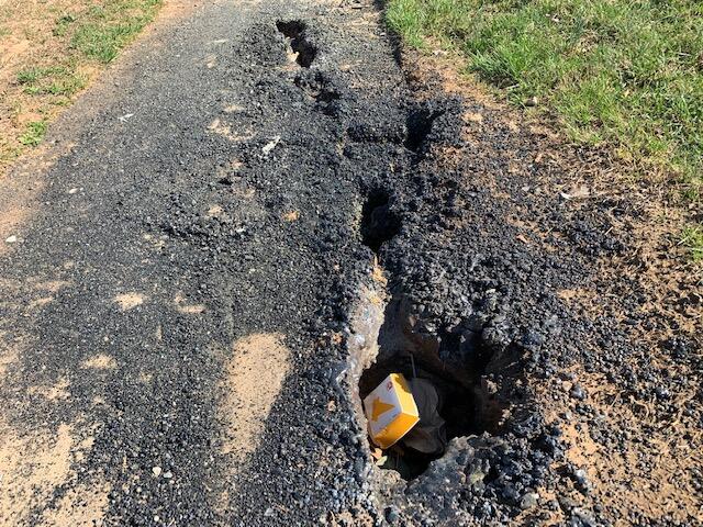

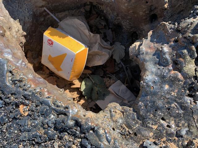

Horse Newbie 7,402 #1 Posted March 6, 2021 (edited) Okay all you engineers, physicists, and scientists, take a look at these pics I took at work today and tell me what caused this damage to a concrete sidewalk... Edited March 6, 2021 by Horse Newbie 2 1 Share this post Link to post Share on other sites
bc.gold 3,406 #2 Posted March 6, 2021 (edited) Kids prbably got their hands on a couple of sacks of thermite, used by the railways for track welds. Thermite burns at about 5000 degrees F., or half the temperature at the surface of the sun. How deeply it will burn of course depends on the amount of fuel available. Most of the heat, of course, will go upward. Some ash will form, which will insulate the concrete to a degree, and further impede downward burning. So, as a guess, I would think it would only burrow down an inch or two before the fuel burns out, even for a big charge. Edited March 6, 2021 by bcgold 2 Share this post Link to post Share on other sites

Mickwhitt 5,259 #9 Posted March 6, 2021 Buried power cable failure. We had one near where I worked as a cop, report of fire coming up through the pavement. Pretty spectacular in a country where our last active volcano was witnessed by didlosaurs. Lol 4 1 Share this post Link to post Share on other sites
squonk 46,196 #10 Posted March 6, 2021 Buried primary lines can do a lot of damage when they take a dump! 3 Share this post Link to post Share on other sites

oldlineman 1,680 #12 Posted March 6, 2021 I would go with Mick, have seen similar with URD failure and also with energized over head lines down and protection equipment not clearing line for various reasons. Bob Share this post Link to post Share on other sites

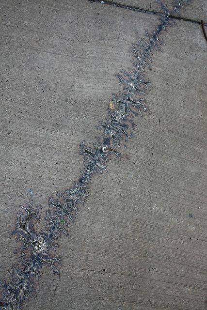

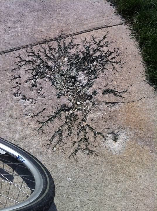

Horse Newbie 7,402 #16 Posted March 6, 2021 5 hours ago, ebinmaine said: I gotta go 🌩️🌩️⚡⚡⚡⚡ Lightning ⚡⚡⚡⚡⚡⚡ That was one of my guesses...here's 2 pics of lightning damage to a sidewalk... Share this post Link to post Share on other sites
Mickwhitt 5,259 #17 Posted March 6, 2021 Looks quite different to your damage. More surface than burn through. 1 Share this post Link to post Share on other sites
Horse Newbie 7,402 #18 Posted March 6, 2021 (edited) Okay fellows, You guys came up with some very insightful and possible answers, but what it was is quite simple...a man was walking his Chihuahua down the street after eating at a Mexican restaurant, the dog farted, and this was the aftermath... The dog and the man both survived...the man only receiving minor burns on his feet, and having to buy new shoes and socks...the dog was found 3 blocks away, unharmed, lodged between two branches in a tree, with singed butt hair... Edited March 6, 2021 by Horse Newbie 3 1 Share this post Link to post Share on other sites
Handy Don 16,329 #19 Posted March 6, 2021 (edited) High voltage buried line going bad released a lot of heat. Boiling moisture in soil creates steam which can cause an "explosion". Stories of manhole covers being thrown hundred of feet due to electrical shorts in flooded manholes are pretty commonly reported. Edited March 6, 2021 by Handy Don 1 Share this post Link to post Share on other sites
Horse Newbie 7,402 #20 Posted March 6, 2021 (edited) What actually happened was... A car struck a utility pole, broke a/ some wires, and when the wires grounded to the earth it must have been fireball city ! I was not there when it happened and glad I wasn't. My 2 guesses were lightning or power lines... Now I'm no electrical expert by no means, but it seems to me that if a single buried power line would be damaged or fail, it would just ground through the surrounding earth and possibly do no more than "throw" a breaker. If two wires failed, or were damaged, and arced together I could see the welding effect, and heat being produced "shoot" up through the earth or sidewalk. If you look close at the pics, you can see molten rock/ concrete...it must have been very hot. From what I understand, this power line fell from a pole... Edited March 7, 2021 by Horse Newbie Share this post Link to post Share on other sites

oldlineman 1,680 #23 Posted March 6, 2021 I worked a storm break several years ago in Detroit and saw several distribution lines on the ground burning. They hand solid line connections and the resulting short circuit to ground was not good enough to trip protection further down the line. Line would just lay there and burn till we got it off the ground and back in the air. Bob 1 Share this post Link to post Share on other sites
