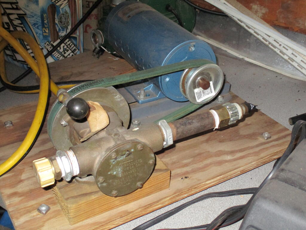

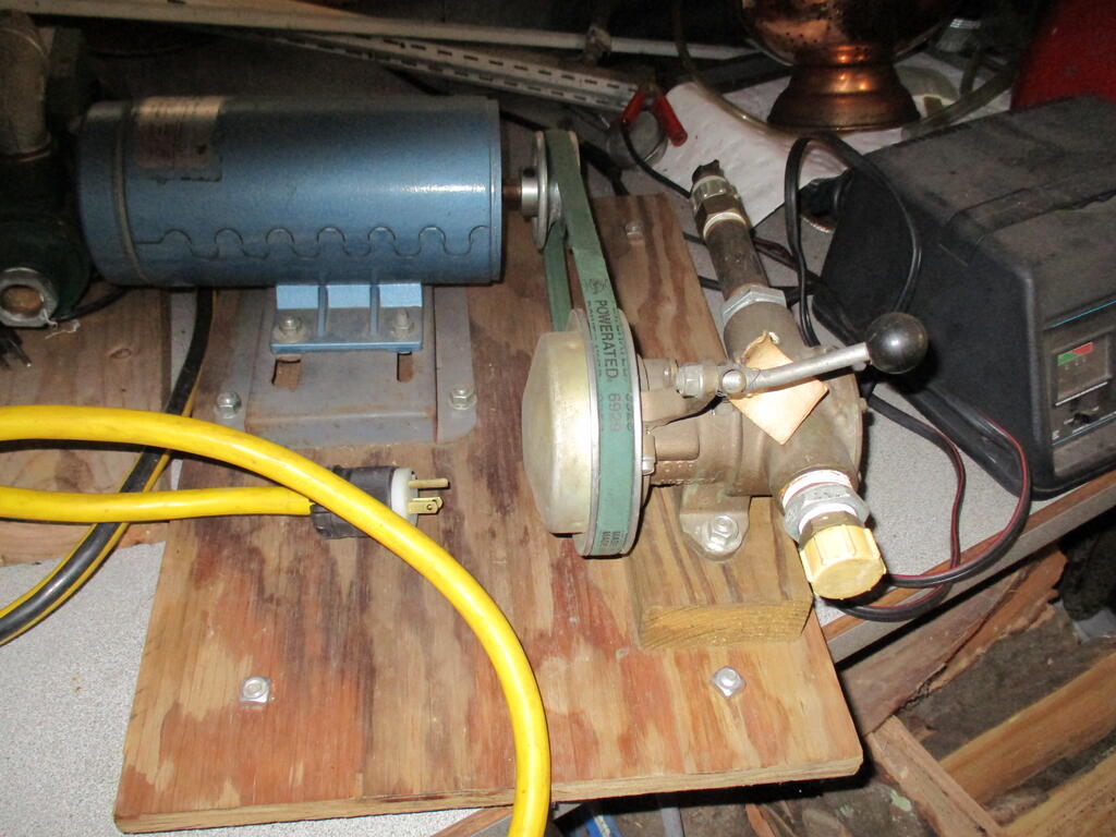

pfrederi 20,870 #4 Posted March 5, 2021 (edited) This is my 24v electric pump setup I use with the M37. It seems to me you could mount your pump on a moveable base (this is a standard electric motor adjustable mount) Are you going to have a deducted engine or mount it on a WH. (Eric's 1A08 Milt std engine would be perfect for pumping...) Edited March 5, 2021 by pfrederi 1 Share this post Link to post Share on other sites

Stepney 2,356 #7 Posted March 5, 2021 Haven't done one fixed mounted to a Horse but it would be pretty easy I think. I've run various PTO implements/pumps at the tractor shows with my WH if the older engines happen to peter out. Little high speed pump like that would need a good tight belt though. I'd probably do a jackshaft off the larger PTO sheave, then double belts at the pump. Hang it under mount from the deck brackets, using the weight of the unit as a tensioner. 2 Share this post Link to post Share on other sites

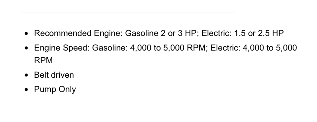

Pullstart 70,712 #11 Posted March 6, 2021 7 hours ago, ACman said: ... Wanting a mount to a horse or off something like above ? You could also yank that pulley of and use a coupling in between depending on rpm requirement . what’s the specs for the pump @pullstart Kevin. The one pictured is from Northern Tool. Here are the specs: 2 Share this post Link to post Share on other sites
ronhatch 410 #12 Posted March 6, 2021 (edited) Years ago I bought from Graingers, a trash pump with a 2" inlet and a 2" outlet to mount on the front of my 8 HP 867 so I could water the trees in my yard. We had a few summers back in the late 80's that were extremely dry, so I pumped the water out of a creek that was in the backyard of my neighbors across the street. I used 400' of fire hose that didn't pass inspection at my place of work at the time and it was just sitting on a shelf. It worked great! The pump unit was bolted to the top of a 1/4" plate and two 18"(?) lengths of 1 1/2" of squire tubing were bolted under the plate. The 2 tubes slipped over 2 - 8" lengths of 1" solid bar that was bolted to each side of the WH frame with short spacers. The unit slipped forward to tighten the double V belts and backwards to loosen them. I did not use an idler. I had to use a 3/4" jackshaft mounted on 2 pillow block bearings so the pump turned the correct way. So, there were double V belts from the engine to the jackshaft and a 3/4" wide 'L' timing belt from the other end of the jackshaft to the pump, all driven at a 1:1 ratio. Even with 400' of hose and only 2/3rd throttle, she really pumped and I didn't lose any trees! Edited March 7, 2021 by ronhatch 2 Share this post Link to post Share on other sites
