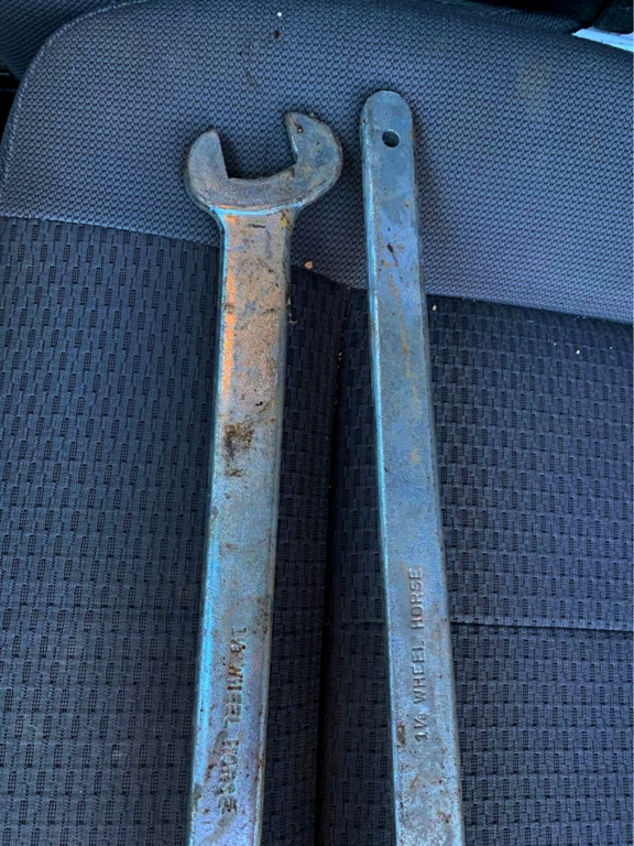

pfrederi 21,134 #5 Posted March 4, 2021 (edited) Save your money. I understand the WH wrenches can bend. Old deck blade hacksaw and a grinder and a bit of time and it will not bend and mine is several years old now. Edited March 4, 2021 by pfrederi 5 1 Share this post Link to post Share on other sites

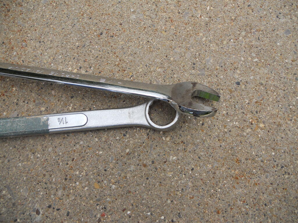

953 nut 69,065 #7 Posted March 4, 2021 I took about 1/8" off the side of one of my 1 1/8" open end wrenches years ago, slips right in there. 2 Share this post Link to post Share on other sites

DennisThornton 4,773 #9 Posted March 4, 2021 2 hours ago, pfrederi said: Save your money. I understand the WH wrenches can bend. Old deck blade hacksaw and a grinder and a bit of time and it will not bend and mine is several years old now. Been wondering why I've kept so many used blades! Man! That should work alright! 1 1 Share this post Link to post Share on other sites

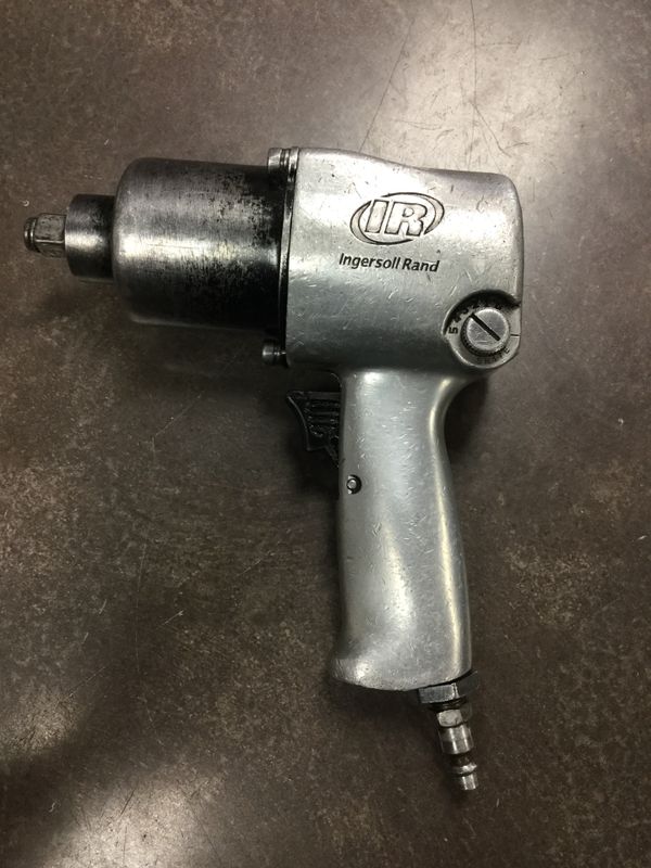

squonk 48,044 #10 Posted March 4, 2021 (edited) 11 hours ago, rjg854 said: Cordless Impact driver and socket IR 231 for the stubborn ones! Edited March 4, 2021 by squonk 3 Share this post Link to post Share on other sites
lynnmor 9,036 #11 Posted March 4, 2021 I have one that I bought with a new tractor many years ago, is spread open the first time I used it. I think they are made out of peanut butter. Get a cheap wrench at a flea market or yard sale and if it is too thick, grind it down. 3 Share this post Link to post Share on other sites
DennisThornton 4,773 #12 Posted March 4, 2021 28 minutes ago, lynnmor said: I have one that I bought with a new tractor many years ago, is spread open the first time I used it. I think they are made out of peanut butter. Get a cheap wrench at a flea market or yard sale and if it is too thick, grind it down. No kidding! Wheel Horse put their name on a mediocre tool? Why bother? Share this post Link to post Share on other sites

WVHillbilly520H 10,379 #14 Posted March 4, 2021 3 minutes ago, pullstart said: What are we using these for? Why do they need to be skinny? I’ve taken a liking to Forged In Fire. If I ever make my own Damascus blade, it’ll be out of either leaf springs or mower blades, or both! For the mower blade spindles nuts, the thinner ones go between the blade and "top" nut to hold it while removing/installing the blade retention nut. 3 1 Share this post Link to post Share on other sites
