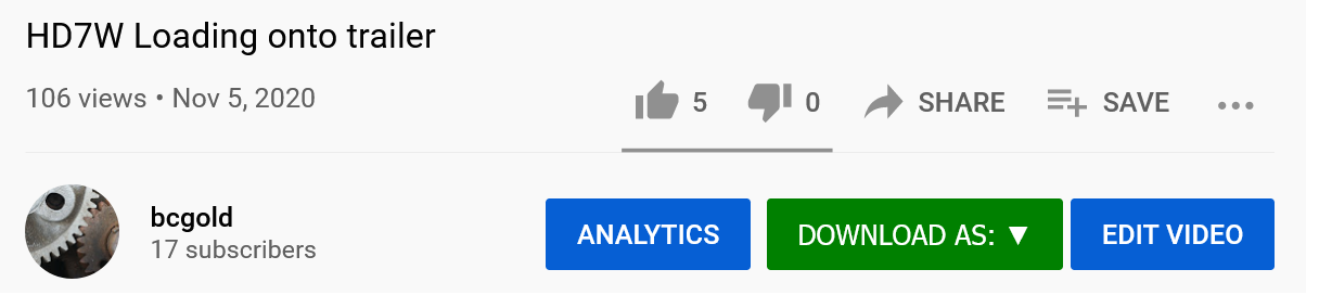

DennisThornton 4,773 #29 Posted March 3, 2021 11 hours ago, bcgold said: If you download the video you will save bandwidth that the ads are leaching from ya. Utility outside of YouTube? I've read a bit about them but never bothered. 1 Share this post Link to post Share on other sites

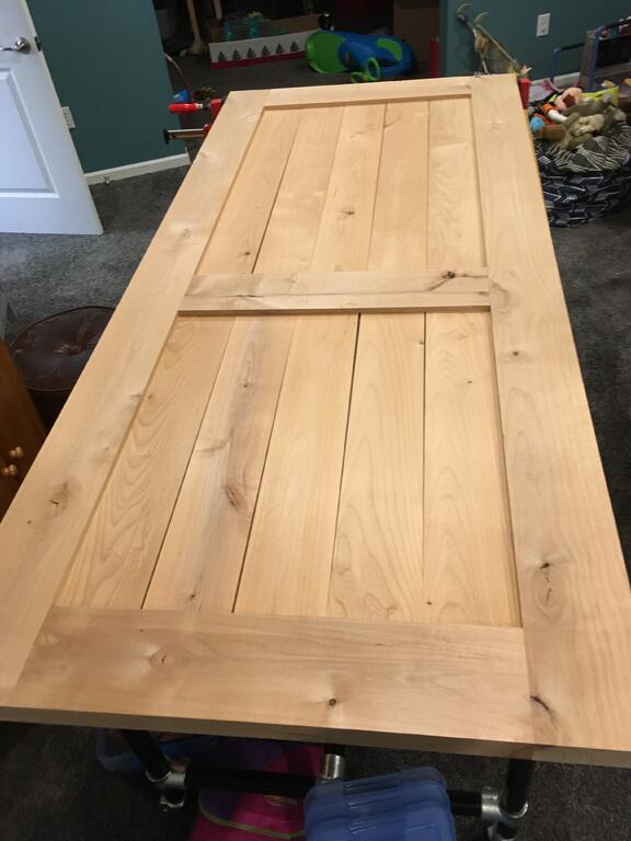

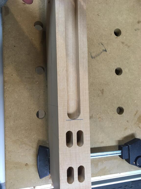

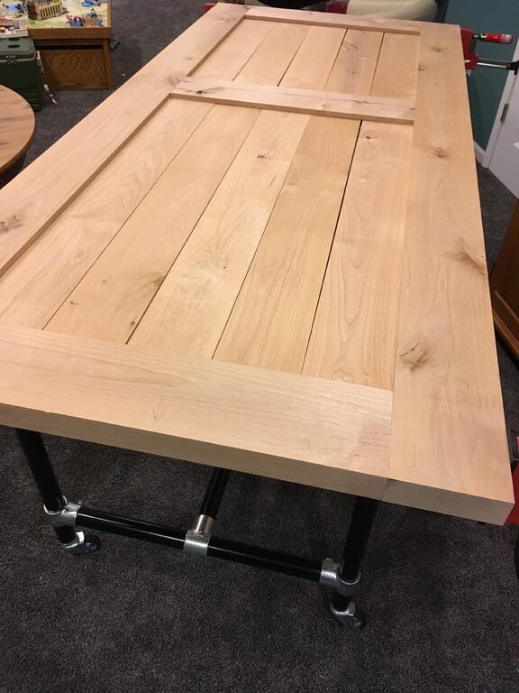

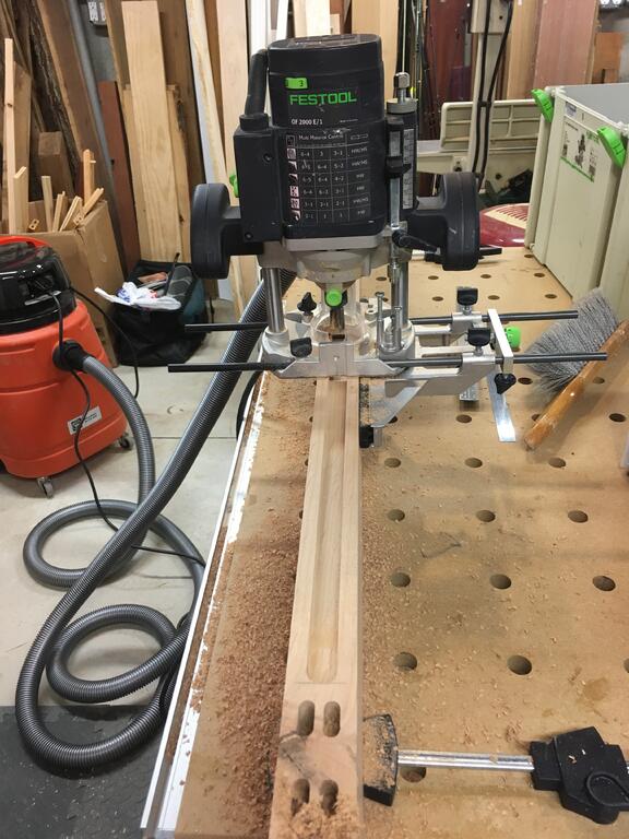

wh500special 2,433 #34 Posted March 3, 2021 (edited) I like these projects. And sliding doors are certainly the current trend. I suspect in a few years when this runs its course that all of our homes will appear dated. I don't have better pictures, but I made these sliding doors from Alder for my basement to close off a bedroom. My wife looked at lots of doors and didn't find anything that was to her liking (that we were willing to pay for) so asked if I could make something instead. She wanted them to be heavier looking than the off the shelf models. The vertical boards float in grooves I cut into the stiles and rails. To block vision between adjacent boards, I cut grooves into the edge of each vertical board and put splines in between. The splines are glued into only one of the boards so they don't rattle. Because I didn't know when to say when, there is a little bit of EPDM foam in the grooves of the rails here and there to keep it snug but still let them grow as needed, hopefully without blowing it apart. So far, so good. No massive movement or problems due to humidity swings. I had planned to tenon everything together, but got lazy and used a fancy gizmo that makes floating tenons instead for expediency. No metal fasteners, but it felt like cheating. I don't have pix of the finished doors. They are sort of gray now. The top and bottom panels aren't the same height but the angle of the photo makes it appear so. If I had to do it over, they wouldn't be so thick. I think they ended up around 1-3/4" which means the track at the top needs to stand off the wall further than I wanted. Didn't think that through... Steve PS - in anticipation of the "you sure like expensive tools comment" I'll defend myself by saying I buy all of my stuff used. Edited March 3, 2021 by wh500special 3 1 Share this post Link to post Share on other sites

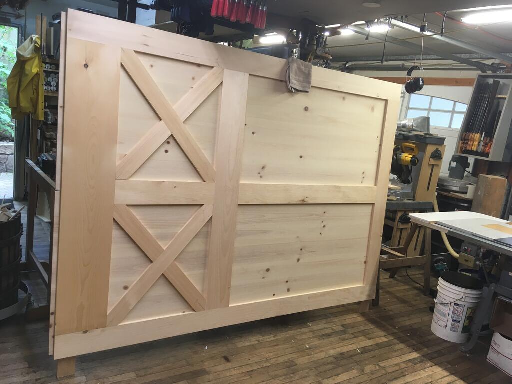

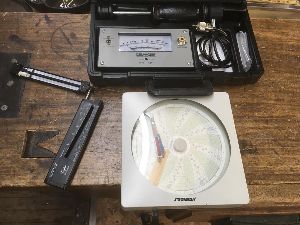

formariz 12,379 #35 Posted March 3, 2021 (edited) Everyone likes solid wood myself included. I probably use more solid wood than most. However there are many jobs or items where solid wood is not advisable and there are better alternatives. I have probably built well over several hundred doors up to now. Probably 75% have all been solid wood using traditional mortise and tenon work with floating panels. Barn doors are not so critical because they are merely attached at the top and do not have to critically fit within a frame where any warping and or twisting will be a problem but as I will describe later they may be a problem also. A regular door however is critically different story and materials have to be carefully selected from specific cuts so as to prevent any warping or twisting. The process of gluing and clamping such a door can already create a problem if done incorrectly. Barn doors can also many times be a problem if they twist badly. A client that I have worked for for years is very fond of barn doors and had in the past two of them built by someone else. They are used to close large openings into other rooms and are around seven feet wide and eight feet tall. They are solid wood built from rough boards. I have probably fixed them at least a dozen times. They constantly warp so badly that they either wedge themselves on the bottom guide not working at all or have actually popped off the top rollers. Every season is an adventure with them. One of the last jobs I did for them was the woodwork for their pool house. Again she wants a large barn door. She was so disappointed with the others that she said no more. I assured her that it can be done without any problems. This is an area totally exposed to all kinds of moisture from the pool having large patio doors always open in the Summers and showers right next to it. So I built the door on the photo. It is a little over 6 feet wide by 8 feet tall. Rather than to use solid boards for the panels I used instead special grade knotty pine plywood having only solid wood for the frame. It is a hybrid construction technique essentially making a sandwich of different materials. Door has now been up for two years and there has not been any warping or twisting on it with all joints being tight. It is perfectly straight horizontally and vertically and with a slight push it will slide by itself all the way to the stop bumper on the other side. The lore and appeal of solid wood is wide spread and sort of a romantic thing. It is however in many cases not the appropriate material to use unless one is willing to deal with and tolerate the consequences. On top of that is also makes some of these projects unnecessarily expensive and troublesome. In our modern homes with air conditioning in the summer and heating in the winter, and constantly changing humidity content solid wood goes essentially through shock treatment. Totally solid wood furniture today in these homes would slowly self destruct and be a nuisance with stuck drawers , badly fitting doors and unsightly cracks just to name a few. Is it possible? Yes, however not many know how to build it correctly and few clients have the finances to afford such pieces if correctly built.. Below is a photo of the three tools which precede all of my work, whether it is to purchase material, build it in the shop or to install it in a clients home. Prior to any installation of major work, a circular chart recorder is installed at least one week before and if all conditions are conducive to installation afterwards it will stay recording for about one month. This way there is an actual visual accurate record of what is going on environmentally which always explains what problem may show up. Edited March 3, 2021 by formariz 3 Share this post Link to post Share on other sites
wh500special 2,433 #36 Posted March 3, 2021 (edited) Oh my god, a Sling Psychrometer! I'll bet that garners some attention when you start whirling it around! Cas, I love when you get involved in a post. I always pick up a couple dozen things I didn't know I should know. I'm fortunately (?) at the level where the precision of my work isn't high enough to be so demanding, but I can truly appreciate what you do. When I first saw the pic of that gigantic door I thought, "wonder if that's plywood?" but figured it wasn't. Makes sense to go that route. Steve Edited March 3, 2021 by wh500special spelllleengue 2 Share this post Link to post Share on other sites
