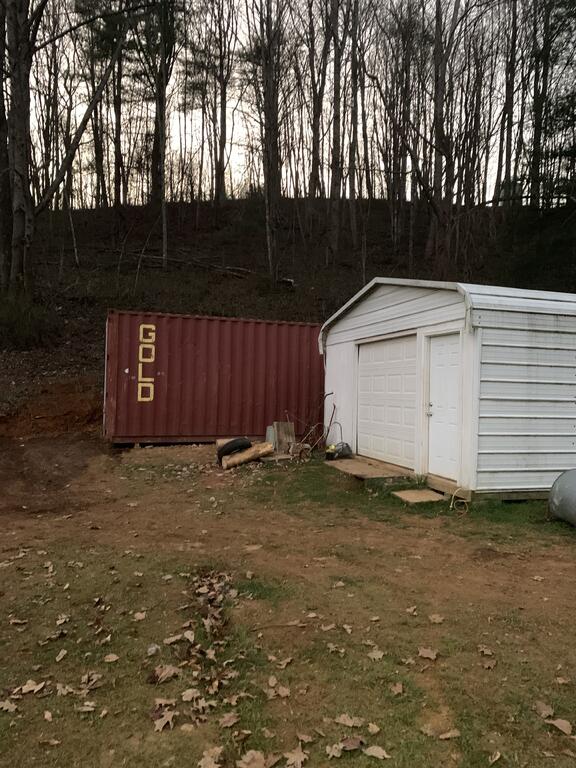

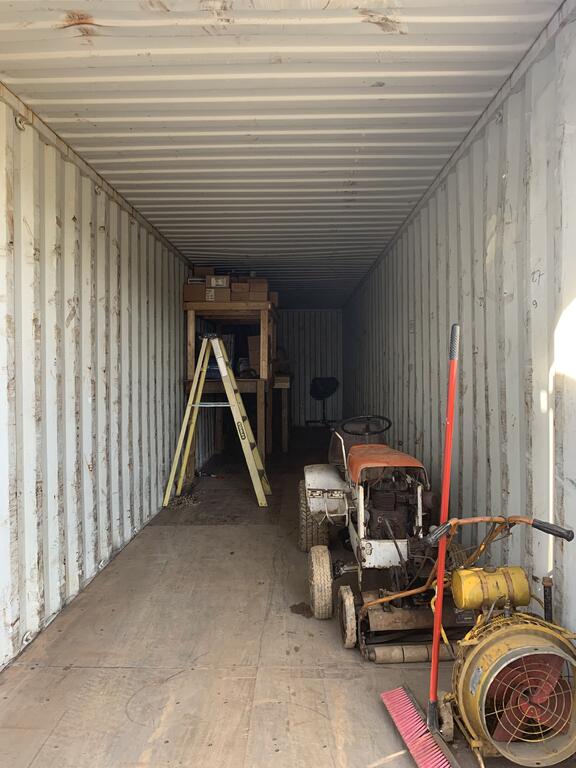

Mike in NC 342 #26 Posted March 1, 2021 Here is my storage and work shop. The workshop is an 18 X 20 carport that I added front and rear walls to. Storage is an 8' X 40' X 9'6" shipping container. 8 1 Share this post Link to post Share on other sites

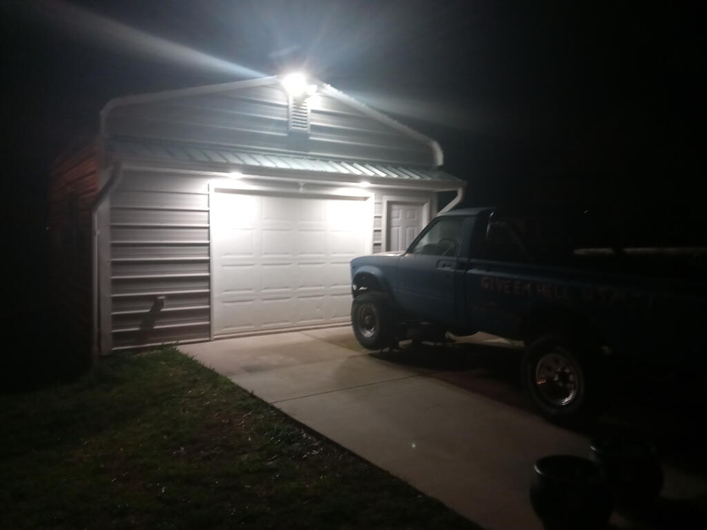

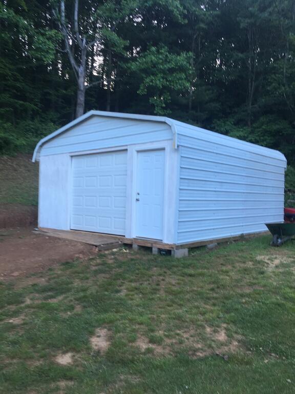

Horse Newbie 7,405 #27 Posted March 2, 2021 I have a 24 x 24 attached garage that's dedicated to the wife's car and house junk...so no pics. My shop is a 20 x 20 double carport that I converted to 8 ft walls. I built the foundation walls, filled with pit gravel, and had a concrete man do the floor with slick finish. It has a 9 x 7 roll up door, 36 inch entry door, 100 amp service, 2 windows, heat and air, attic storage, epoxy floor, 12 x 20 concrete pad out front. Storage shed attached to back. My storage shed is 16 x 12, sitting on 9 - 2 ft x 2 ft concrete pillars. It is wired with 20 amp service for 4 LED shop lights and 6 receptacles for battery tenders, or what not. 5 3 Share this post Link to post Share on other sites
WHX?? 57,390 #28 Posted March 2, 2021 That is slicker than snot on a door knob Newbie ....Gives me some ideas. Not a big fan of horizontal steel but get why it's done. 1 Share this post Link to post Share on other sites

Horse Newbie 7,405 #31 Posted March 2, 2021 36 minutes ago, WHX24 said: Not a big fan of horizontal steel but get why it's done. I would prefer vertical on the roof panels...I noticed that with the "v's" in the metal panels running horizontal, water may run under the front and back edges, and run inside the walls. I remedied this by caulking along where the roof panels met the outside walls. One other thing is 1 or 2 of the screws in the roof want to leak, even though I bought new screws with rubber washers. I fixed that by putting aluminum roof coating on the roof. I also added the awning across the front to keep the rain from splashing on my doors and blowing in so bad... Share this post Link to post Share on other sites
Pollack Pete 2,273 #32 Posted March 2, 2021 1 hour ago, Horse Newbie said: I would prefer vertical on the roof panels...I noticed that with the "v's" in the metal panels running horizontal, water may run under the front and back edges, and run inside the walls. I remedied this by caulking along where the roof panels met the outside walls. One other thing is 1 or 2 of the screws in the roof want to leak, even though I bought new screws with rubber washers. I fixed that by putting aluminum roof coating on the roof. I also added the awning across the front to keep the rain from splashing on my doors and blowing in so bad... I forgot to mention.........all my buildings here have vertical installed roof panels.Rain and snow would have a hard time flowing up and over the ridges in the tin. 1 Share this post Link to post Share on other sites
Horse Newbie 7,405 #33 Posted March 2, 2021 6 minutes ago, Pollack Pete said: I forgot to mention.........all my buildings here have vertical installed roof panels.Rain and snow would have a hard time flowing up and over the ridges in the tin. Correct... And with a light to medium rain, the water runs off the front and back mainly with horizontal panels...the main reason I added the awning on front. Now I can have the roll up door open with rain... Share this post Link to post Share on other sites

Horse Newbie 7,405 #35 Posted March 2, 2021 2 minutes ago, lynnmor said: Vertical siding is kind of self cleaning as well, rain just flushes debris off, horizontal not so much. That is true... Part of the reason I rebuilt the carport as a building, going back horizontal, was an economics factor...if I had went vertical, even though I could have used most of the original material, I still would have had considerable waste and had to purchase more new panels. I definitely considered vertical, but by going back horizontal, I only had to buy material for the front and back... Share this post Link to post Share on other sites

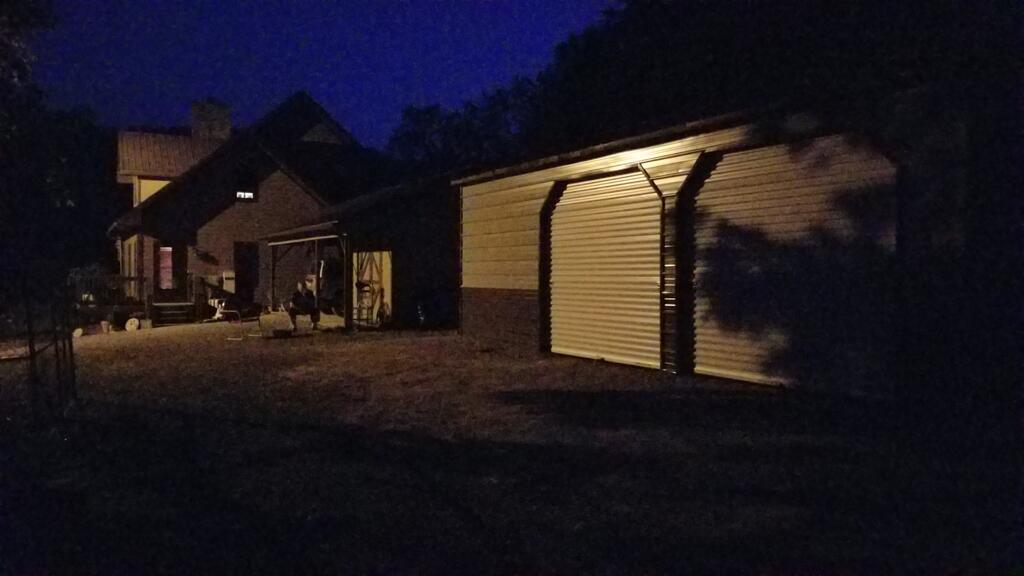

WVHillbilly520H 10,378 #39 Posted March 2, 2021 The only reason I went the horizontal was budget constraints at the time, I needed a building put up and that's what I could afford hence no doors, original plan was vertical until the county shut me down on my first building permit request as the new building codes increased my load bearing requirements increased the material cost, so beef up frame work and go to horizontal panels put me back in budget. If we ever get to the point of affording a real garage it will be concrete floor and vertical panelled, doors and electricity ect. 2 Share this post Link to post Share on other sites
seuadr 490 #40 Posted March 4, 2021 man, that is a nice setup! i am considering a shipping container for property we are building on - for our needs and our budget, we are probably NOT going to be able to have a shop space for me right away - a shipping container would at least keep my equipment out of the weather. I've got a few 4 wheel tractors, a couple 2 wheel tractors and a crap top of other random equipment that i wanna keep safe and secure. how was the process of getting it? they make it sound pretty painless. Share this post Link to post Share on other sites

19richie66 17,930 #42 Posted March 5, 2021 6 hours ago, seuadr said: man, that is a nice setup! i am considering a shipping container for property we are building on - for our needs and our budget, we are probably NOT going to be able to have a shop space for me right away - a shipping container would at least keep my equipment out of the weather. I've got a few 4 wheel tractors, a couple 2 wheel tractors and a crap top of other random equipment that i wanna keep safe and secure. how was the process of getting it? they make it sound pretty painless. The guy I bought my containers from back them right into place and slid them off his trailer. Just depends on how much room you have around where you put it as to how hard it is to get it there. I plan on putting shelves in the back of mine, 8’ wide by 2’ deep. Mine are high cubes with 9’6” ceilings. I will go 5’ high with first shelf and then 7’ or 8’ high with the second. Plenty of parts storage with those and open under the bottom for larger items you don’t need to get to all the time. Take it from me.... if there is something you think you may need or want, don’t put it in the back Lowes sells 1/2” and 3/4” foam insulation board that can be glued to the sides and ceiling for better temperature control. I cut out the factory vents and installed larger screens and covers. They can be bought but I like making things. 5 2 Share this post Link to post Share on other sites

Handy Don 16,944 #44 Posted March 6, 2021 On 3/4/2021 at 7:39 PM, 19richie66 said: The guy I bought my containers from back them right into place and slid them off his trailer. Just depends on how much room you have around where you put it as to how hard it is to get it there. Don't look now, but containers are a hot commodity at the moment. The only ones readily available are no longer usable for shipping due to damage. The damage may not affect your planned use, but take care to ask questions! 1 Share this post Link to post Share on other sites

19richie66 17,930 #46 Posted March 6, 2021 (edited) I got my containers last year as I needed instant storage and had no time or way to build anything. I must say, the guy I delt with picked me out two nice ones. Couple of dents but no leaks. Little bit of rust at the door hinges but it is all minor. Great for my plans. Edited March 6, 2021 by 19richie66 3 Share this post Link to post Share on other sites

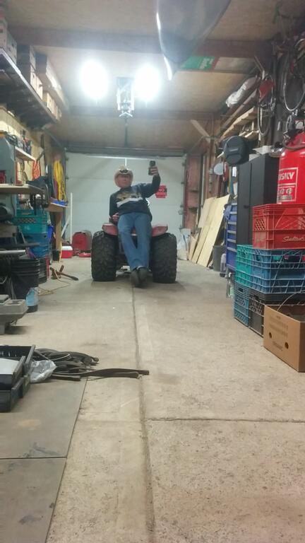

MikMacMike 494 #48 Posted May 4, 2021 Wow all these ever so excellent shops. I find it so cool how everyone has such wicked Ideas too. Here is an older shop pic, Ill try to put a newer one soon. As you can see it was miller time LOL. 2 1 Share this post Link to post Share on other sites

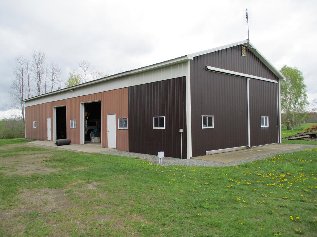

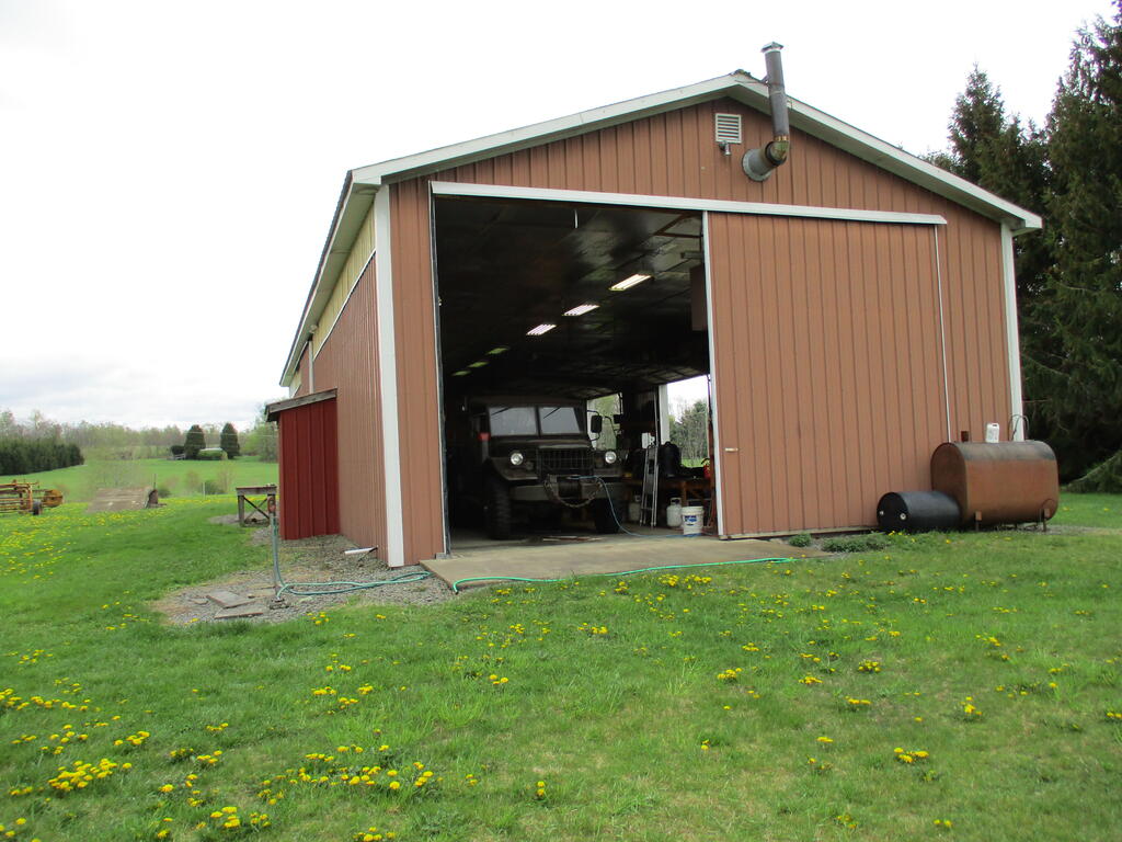

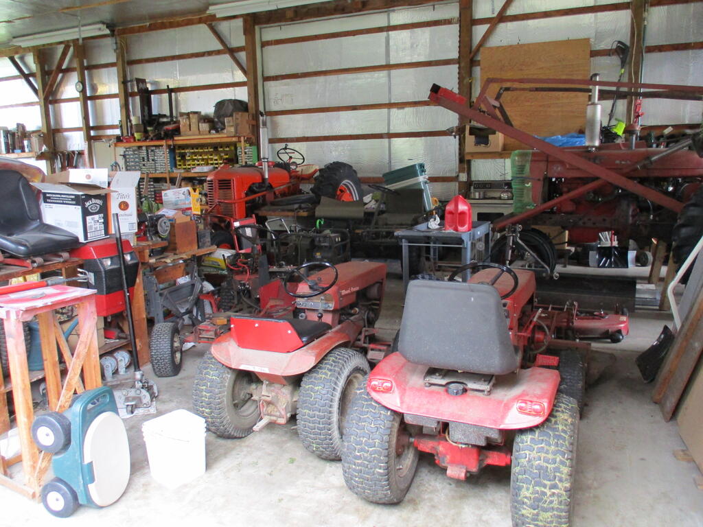

pfrederi 20,870 #50 Posted May 4, 2021 Go Big!!! 30x84 and not big enough, More WHs and toys stored in the barn down the hill and 7 more in the wooden shed up the hill. 2 4 Share this post Link to post Share on other sites
