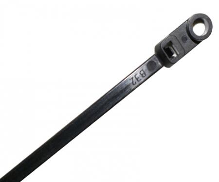

Zeek 2,299 #1 Posted February 27, 2021 So my neighbor wants me to rewire her horse trailer for a trip out of state. That means from the plug in the front all the way back to the new tail lights. I do not need to wire the brakes, just two tail lights and the two front yellow side markers. Since it's enclosed I can run the wire down along the inside along the roof line as opposed to the underside. I can get the kit and all I need and I know how to do the actual wiring. My question is fastening (quickly) the wiring from front to rear which is 24'. The roof/sides are attached directly to the crossmembers with literally NO space to slide a ziptie through, nothing to loop around. I was considering this ziptie with self-tapping screws. Any other ideas from this resourceful bunch? 2 Share this post Link to post Share on other sites

oldlineman 1,810 #5 Posted February 27, 2021 If you don't trust the sticky in Ed' s idea you could add a zip screw in the center. I have used these in electrical equipment many times, but not sure how they would hold up in a trailer. Bob 2 1 Share this post Link to post Share on other sites

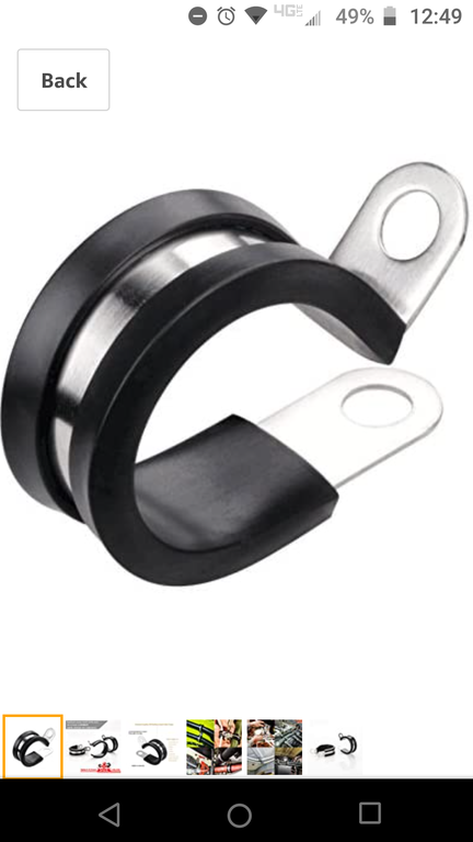

ranger 1,862 #9 Posted February 27, 2021 5 hours ago, ebinmaine said: I personally use this type of clip, or the plastic “P” clip, ( much cheaper). I’ve never had much luck with sticky clips unless they are in a clean environment and attached to a nice smooth surface away from any water / dirt/ vibration, not really possible on the underside of a trailer. Easy to fit too, using a cordless drill / screwdriver, especially when laying on your back, working overhead !!! 3 Share this post Link to post Share on other sites
