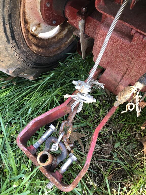

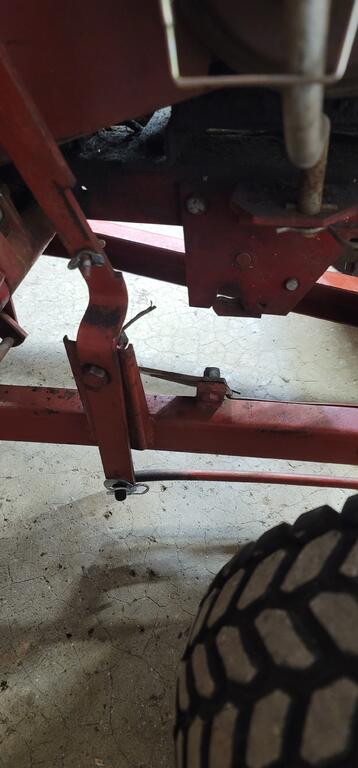

krystolo 504 #63 Posted March 8, 2021 She’s here! couple of questions to follow. this set up ok? Looks like the arm on the sleeve hitch broke off and the prior owner welded a loop. Share this post Link to post Share on other sites

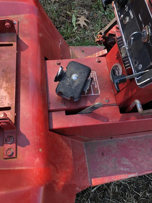

krystolo 504 #64 Posted March 8, 2021 Cup holder? 3 1 Share this post Link to post Share on other sites
krystolo 504 #65 Posted March 8, 2021 Not original 😝 1 Share this post Link to post Share on other sites
SylvanLakeWH 31,718 #66 Posted March 8, 2021 2 minutes ago, krystolo said: Cup holder? Could also be a flower pot... but I’d go with repurposed long neck holder... 3 Share this post Link to post Share on other sites
haydendavid380 759 #67 Posted March 8, 2021 (edited) 11 minutes ago, krystolo said: She’s here! couple of questions to follow. this set up ok? Looks like the arm on the sleeve hitch broke off and the prior owner welded a loop. Certainly not the way it came, but as long as the weld holds, I'd assume it'd be functional. If you wanted something cleaner and closer to original you could drill a hole in the arm, stick a small clevis through it and attach the cable to that. Edited March 8, 2021 by haydendavid380 1 Share this post Link to post Share on other sites

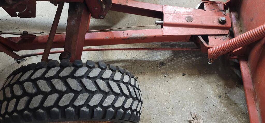

krystolo 504 #68 Posted March 8, 2021 Seems like something is missing. Does the rod coming from the dozer blade hook into something? there’s minimal downward pressure with the blade. Share this post Link to post Share on other sites

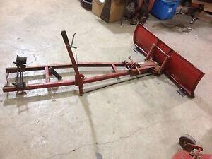

SylvanLakeWH 31,718 #69 Posted March 8, 2021 (edited) You are missing the control handle. Controls blade side to side movements... See pic. Edited March 8, 2021 by SylvanLakeWH Share this post Link to post Share on other sites
haydendavid380 759 #70 Posted March 8, 2021 2 minutes ago, krystolo said: Seems like something is missing. Does the rod coming from the dozer blade hook into something? there’s minimal downward pressure with the blade. Hold on, let me go outside and take a picture of mine. You're missing directional control. The lift mechanism can be either a chain or a bar. If it's the chain there won't be any down pressure. 2 Share this post Link to post Share on other sites
ebinmaine 79,688 #71 Posted March 8, 2021 That rod is your left/right PIVOT (word of the day there!!) There should be a handle attached. 1 1 Share this post Link to post Share on other sites
krystolo 504 #73 Posted March 8, 2021 (edited) It has a bar. Looks like it’s broken off, though. Maybe it’s supposed to go longer? Edited March 8, 2021 by krystolo Added more I fo Share this post Link to post Share on other sites
Handy Don 16,944 #74 Posted March 8, 2021 (edited) 55 minutes ago, krystolo said: She’s here! couple of questions to follow. this set up ok? Looks like the arm on the sleeve hitch broke off and the prior owner welded a loop. it looks like that cable runs over a pin in the rear rockshaft (just out of the picture at the top) and then through the tube to the mid-tractor rockshaft. Keeping it where it is: a) the cable might rub against the lower edge of the seat/tank holder bracket and/or the pin in the rear rock shaft and wear any or all due to the friction, b) the angle gives you a bit less lifting leverage and my guess is a bit less up/down range on the lift. That the arm broke makes me suspicious that it was suddenly (or repeatedly?) overloaded. I'd check all of the lift mechanism carefully for other damage or excess wear. Ideally, get the arm replaced by grinding off the stub and then welding on a new one (⅜ bar stock). At least the PO knew to put the cable clamps on in opposite directions! Good luck! Edited March 8, 2021 by Handy Don 1 Share this post Link to post Share on other sites
Pullstart 70,695 #75 Posted March 8, 2021 I’d say the height of the lift arm on that rear hitch is slightly critical for proper operation and as @Handy Don mentioned, to keep it rubbing in the wrong places. Congrats on your new arrival! Share this post Link to post Share on other sites
