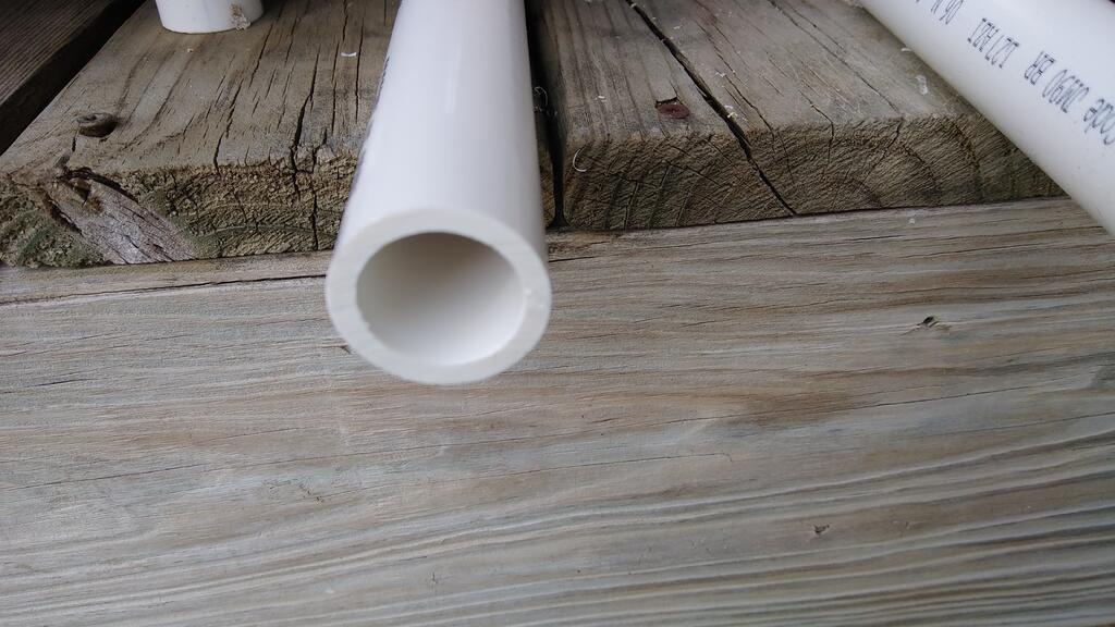

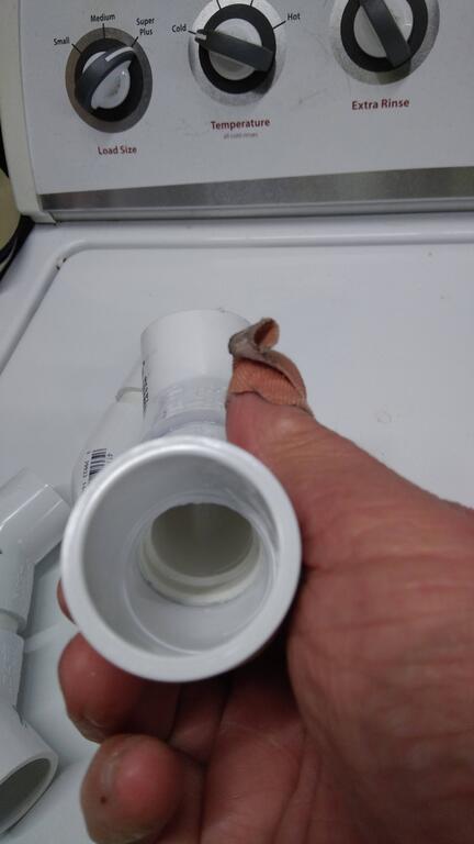

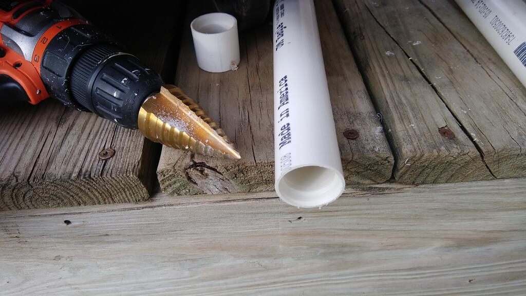

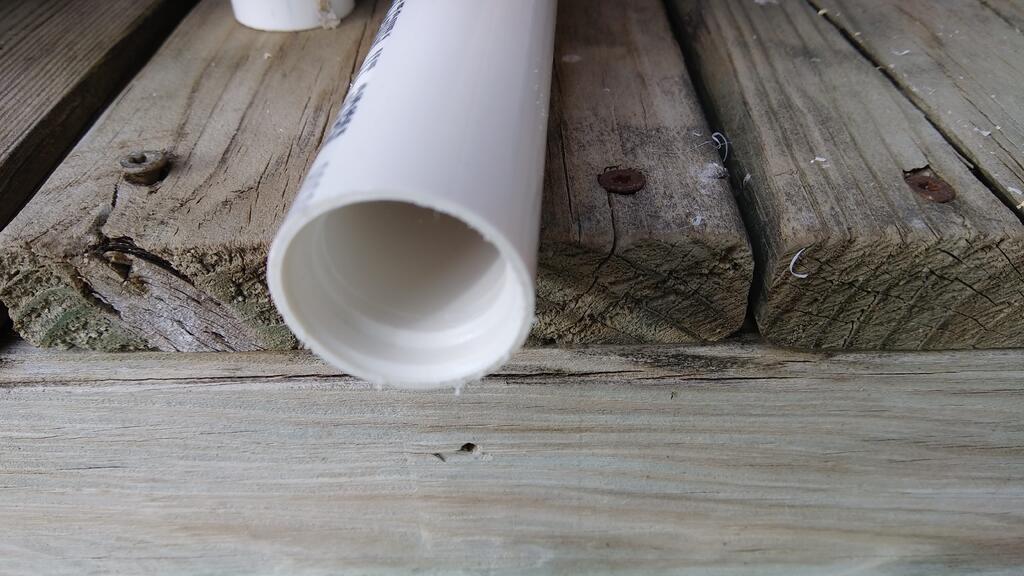

RandyLittrell 3,946 #1 Posted February 26, 2021 (edited) Ok, sorry to keep asking questions! I am installing a sanicompact toilet with built in macerator in the basement. It has a 9' head height and 120' run ability and I am way under that. But my issue is, it calls for 1" waste lines with long sweep DWV elbows. They don't have them local and I can't even find them online. 1 1/2" in the smallest. The directions say you can use two 45's instead of a 90 if the long sweep is not available. I don't know why the heck they recommend something you can't buy. Anyway, what I have done is bevel the leading edge of the schedule 40 pipe in the direction of flow. Is this okay? Am I just being a worry wort? This toilet will never see many solids so I guess I am not too worried about, but I do tend to worry about stuff that doesn't need worrying about!! Here is a link to the manual and some pics, lets hear the verdict! https://www.saniflo.com/us/home/74-sanicompact.html Edited February 26, 2021 by RandyLittrell Share this post Link to post Share on other sites

DennisThornton 4,773 #11 Posted February 27, 2021 15 hours ago, RandyLittrell said: Ok, sorry to keep asking questions! I am installing a sanicompact toilet with built in macerator in the basement. It has a 9' head height and 120' run ability and I am way under that. But my issue is, it calls for 1" waste lines with long sweep DWV elbows. They don't have them local and I can't even find them online. 1 1/2" in the smallest. The directions say you can use two 45's instead of a 90 if the long sweep is not available. I don't know why the heck they recommend something you can't buy. Anyway, what I have done is bevel the leading edge of the schedule 40 pipe in the direction of flow. Is this okay? Am I just being a worry wort? This toilet will never see many solids so I guess I am not too worried about, but I do tend to worry about stuff that doesn't need worrying about!! Here is a link to the manual and some pics, lets hear the verdict! https://www.saniflo.com/us/home/74-sanicompact.html I'm no plumber but I've plumbed supply and waste and managed a hardware store for years but I've never seen that done before. Share this post Link to post Share on other sites
RandyLittrell 3,946 #12 Posted February 27, 2021 (edited) 7 minutes ago, DennisThornton said: I'm no plumber but I've plumbed supply and waste and managed a hardware store for years but I've never seen that done before. Well the dwv fittings I looked at were made is in such a way as too not have any lip inside the fitting to not catch solids and such, so I thought I would bevel the inside of the pipe to help with that since I couldn't find any long sweep fittings in 1" locally. This toilet will never see many "solids" so I am sure it will be fine. I wish I could have found the right ones, but I guess we will see if this works or not! Randy Edited February 27, 2021 by RandyLittrell Share this post Link to post Share on other sites
DennisThornton 4,773 #13 Posted February 27, 2021 3 minutes ago, RandyLittrell said: Well the dwv fittings I looked at were made is in such a way as too not have any lip inside the fitting to not catch solids and such, so I thought I would bevel the inside of the pipe to help with that since I couldn't find any long sweep fittings in 1" locally. This toilet will never see many "solids" so I am sure it will be fine. I wish I could have found the right ones, but I guess we will see if this works or not! Randy Never seen anyone make their own! Clever idea! 1 Share this post Link to post Share on other sites
