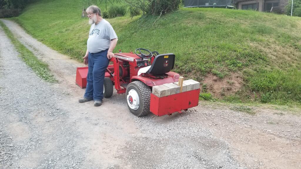

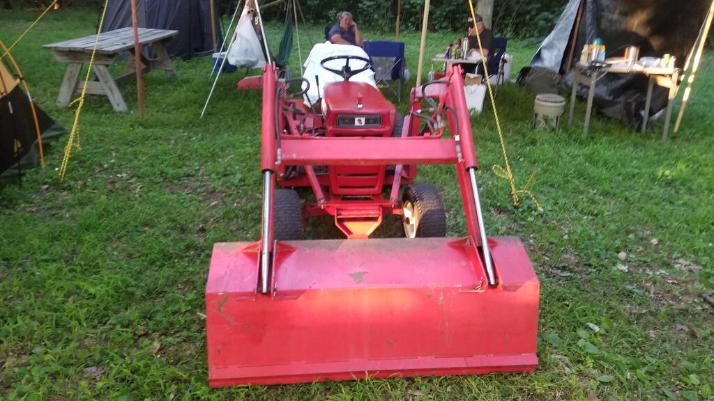

Wheel Horse 3D 3,826 #107 Posted June 27, 2021 K Dug is finally officially Dig Dug! 4 1 Share this post Link to post Share on other sites
Wheel Horse 3D 3,826 #108 Posted June 27, 2021 Next steps! Front spindle upgrade Wide rear installation with spacers Steering upgrade?? (Some of the steering stifness is due to no weight currently in the box.) 1 Share this post Link to post Share on other sites

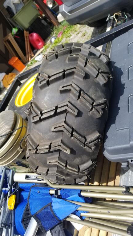

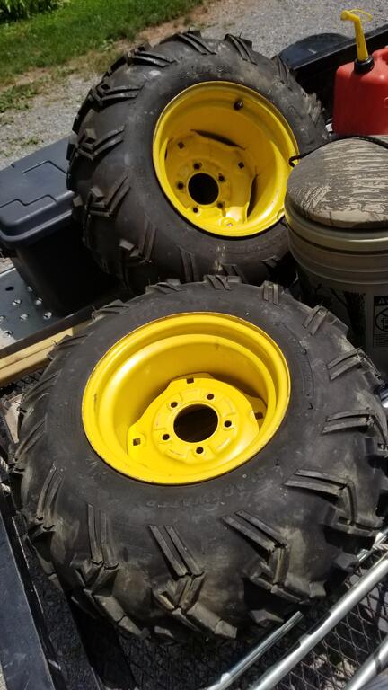

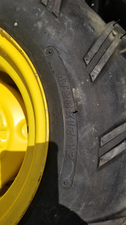

Wheel Horse 3D 3,826 #109 Posted June 27, 2021 New rear tires! 1 3 Share this post Link to post Share on other sites

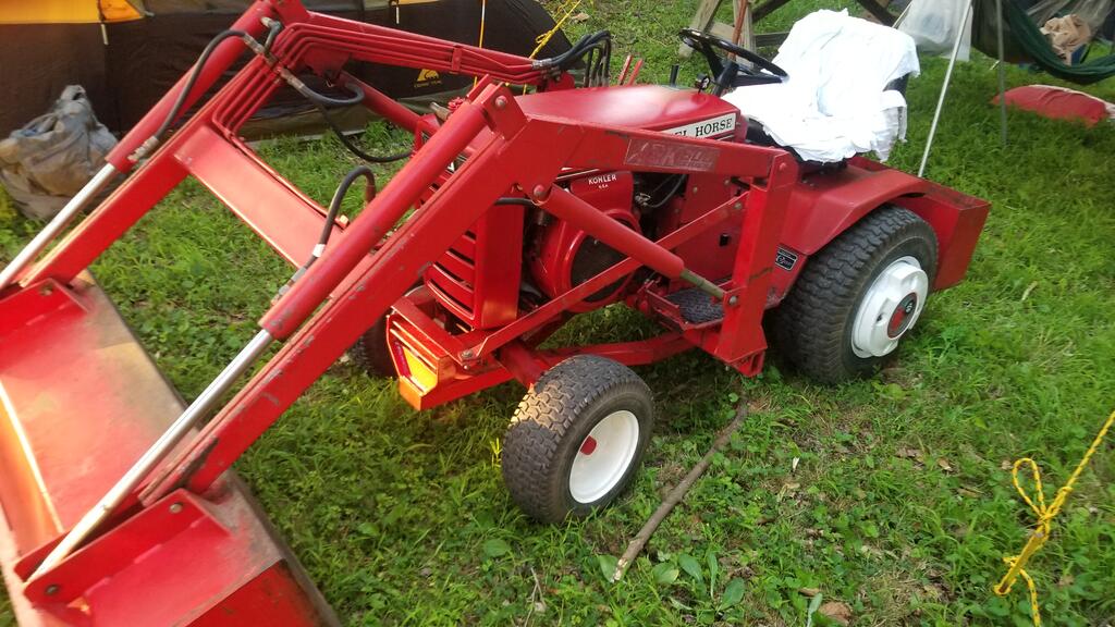

Wheel Horse 3D 3,826 #113 Posted June 28, 2021 Some other tweaks and mods... Replace shaker mounts with something non-shaker I had noticed a rub/buzz that happened at certain times especially when leaning to the right. It went away after @pullstart and I did a little modification to be sure the pump pulley cleared properly. I'm sure it was due to flex in the shaker mounts and I can see that flex when engaging the pump. Check and shim any play out of the steering system Do SOMETHING with the seat lol. 1 Share this post Link to post Share on other sites
Pullstart 71,291 #114 Posted June 28, 2021 I wouldn’t worry too much about the seat, unless you go full on dig/dug hoe turn table seat... Share this post Link to post Share on other sites
Wheel Horse 3D 3,826 #115 Posted June 28, 2021 Just now, pullstart said: I wouldn’t worry too much about the seat, unless you go full on dig/dug hoe turn table seat... Haven't decided turntable or flip over back. But the current one is still sticky from the flex seal attempt! Worked great at sealing the cracks, but everywhere else just didn't cure right. 1 Share this post Link to post Share on other sites
Pullstart 71,291 #116 Posted June 28, 2021 9 minutes ago, Wheel Horse 3D said: Haven't decided turntable or flip over back. But the current one is still sticky from the flex seal attempt! Worked great at sealing the cracks, but everywhere else just didn't cure right. Look at this guy... strong back and weak mind! Already forgot about that! What about another heavy coat of it to super flex seal it? Share this post Link to post Share on other sites
Wheel Horse 3D 3,826 #117 Posted June 28, 2021 Just now, pullstart said: What about another heavy coat of it to super flex seal it? That may work and would be an easy temp fix. Just gotta be sure to go thick all over i guess 1 Share this post Link to post Share on other sites

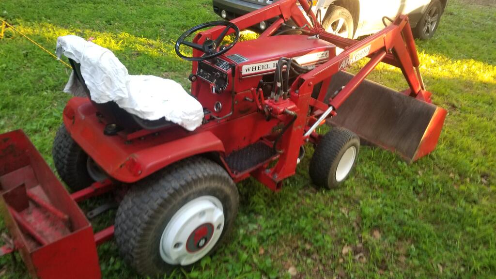

Wheel Horse 3D 3,826 #119 Posted June 29, 2021 Dug and Dad gettin a little work done! 1 1 Share this post Link to post Share on other sites

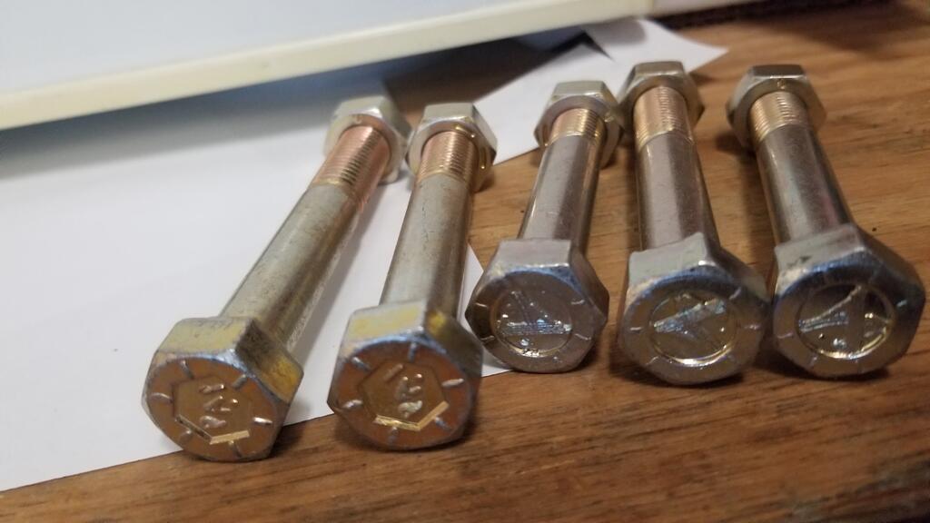

Wheel Horse 3D 3,826 #120 Posted June 29, 2021 Got the bucket pivots replaced and those bolts worked perfectly! So now Im gonna replace the other pivots and add in washers wherever needed to remove a bit of wiggle in there. 2 1 Share this post Link to post Share on other sites

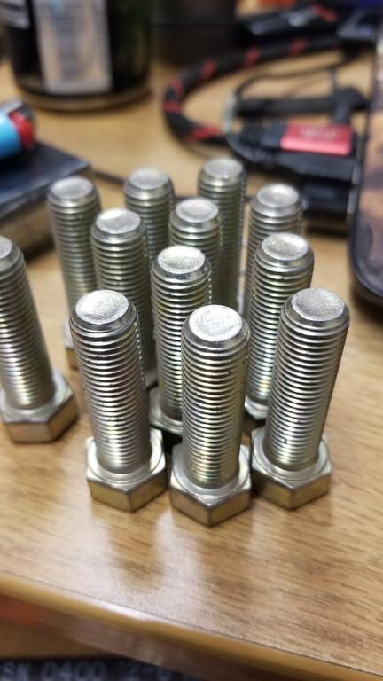

Wheel Horse 3D 3,826 #124 Posted June 30, 2021 Grade 8 7/16 x 20 1.5" for lug nut switch over. 1 Share this post Link to post Share on other sites
