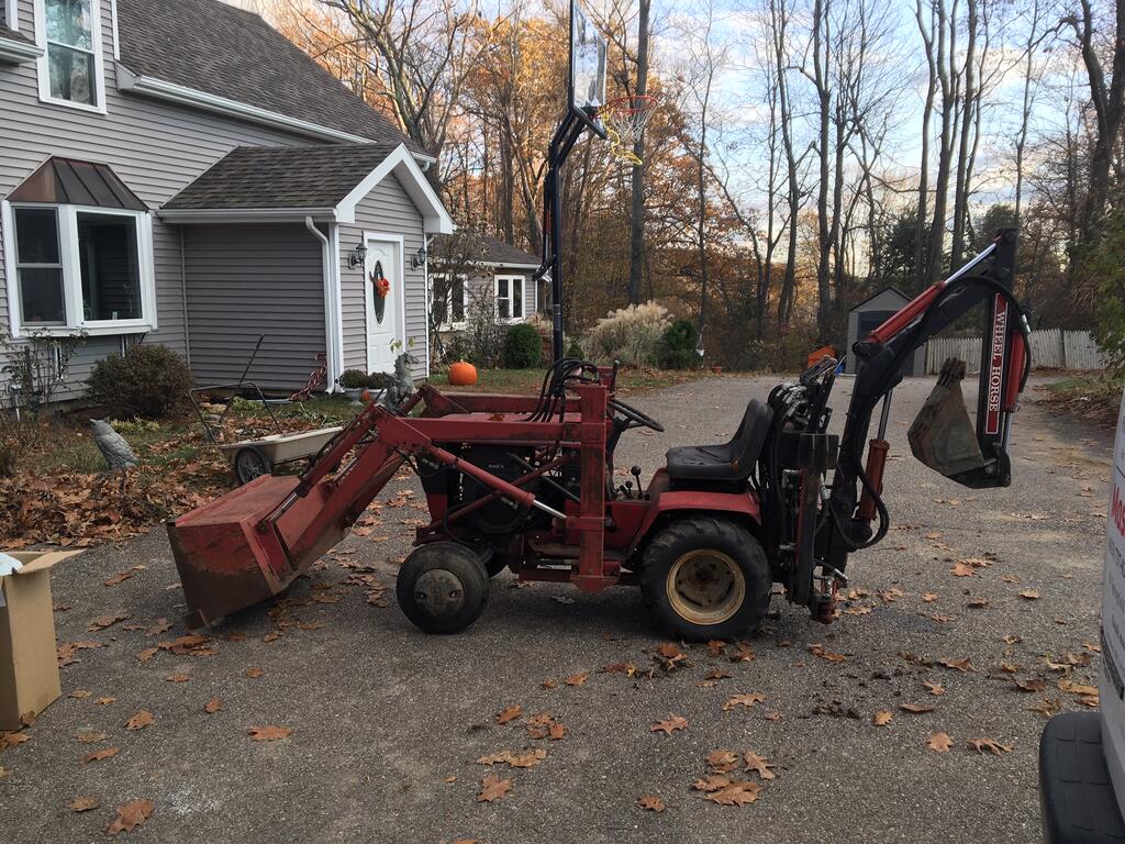

wallfish 20,619 #29 Posted February 26, 2021 Correct, mine was built using PF Engineering plans. On a 416-8 with an Ark loader. It dug a trench 4 1/2 ft deep and about 150 ft long to bury my utilities. Trust me, it wasn't through beach sand either as it's definitely a bit boney up here in New England. It did rip the stabilizers off once. Anything is better than a shovel! The wife stopped asking me to help her with her plants because out came the hoe for smallest of holes. LoL Keep an eye out on craigslist and stuff for small back hoes. I've seen a couple for sale around here that are a tow behind type but look easy to adapt to a garden tractor because they were small. Half the work is already done if you can't build from scratch. 2 Share this post Link to post Share on other sites
Wheel Horse 3D 3,826 #30 Posted February 26, 2021 22 minutes ago, wallfish said: The wife stopped asking me to help her with her plants because out came the hoe for smallest of holes. LoL Sounds about right ...and i am not paying attention to ANY of the rhyming or puns there. 1 Share this post Link to post Share on other sites
DennisThornton 4,773 #31 Posted February 26, 2021 16 minutes ago, wallfish said: Correct, mine was built using PF Engineering plans. On a 416-8 with an Ark loader. It dug a trench 4 1/2 ft deep and about 150 ft long to bury my utilities. Trust me, it wasn't through beach sand either as it's definitely a bit boney up here in New England. It did rip the stabilizers off once. Anything is better than a shovel! The wife stopped asking me to help her with her plants because out came the hoe for smallest of holes. LoL Keep an eye out on craigslist and stuff for small back hoes. I've seen a couple for sale around here that are a tow behind type but look easy to adapt to a garden tractor because they were small. Half the work is already done if you can't build from scratch. Tractor, FEL and backhoe! Life changing! Stumps! Big rocks! Move trees! Dig ditches! A man with land needs hydraulic power! (Several years back a NH TC35 with FEL, backhoe and attachments found its way here, thank goodness! But I'd still like something smaller. You know, for rose bushes!) How was it to steer with a full bucket? Recommended stance for a small FEL/backhoe is to have EVERYTHING gripping the ground. Did the backhoe still drag it around? I hate to ask how long it took but, would you do it again? And is there a simple way to explain or describe how the backhoe was mounted. I knew you did this and perhaps I've commented, but just in case, AWESOME! 1 Share this post Link to post Share on other sites
wallfish 20,619 #32 Posted February 26, 2021 12 minutes ago, DennisThornton said: Did the backhoe still drag it around? It's strong enough to pull it around but getting used to the bite size makes it better I hate to ask how long it took but, would you do it again? I did it over 2 summers. Evenings and weekends and any other available time. Finished it in 08. I would certainly do it again. It was a fun build and has practical use. Plenty of mods made to the plans but the biggest thing I would do different is angle the stabilizers back 45 deg. The next mod (which can still be done) is make the boom extend And is there a simple way to explain or describe how the backhoe was mounted. A frame was made to attach to the trans with 1/2" plate on the top, angle steel to the axle and supports down to the hitch pin. That was welded to 4" angles to create a flat rectangle facing back. The frame for the hoe attaches to that rectangle with four 3/4" pins through tabs welded to each frame. I knew you did this and perhaps I've commented, but just in case, AWESOME! Thanks! 2 2 Share this post Link to post Share on other sites
DennisThornton 4,773 #33 Posted February 26, 2021 4 minutes ago, wallfish said: My NH will drag itself around too if I want. I think that is a good thing, well, until it happens when I don't want it. Unless I'm stuck! I'm glad that it has that much power then! I'd love to have a smaller BH but I just don't seem to have the time to be building from scratch. And, of course, I have a much bigger one and get by, but at times it's over kill. So securely mounted to the trans. OK. Was wondering if it went past that sometimes failing frame to trans mount. No issues so far? Long ago, I thought having a Teramite would be mindblowing! And having this TC35 with FEL and BH has been a life altering event! But I'd still like to have a smaller version. Occasionally I'd like a larger one. I installed a complete septic and I could have used bigger for the tank, but was fine for the rest. I have a couple of boulders and the occasional huge stump that tasks me but... Seems now I need something that makes less of a mess, smaller holes and less damage. Incredible build! Keep it up! (How about a WH with tracks?) 1 Share this post Link to post Share on other sites
roadapples 6,987 #34 Posted February 27, 2021 Mine attaches a little different than John's. Those front legs attach at the mid attachamatic. They had to be shortened. Made for D250. They run along side the base frame for the loader and pieces were added to fasten to the rear axle housing. 2 4 Share this post Link to post Share on other sites
wallfish 20,619 #35 Posted February 27, 2021 53 minutes ago, DennisThornton said: OK. Was wondering if it went past that sometimes failing frame to trans mount. The Ark loader has a subframe that attaches from the front Tach a matic to the trans axle on the bottom. The frame I built for the hoe attaches to the top and they pinch together on the square of the trans case axle. Without the loader subframe it would probably destroy that frame to trans mount fairly quick 1 2 Share this post Link to post Share on other sites

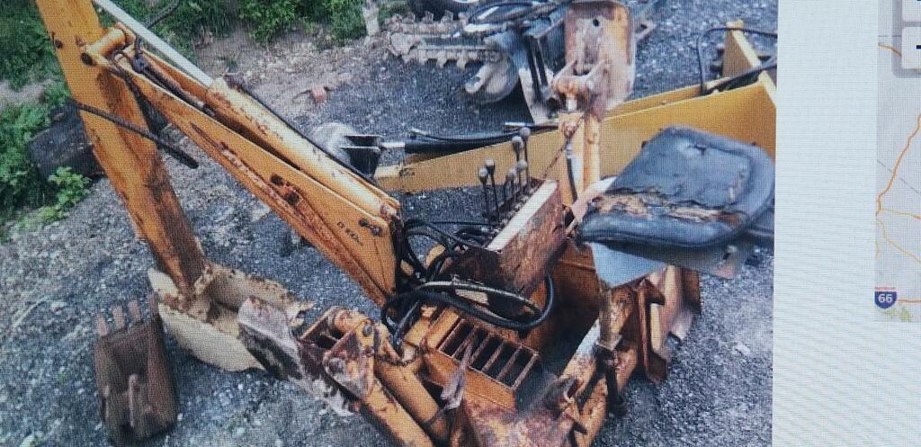

Wheel Horse 3D 3,826 #41 Posted March 24, 2021 Everyone keep an eye out for a backhoe for me. Looks like thats gonna be a bear to find. I saw one posted up in pa but never got a response. Looking for a Brantly similar to @roadapples (LD6?) or SOMETHING. The home builts I've seen from PE are nice like @wallfish, but I'm gonna need a hoe! So keep yer ears(eyes, keyboards, whatever) open for any word of a backhoe for one o these critters! 3 Share this post Link to post Share on other sites
Wheel Horse 3D 3,826 #42 Posted March 24, 2021 (edited) Id HATE to have to buy something green of the 400 variety just to strip the hoe off it lol! Really looking for that frame attachment rather than 3pt style. Edited March 24, 2021 by Wheel Horse 3D Share this post Link to post Share on other sites

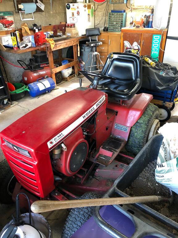

Wheel Horse 3D 3,826 #47 Posted March 29, 2021 K found a possible tractor candidate. Any thoughts? Supposed to run well no smoke etc. 2 Share this post Link to post Share on other sites
ebinmaine 80,760 #48 Posted March 29, 2021 11 minutes ago, Wheel Horse 3D said: K found a possible tractor candidate. Any thoughts? Supposed to run well no smoke etc. Tough to beat a C series. Looks even paint patina. Any details? May want to start a separate thread... Get some good advice. 1 Share this post Link to post Share on other sites
