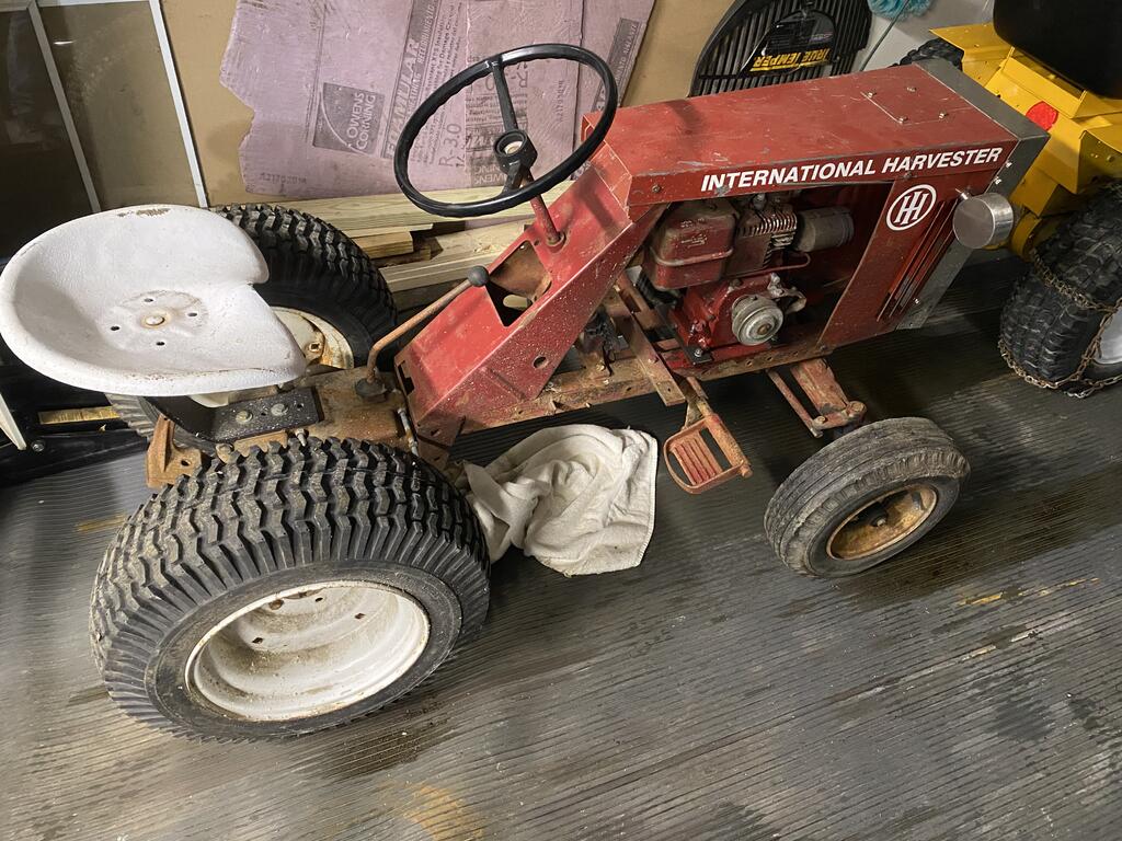

Prin2020 9 #1 Posted February 26, 2021 I Picked this up last night can anyone tell me the year and model? I cant find anything stamped on it! Thanks much jeff 1 1 Share this post Link to post Share on other sites
The Tuul Crib 7,354 #2 Posted February 26, 2021 8 minutes ago, Prin2020 said: I Picked this up last night can anyone tell me the year and model? I cant find anything stamped on it! Thanks much jeff That's pretty dang cool! I'm going to take a stab at it and say maybe mid 60s? to Share this post Link to post Share on other sites
Prin2020 9 #3 Posted February 26, 2021 Thats what i was thinking. I picked it up for 100 needs some work to get her to roll. But the engine fired up last night hahaha 3 Share this post Link to post Share on other sites
DennisThornton 4,773 #4 Posted February 26, 2021 That's interesting. Other's will know what year and model. Guess someone who was good with sheet metal really wanted an IH! Really like the louvers. Share this post Link to post Share on other sites
953 nut 70,354 #5 Posted February 26, 2021 It would appear to have some basic DNA but hard to tell what year or model from that one picture. Definitely a short frame so 1965 or older is my guess. The sheet metal all appears to be home brewed and the seat support didn't come from a . are there any numbers on the transmission? Share this post Link to post Share on other sites
The Tuul Crib 7,354 #6 Posted February 26, 2021 If you can put up a few more pictures. The framing in the transmission looks to be interesting Share this post Link to post Share on other sites
DennisThornton 4,773 #7 Posted February 26, 2021 Judging from the paint conditions of the frame vs the sheet metal an already old Wheel Horse, perhaps with damaged sheet metal just started to look like a IH to someone with talent and they helped it along. Good job with the new dress! Share this post Link to post Share on other sites
ebinmaine 81,156 #8 Posted February 26, 2021 Welcome to Redsquare. The shifter with its forward lean has me thinking early sixties. All custom sheet metal has stated above. I'd be very interested to see more pictures all the way around. That's a cool little piece of equipment. Share this post Link to post Share on other sites
DennisThornton 4,773 #9 Posted February 26, 2021 The more I look at the sheet metal the more impressed I am. Anyone recognize the head lamp? Share this post Link to post Share on other sites
Pullstart 71,522 #10 Posted February 26, 2021 Welcome fellow Michigander! Make sure to not run that transmission without a belt guard fashioned, or a belt stop tab system at the least. It stops the drive belt from moving. NEVER shift with the belt still moving, it’ll cause bad damage to the transmission 1 Share this post Link to post Share on other sites
Achto 32,927 #11 Posted February 26, 2021 Very cool looking tractor. Judging by the dash tower I would guess that it started out life as a 1964 model 604 or a 704. 3 Share this post Link to post Share on other sites
DennisThornton 4,773 #13 Posted February 26, 2021 16 minutes ago, Achto said: Very cool looking tractor. Judging by the dash tower I would guess that it started out life as a 1964 model 604 or a 704. I was giving the customizer credit for the dash tower as well, but with your comment and a closer look I'll have to give credit back to the Ponds for the dash tower. 2 Share this post Link to post Share on other sites

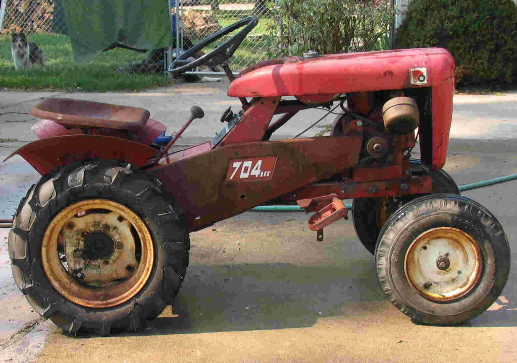

WHX?? 58,347 #14 Posted February 26, 2021 (edited) I'm with Dan ..... started out life as a 604/654 or 704 Edited February 26, 2021 by WHX24 2 Share this post Link to post Share on other sites
Achto 32,927 #15 Posted February 26, 2021 5 minutes ago, WHX24 said: I should have bought that tractor from you. Oh Well, It's in good hands now. 1 Share this post Link to post Share on other sites
ebinmaine 81,156 #16 Posted February 26, 2021 I LOVE that grill. 1 Share this post Link to post Share on other sites

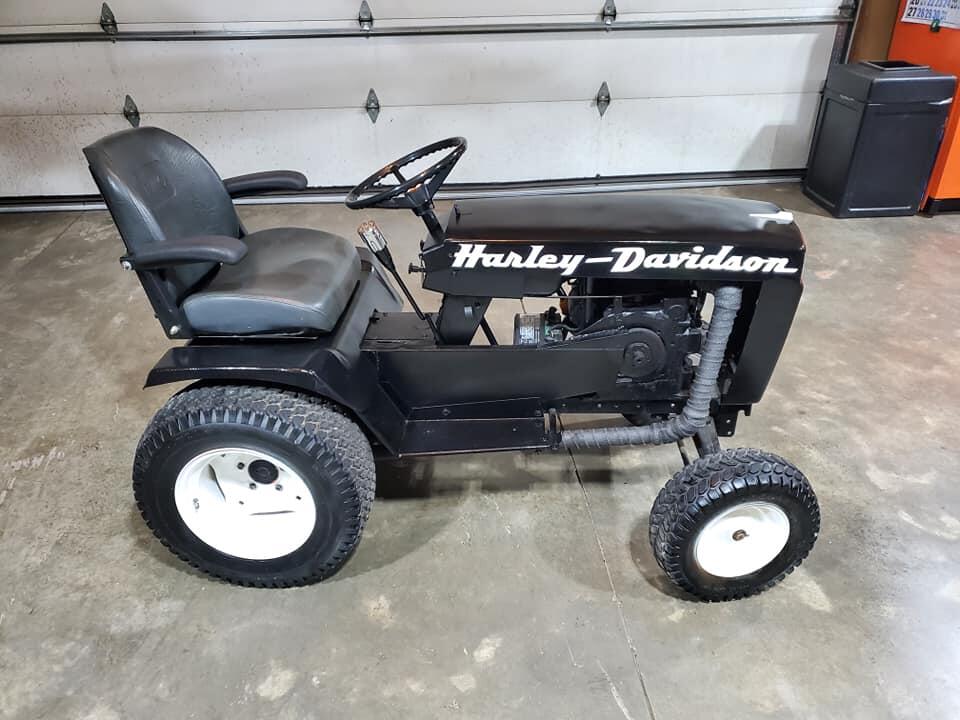

Gregor 4,848 #17 Posted February 26, 2021 Not to hi-jack a thread, but here is another, What year? What model? I probably should go get it. Worth the asking price I think, but would rather have a complete tractor. 2 Share this post Link to post Share on other sites
WHX?? 58,347 #18 Posted February 26, 2021 21 minutes ago, Achto said: should have bought that tractor from you. Shoulda never sold it! Mike @prondzy what's it look like now? 23 minutes ago, ebinmaine said: I LOVE that grill. Definitely one of a kind. 2 Share this post Link to post Share on other sites
Prin2020 9 #19 Posted February 26, 2021 Wonder if they still make parts for these. I need to figure out what i need lol. Its not all there obviously Share this post Link to post Share on other sites
Achto 32,927 #20 Posted February 26, 2021 (edited) 21 minutes ago, Prin2020 said: Wonder if they still make parts for these. I need to figure out what i need lol. For any missing sheet metal, you would be best to post a wanted add in our classified section. Transmission rebuild kits are available from https://wheelhorsepartsandmore.com/ Looks like it has a Briggs in it now, you would need a Tecumseh HH60 to make it a 604 or 654. If you wanted it to be a 704 then you would need a Kohler K161. Personally I would find or fab a belt guard for the main drive belt, find the parts for the clutch idle/tension pulley and brake linkage & enjoy it the way it is. Here is a link for the manual with exploded views and parts lists for your tractor. Edited February 26, 2021 by Achto 1 1 Share this post Link to post Share on other sites
DennisThornton 4,773 #21 Posted February 26, 2021 I'd suggest trying to find a basket case WH. Probably easier and cheaper and having spare parts around is handy! I'd get it mechanically sound and keep the altered sheet metal. 4 Share this post Link to post Share on other sites
oliver2-44 11,826 #22 Posted February 26, 2021 That one heck of a chrome or stainless front grill. As to its model and year, Its a one of a kind Frankenhorse 4 Share this post Link to post Share on other sites
Achto 32,927 #23 Posted February 26, 2021 2 hours ago, Gregor said: What year? What model? I probably should go get it. Worth the asking price I think, but would rather have a complete tractor. It looks to be a B or C series. Has some custom stuff on it but looks mostly there 1 Share this post Link to post Share on other sites
ebinmaine 81,156 #25 Posted February 26, 2021 5 hours ago, Gregor said: Not to hi-jack a thread, but here is another, What year? What model? I probably should go get it. Worth the asking price I think, but would rather have a complete tractor. What's the asking price? That's a '71/2 up to '75 like @Achto says. Looks big block. 1 Share this post Link to post Share on other sites
