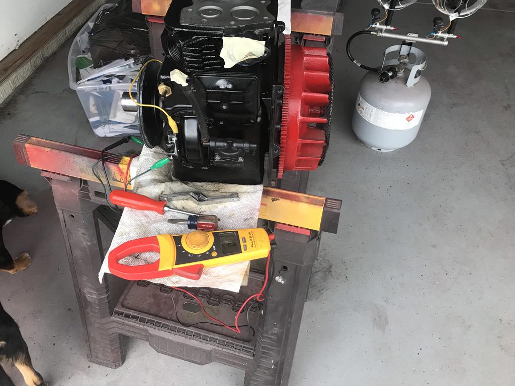

81blackhood 168 #3 Posted February 25, 2021 (edited) I used a multi meter to set my points exactly. Norm from “I Save Tractors” has a video on this. Edited February 25, 2021 by 81blackhood 1 Share this post Link to post Share on other sites
formariz 12,381 #4 Posted February 25, 2021 (edited) Is there really a point to do it with a timing gun if one cannot adjust it with engine running? How much more precise does it need to be it than with the multimeter? It just seems like a source for frustration with the constant checking after turning engine off and on. Edited February 25, 2021 by formariz 3 Share this post Link to post Share on other sites

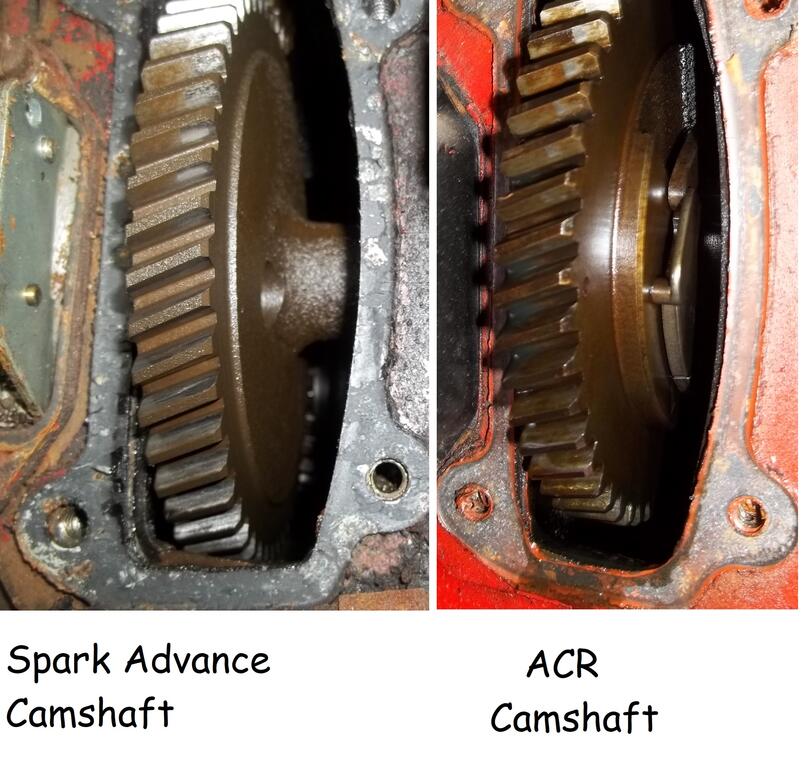

953 nut 70,323 #10 Posted February 26, 2021 5 hours ago, formariz said: Is there really a point to do it with a timing gun if one cannot adjust it with engine running? How much more precise does it need to be it than with the multimeter? It just seems like a source for frustration with the constant checking after turning engine off and on. 6 hours ago, 81blackhood said: used a multi meter to set my points exactly. If I am doing static timing I use a 12 volt test light rather than a meter, the light grabs your attention better than a meter. Gapping the ignition points at .020 has always been the standard answer to how points should be set. That probably will get you into the ballpark where the engine will run, but with a bit of additional effort you can improve the engine’s power and performance. The Kohler engine manual in the Red Square files section covers two methods for setting the ignition timing, Static Timing and using a Timing Light. This manual is a relatively new manual and it overlooks the fact that many of our engines were built prior to the ACR (automatic compression release) camshaft. Earlier engines (mostly 1965 and earlier) had a Spark Advance camshaft that can not be timed using Static timing. At rest (and very low RPMs) the timing is retarded to fire slightly after TDC. The timing mark (SP) on your flywheel is at twenty degrees before top dead center but at rest the points on these engines break about ten degrees after top dead center. The only reliable way to check or set the timing on these engines is with a timing light. There are a couple ways to determine what camshaft you have. Presuming the camshaft in your engine is the one it was born with the data plate on the engine has a suffix that can tell you what camshaft was used. The table below will tell you the suffix applicable to your engine. The other way to determine what camshaft you have is to remove the cam gear cover and take a look. If you see a mechanism attached to the cam gear it is the ACR cam. The following engines have the spark advance camshaft; K-141, Suffix prior to “C” K-161, Suffix prior to “J” K-181, Suffix prior to “D” K-241, Suffix prior to “D” 3 1 Share this post Link to post Share on other sites
