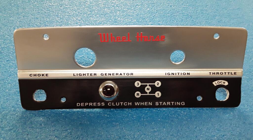

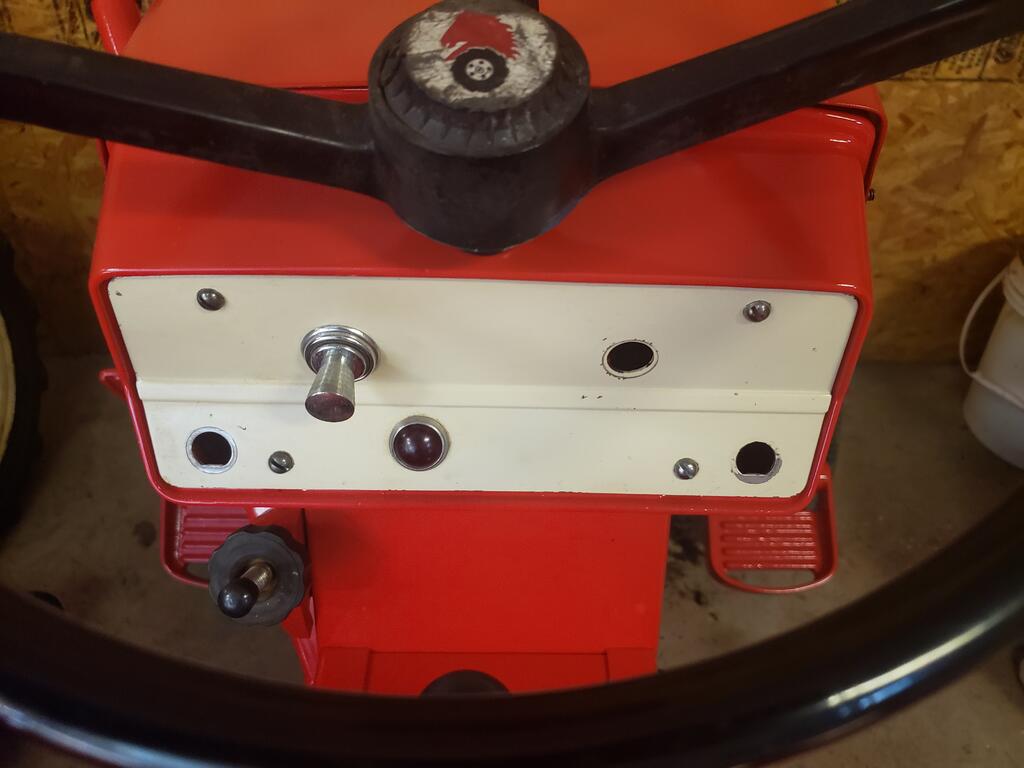

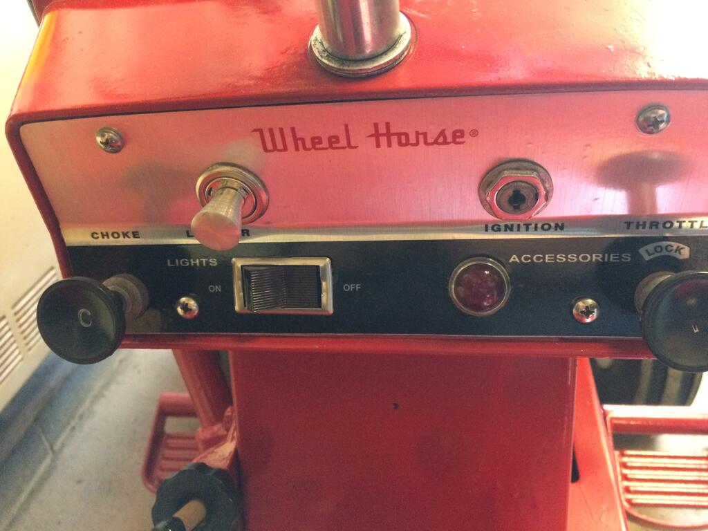

WHX?? 54,943 #3 Posted February 22, 2021 (edited) My bad ....it's a long frame Word of caution when tightening the the choke and throttles the "D" hole does not keep them from turning and you can end up with a wrinkled decal. Same with mounting screws. Ok here's a short frame Edited February 22, 2021 by WHX24 8 1 Share this post Link to post Share on other sites

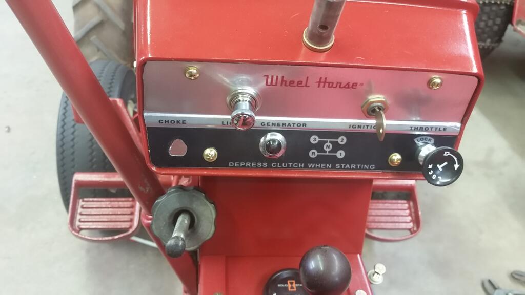

squonk 45,500 #4 Posted February 22, 2021 Long frame also: (Looks like Jim bought a gross of Allen head screws! ) 3 1 Share this post Link to post Share on other sites

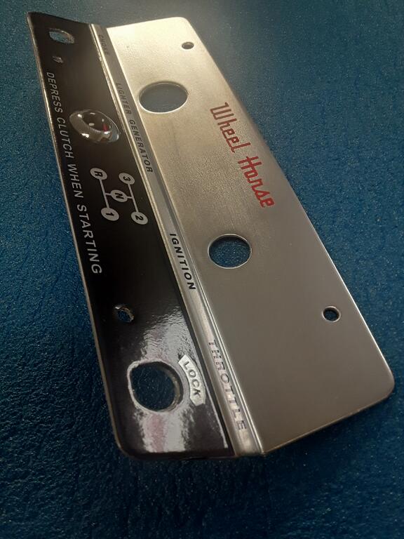

WHX?? 54,943 #5 Posted February 22, 2021 (edited) 8 minutes ago, squonk said: Looks like Jim bought a gross of Allen head screws It's a stainless/allen fetish! BTW Gordy just a shot coat of self etching and some light sanding and on goes the decal. If the dash is pitted maybe some filler primer? Might want to ask the master decaler @Achto what his method is. Edited February 22, 2021 by WHX24 Share this post Link to post Share on other sites

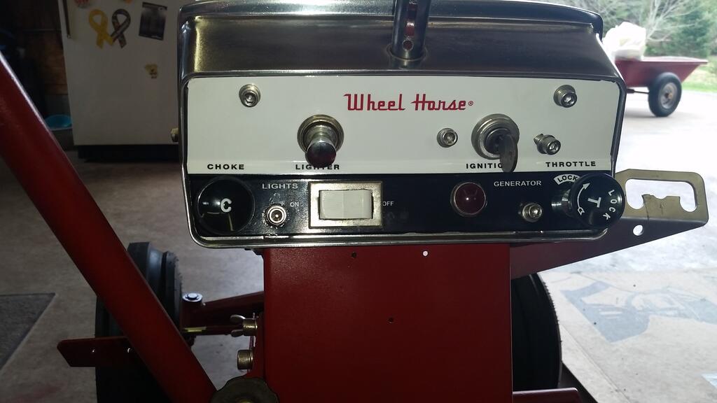

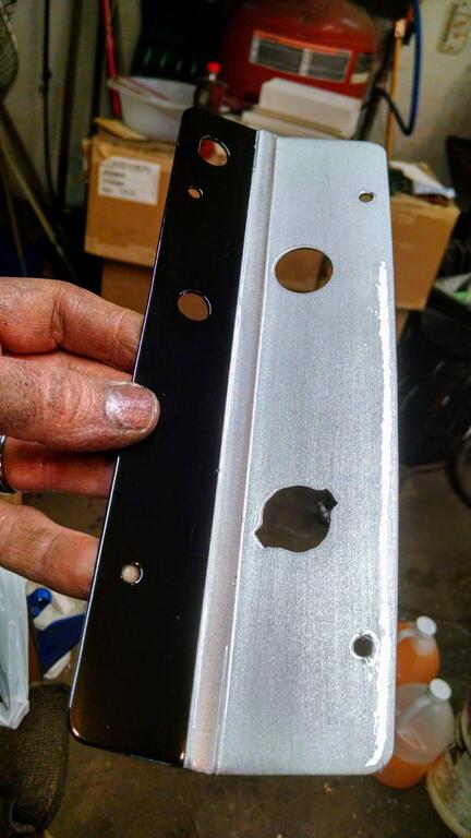

Racinbob 12,765 #6 Posted February 22, 2021 Before: After: 5 4 Share this post Link to post Share on other sites

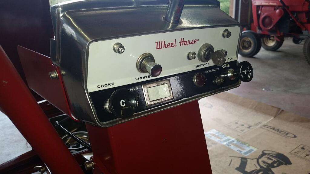

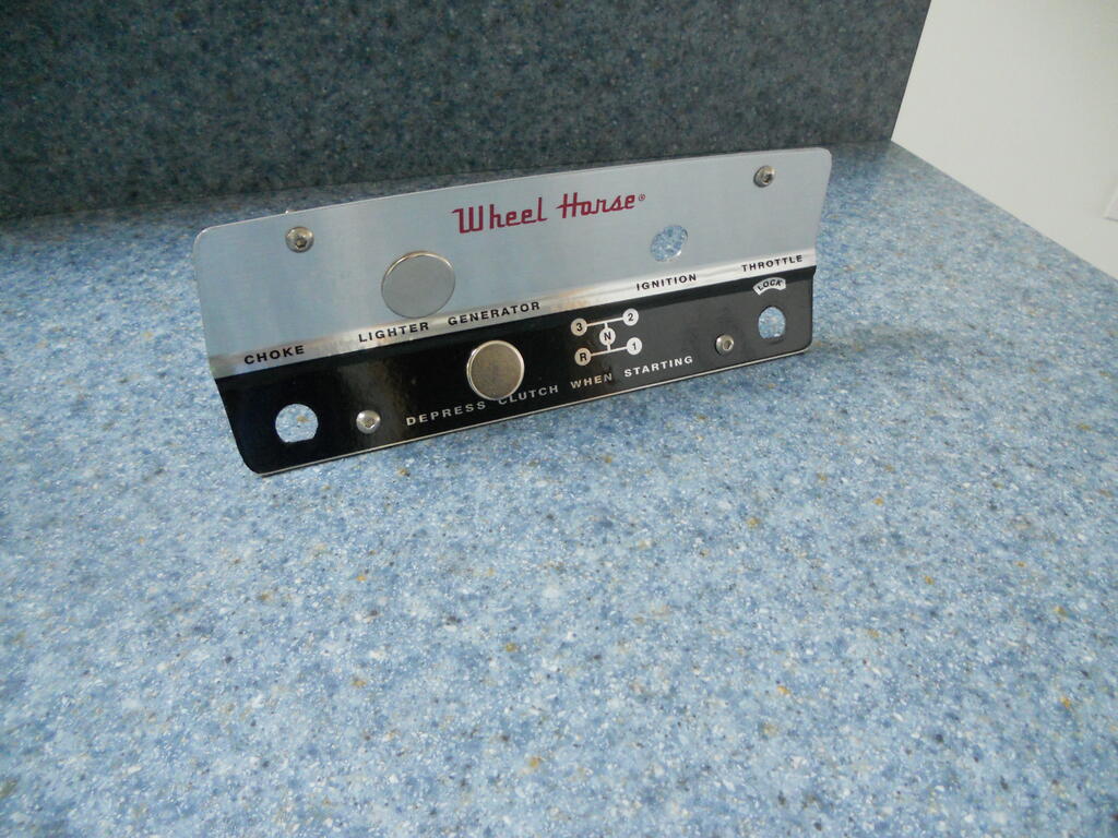

Achto 30,988 #7 Posted February 22, 2021 9 minutes ago, WHX24 said: Might want to ask the master decaler @Achto what his method is. If you get the one piece decal from Terry @Vinylguy you will only need to get a smooth paint job on the dash before installing one of his decals. It will come out looking like the one posted above by @Racinbob. if you order one of Terry's 3 piece decals then you will need to do more prep work on your dash. Either have it chromed or paint it silver. This dash has the 3 piece decal on it. To get the silver finish and make it look brushed, I painted it silver then waited for it to dry. After it dried I scuffed it with Scotch Brite making sure to only scratch in one direction, then I clear coated it. Applied decals after the clear had dried. Turned out great, looks even better in the sun. 6 4 Share this post Link to post Share on other sites

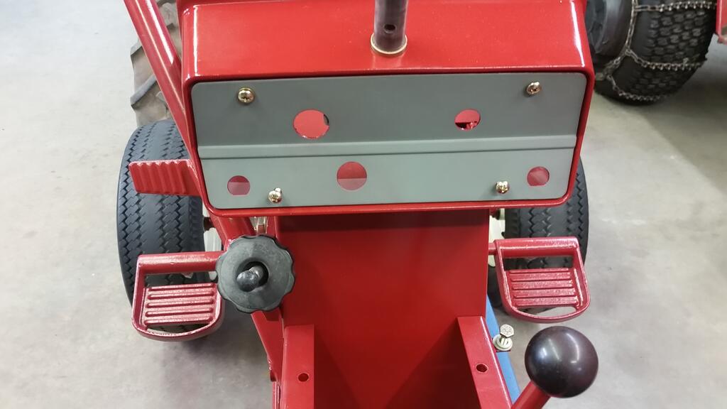

Achto 30,988 #9 Posted February 23, 2021 I used Duplicolor silver wheel paint, it's one of the few silvers from a spray can that can be cleared over and still look decent. https://shop.advanceautoparts.com/p/duplicolor-wheel-coating-silver-11-oz-aerosol-hwp101/7141149-p?store_code=5143&product_channel=local&adtype=pla&gclid=CjwKCAiAyc2BBhAaEiwA44-wW-Pb2CHdvWkTnMjwTq4iQqrj75wQ3W1t6AB91QvmhpzwNINIVKuw9RoCMj8QAvD_BwE&store=5143&gclsrc=aw.ds I clear coated it with Duplicolor wheel clear. https://shop.advanceautoparts.com/p/duplicolor-wheel-coating-clear-11-oz-aerosol-hwp103/7141208-p?store_code=5143&product_channel=local&adtype=pla&gclid=CjwKCAiAyc2BBhAaEiwA44-wW4B0GoYBXxeEeyOEDxlozu2Oog-R_P-HZQKDftjy2_XiKTSxcOogLxoCkSMQAvD_BwE&store=5143&gclsrc=aw.ds This pic shows the brushed effect a little better. 3 1 2 Share this post Link to post Share on other sites
