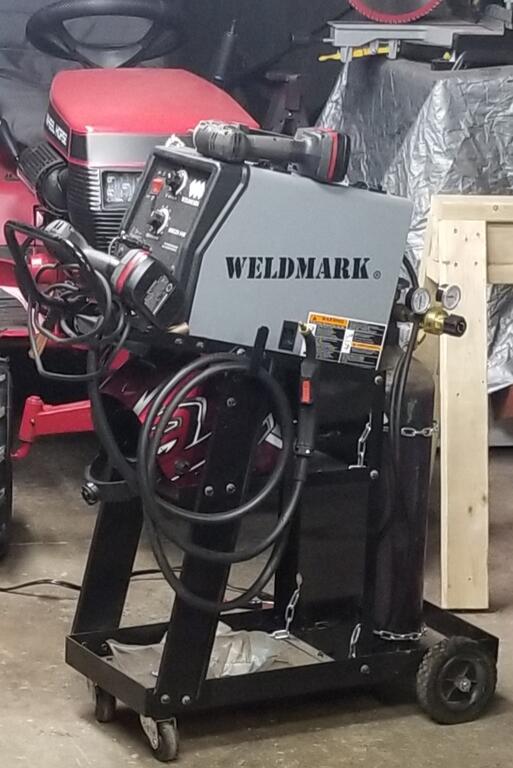

Gregor 4,847 #1 Posted February 21, 2021 I have a cheap Harbor Freight Mig welder. 220 Volt. It can be run with flux core wire, or solid wire and bottled gas. I have a bottle of 75 / 25 Argon/Co2. The bottle is probably almost 10 years old. For you guys with similar welders, do you use gas, or set your welder up for flux core wire? Also, would the bottle of gas still be good? Thanks Greg Share this post Link to post Share on other sites
