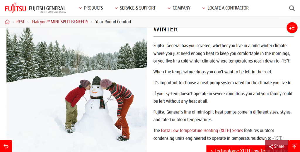

kwalshy 267 #16 Posted June 11 I've been looking at a mini-split, 2 zones. The Mitsubishi and Fujitsu products. Primary use will to provide AC and for moderate heating. My house's primary heat source is hot water baseboard and wood stove; I run the wood stove as much as possible, and the mini split will help in a room that is far away from the wood stove. I see this post is from a few years ago & I'm wondering if anyone has feedback on these newer units. Thanks Share this post Link to post Share on other sites

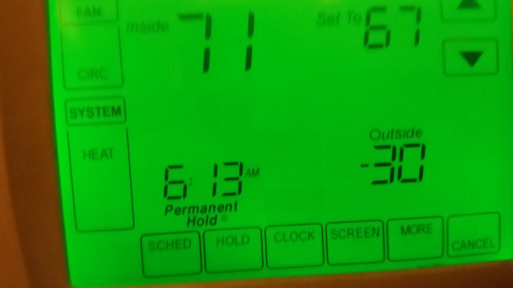

parsonsponyz 420 #17 Posted June 11 I am planning on using mini splits in my new garage. Originally was planning on traditional furnace with all the accessories. I talked to many people that have had them installed recently and they like them. I talked to an installer, the one that will be installing mine, and he initially said putting in a mini split will provide heat to around -20F and that the efficiency rating is affected using more electricity than under ideal conditions but it will still operate. I'll have about the same price as a traditional furnace with the added bonus of A/C, and on a day like today I don't regret my decision. 1 Share this post Link to post Share on other sites
