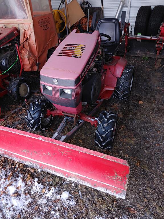

WVHillbilly520H 10,379 #27 Posted February 21, 2021 I think what most everybody wants from "reversing" front AGs is the lateral traction aid as to not "ski" forward as you are turning against an angled blade full of snow or against the windrow of said snow, @oldman if I am following you correctly you want to be able to "float" on the surface instead of your tires falling/digging through said snow causing you more steering effort? If I am wrong in my conclusions here I am sorry for leading you astray, now in my experiences with the AG tire you pictured above (OTR brand) which I do have on all 4 corners of both my 520Hs I have not needed (or wanted) to reverse the direction for added lateral traction (520s are notoriously light in the front) and having these tires (un weighted) I have found they are 100% better than unaided turf tires for steering over slick or uneven surfaces, if you notice the squared off side shoulder ends on the bars and the over lapping center 90° centers is where this particular tire shines of competive/standard AG design, but compared to your 18Auto the 520 has the gear reduction steering so my experience may differ greatly from yours or others. I also have 2 SCUT 4x4 tractors with R4 industrial tires even with the front axle engaged without use of the "steering" brakes (and chains) those tires are basically useless driving/steering through unplowed snow or sloppy mud. 2 Share this post Link to post Share on other sites

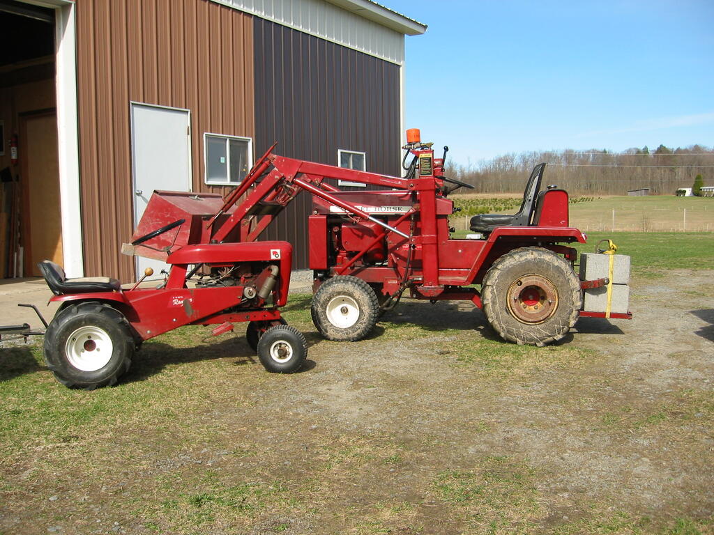

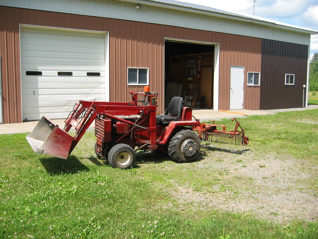

pfrederi 21,274 #43 Posted February 22, 2021 This is my D200 with FEL. Original size fronts (which incidentally are the same size as my L-107 rears.) I use her to load move and spread 2a stone. I do not use her in snow and common sense says keep out of soft ground with her weight and 250 lbs in the bucket you are asking for trouble. But I can drive around on reasonably firm turf no issues except you have to be moving to steer. What are you trying to accomplish?? Bigger foot print less sinking but it will be harder to steer. You are not going to have a swamp buggy with a D200..stay out of the mud.... 1 2 Share this post Link to post Share on other sites
"Manic-Mechanic" 1,486 #44 Posted February 22, 2021 (edited) Thank you for sharing, that's a wonderful tractor. I am seeing this remains as a practical, common sense thing, not made for the mud at all. Let this whole concept evaporate! Leave things be as is and appreciate the pro's of the machine! May just hold off on changing the front tires, they are really good 6 ply tires. Edited February 22, 2021 by oldman Share this post Link to post Share on other sites
