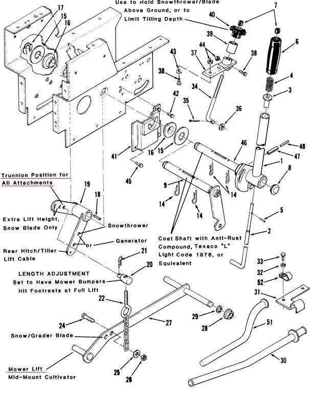

steader 26 #1 Posted February 19, 2021 Just got a b 100 and need to plow a field. What do I need? Share this post Link to post Share on other sites

953 nut 64,332 #5 Posted February 19, 2021 8 hours ago, steader said: need to plow a field. What do I need? Probably need to let the ground thaw out first. Seriously, there needs to be a rear hitch capable of attaching and lifting a plow. There should be a cable from the lift lever rocker shaft (part 19) going back to the lift. Lowell https://wheelhorsepartsandmore.com/ can fix you up with a cable if you need one and Lincoln https://a-ztractor.com/ can help with a hitch and plow. Also you may want tp place an ad here for what you need. https://www.wheelhorseforum.com/classifieds/wanted/?do=form&d=2 Share this post Link to post Share on other sites
Achto 31,133 #6 Posted February 19, 2021 You will need a plow, a slot hitch with a Brinly adapter, or a Brinly hitch, the cable for the slot hitch, and weight. This would allow you to run a Brinly plow. If you happen to have a plow you will need the slot hitch, the cable for the slot hitch, and weight. 1 1 Share this post Link to post Share on other sites

oliver2-44 11,272 #8 Posted February 19, 2021 Check that your tractor has the arm on the arm on the Rockshaft for the Rear Hitch (#19 in diagram posted above) Seems I've read some of the later B series did not have it. Share this post Link to post Share on other sites
